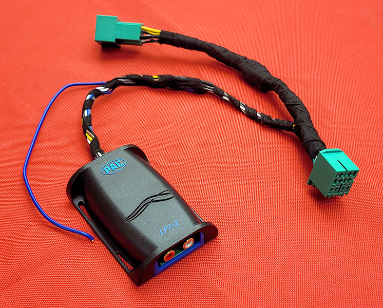

Stealthbox purchased with dual 10s. JL RD1000 amp, PAC APSUB-CH42 AmpPRO SUB, Axxess ANC-CHH2 ANC Bypass Harness
Am I to understand that with this, I should be unhooking the factory sub or leave it plugged and adjust the bass level within the stereo and use the amp powering the stealthbox to increase the bass lost by turning it down in the stereo?
Should I try with and without the ANC bypass harness? Seems pretty easy to plug and unplug.
