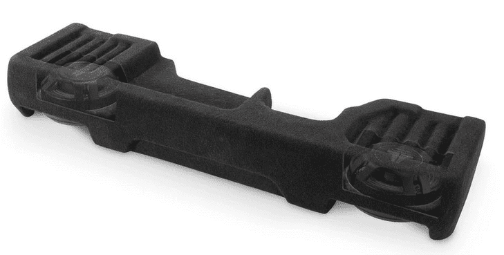

JL Audio Stealthbox
32859
32860

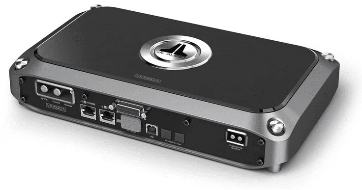

JL Audio VX1000/1i Amp
32861

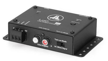

JL Audio LoC-22 Integration Mudule
32862

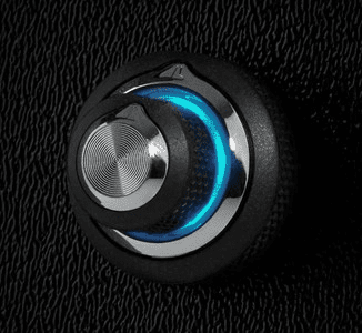

JL Audio DRC-205 Control Knob
32863

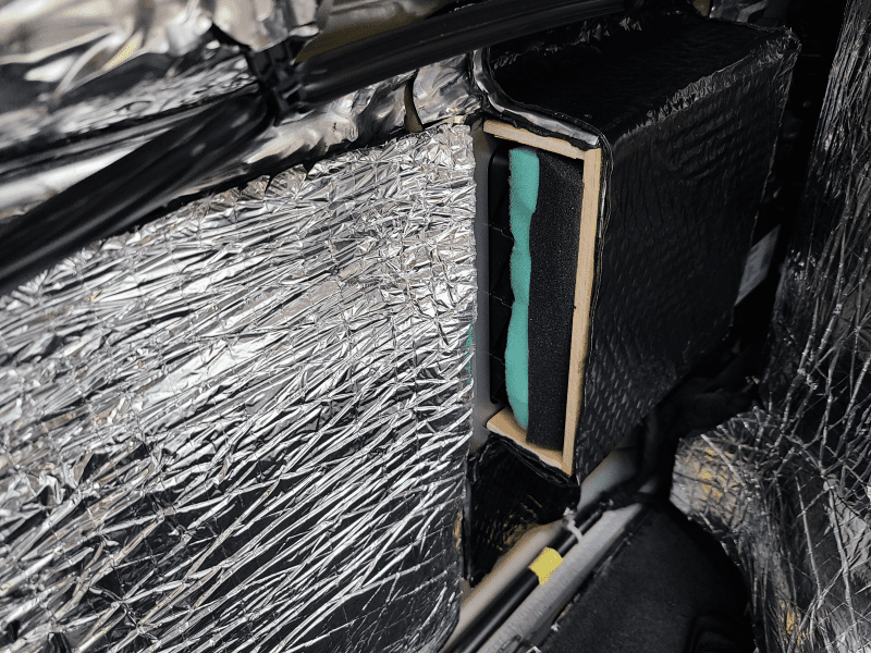

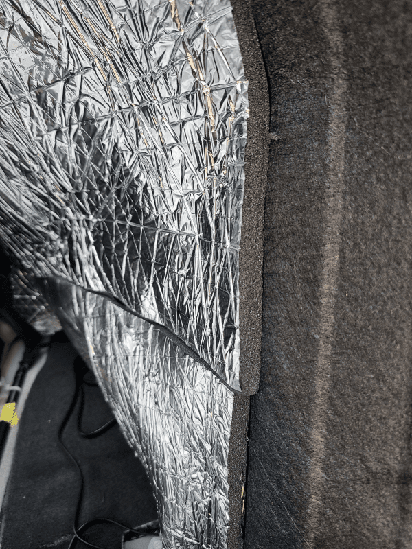

Here you can see the rear vent boxes I fabricated, and some of the dampening material... and the 1/2" thick closed cell foam that I lined the back wall and the back of the rear wall panel with. I believe this helps the overall system sound by eliminating exterior noise, by dampening panels that can create noise from being vibrated, and by padding various items in the truck from vibrating due to bass. The green foam is the open cell filter, similar to what you would use on an air filter for a lawn mower, etc. The black foam is closed cell foam used in acoustic treatment.
32865
32866

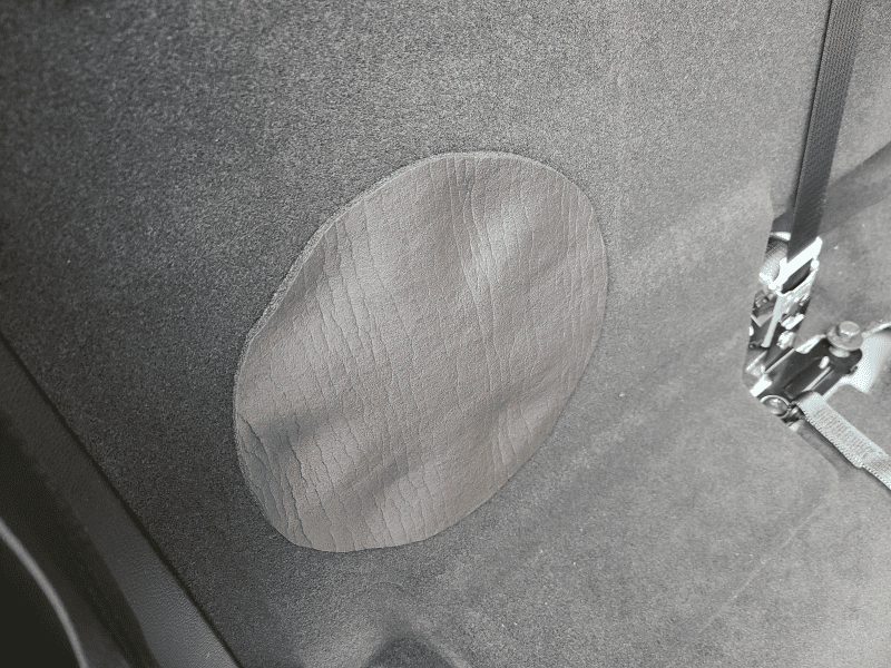

I covered the opening where the factory subwoofer was located... added extra closed cell foam in that area behind the panel as well. Basically just trying to prevent any noise from coming thru that opening.
32867

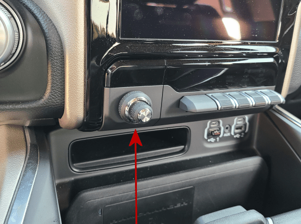

I have already installed the DRC-205 control knob... and this required using my Dremel tool to cut out some plastic behind the panel, as this knob box requires a 1 inch square area behind the panel. I tried to find a suitable location and looked all over the place... this just seems to be the right spot since there was a blank panel space there just begging for something to go there.
32868
