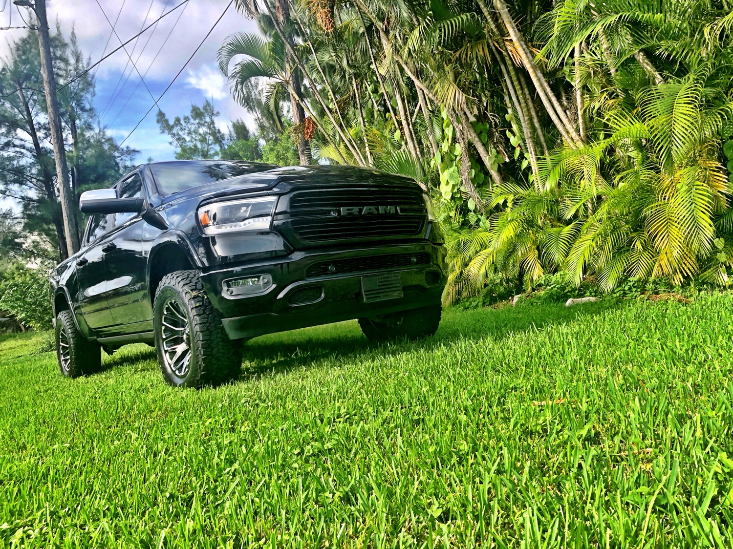

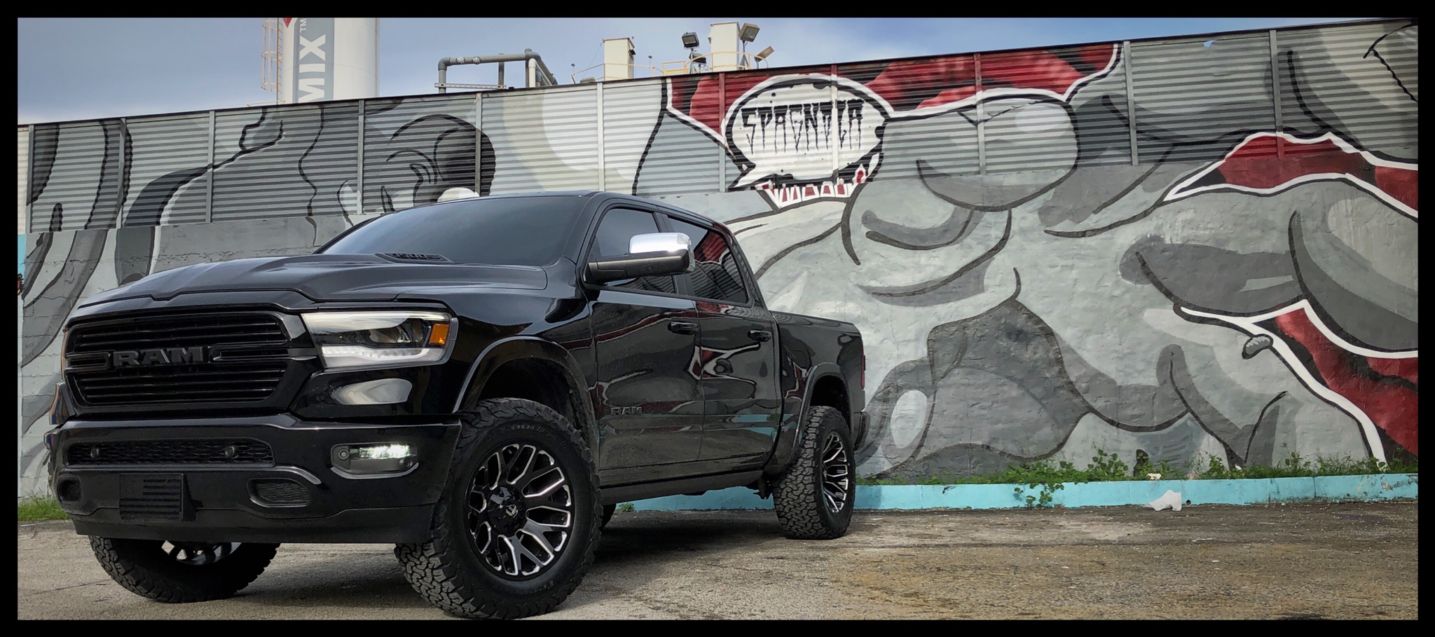

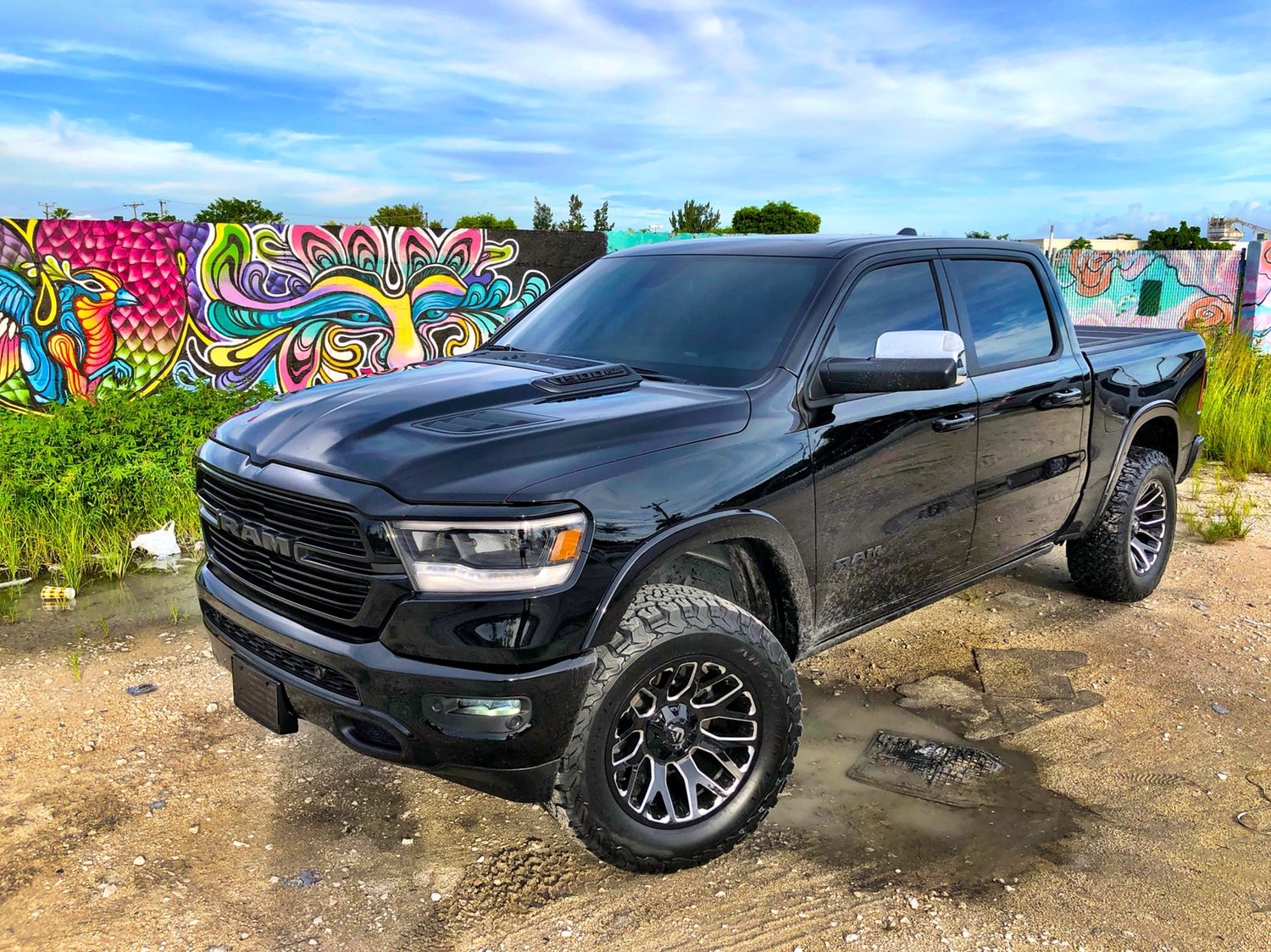

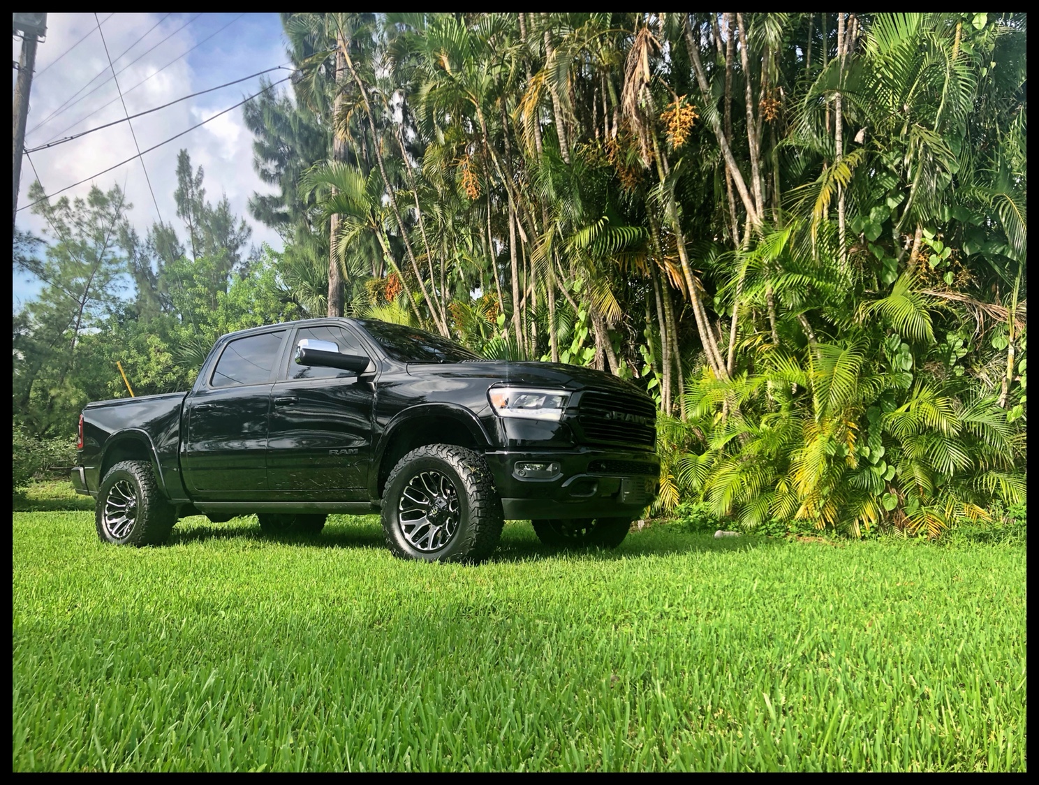

The problem is that some people don't mention the width of their wheel - that they for instance have a 10" wheel instead of for a 9" that is original on mine - a 22x9 with an offset of +19. I am moving to a 20" so I made sure I had the same width - a 9" and then an offset as close to the original as possible. I ended up with a +15 (mm) as that was the closest I could get on that wheel. However - if I had gone with a 1 offset wheel then it would have been sitting 14mm farther out and If I went with a -18 offset - well then it would have been sitting 36mm further out than original and then you see that you probably are in trouble if wanting it inside. Of course the width of the tire you mount also plays in here. But, if you stick to a 285/65-20 well then you have what is similar to a 34,6" tire with a width of app 11,2"
