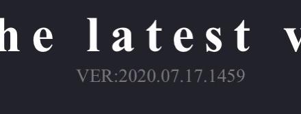

Anyone know if there are release notes when version updates become available? I was on the latest version earlier this month after receiving my dongle. Now a new update took place (7/17) but curious as to what is fixed or added.
I know they told me that they are constantly updating the hardware to work with more and more vehicles. I am unaware of them posting anything that states exactly what an update does or fixes. I'll reach out to my contacts and see if I can get release notes.
I just ran out and completed my upgrade...only took a few minutes and all appears to be fine.
