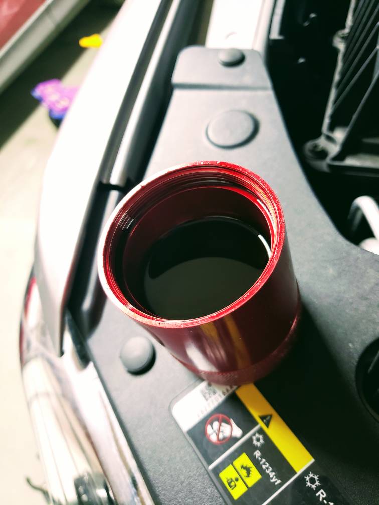

Here's a catch can dump after the first 5000 miles. About the same as every other 5.7 I've owned.
Looking at this I am now very interested in installing a catch can. I am guessing that burning all of the oil in the combustion chamber is not good for your spark plugs or the top of the piston chamber. Which brand is this one? I found the Mishimoto that is black for $183 on Amazon and wondered if this one is cheaper?
This is the Billet Technologies catch can. I've had it for years on multiple vehicles.
