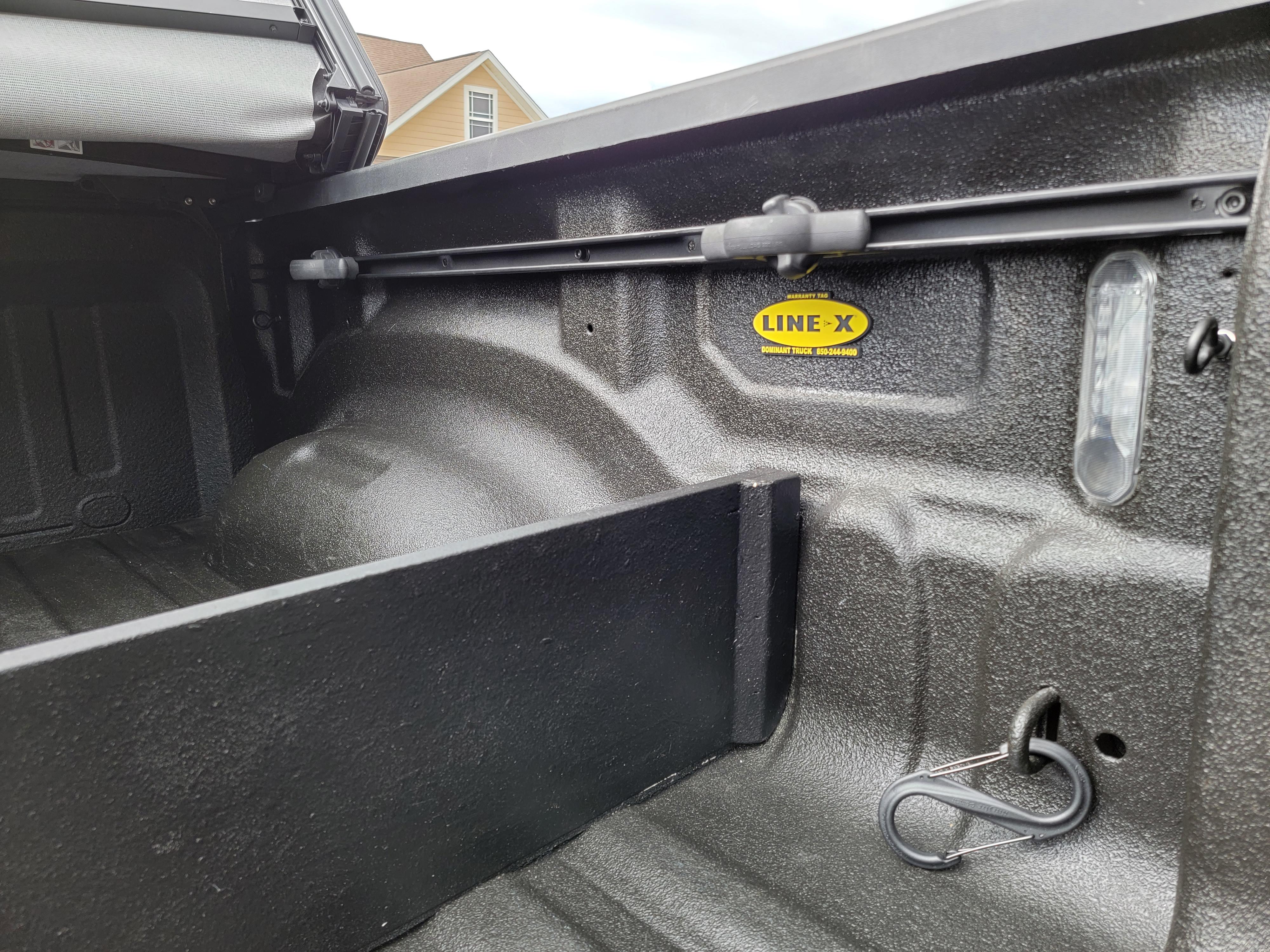

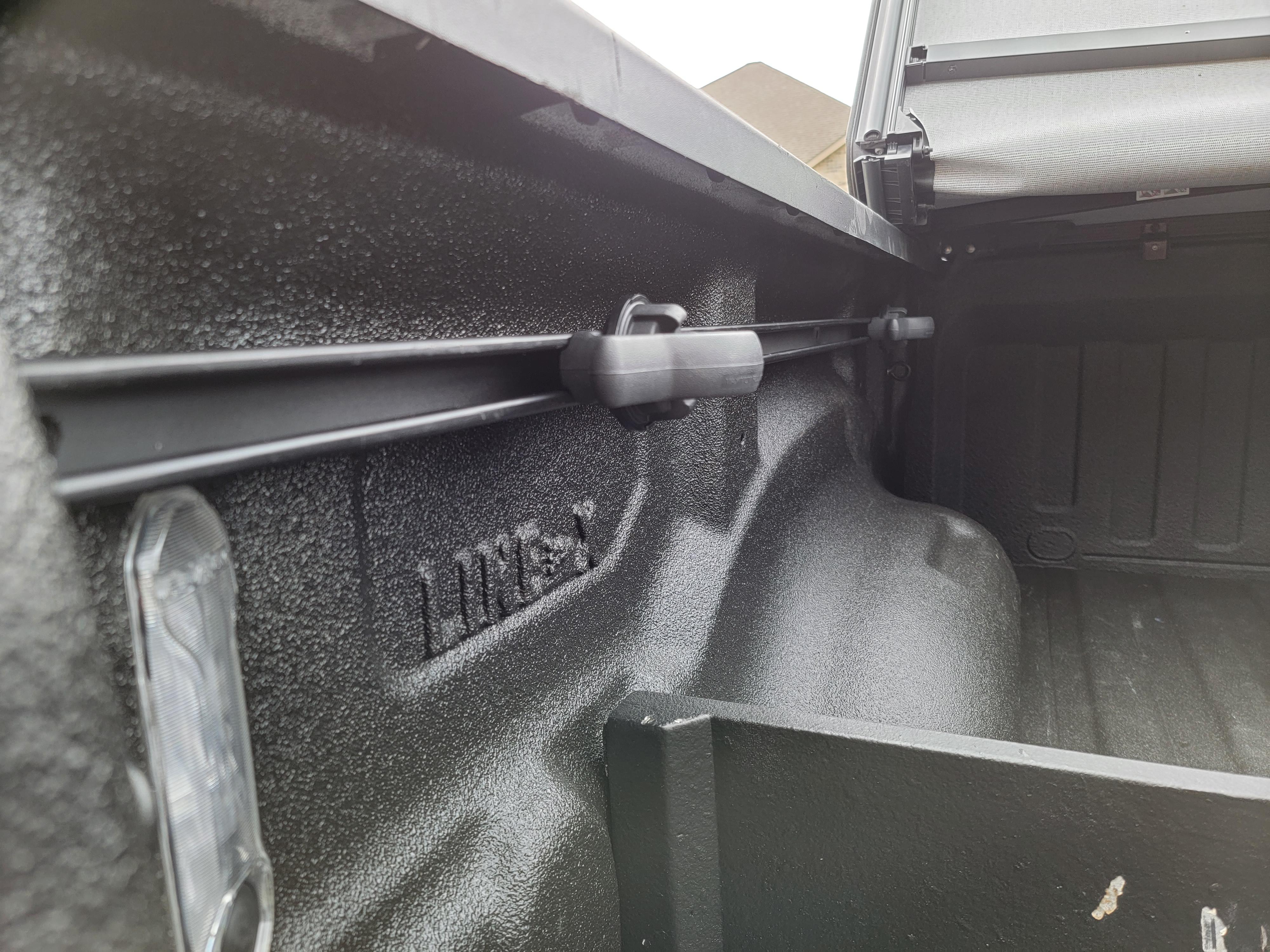

Scored a cargo rail set with cleats off a Tundra for 30 bucks on FB Marketplace. Had to trim a few inches off and drill some new holes, but it's on there and looks like it was meant to be.

What are the dimensions of the board you made? Looking to do something similar.
Believe it was 67" wide.
1x10, doubled at the end. A any 2" board will would work also, but you'd loose 3/4 of an inch and gain twice the weight.
Also, if you use bedliner spray, prime the wood first and do light coats to build it up. It doesn't stick to bare wood very well. I'm thinking of redoing it with pvc board or pvc pipe, coated to look like a bed separator, but lighter and easier to remove.
There the same type that ram uses cause I’ve used some of the toyota accessories for them. Looks good! Like factory.
