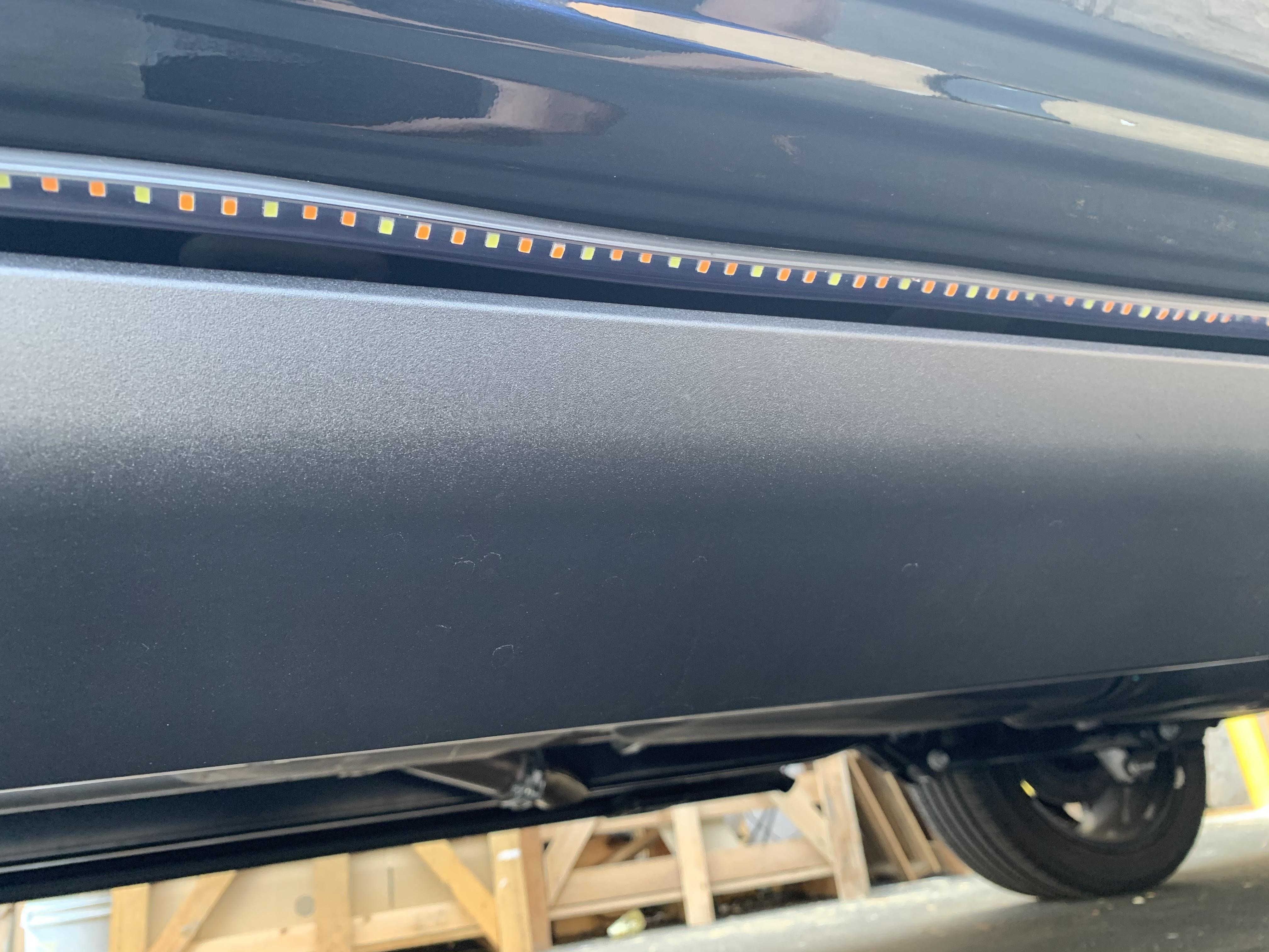

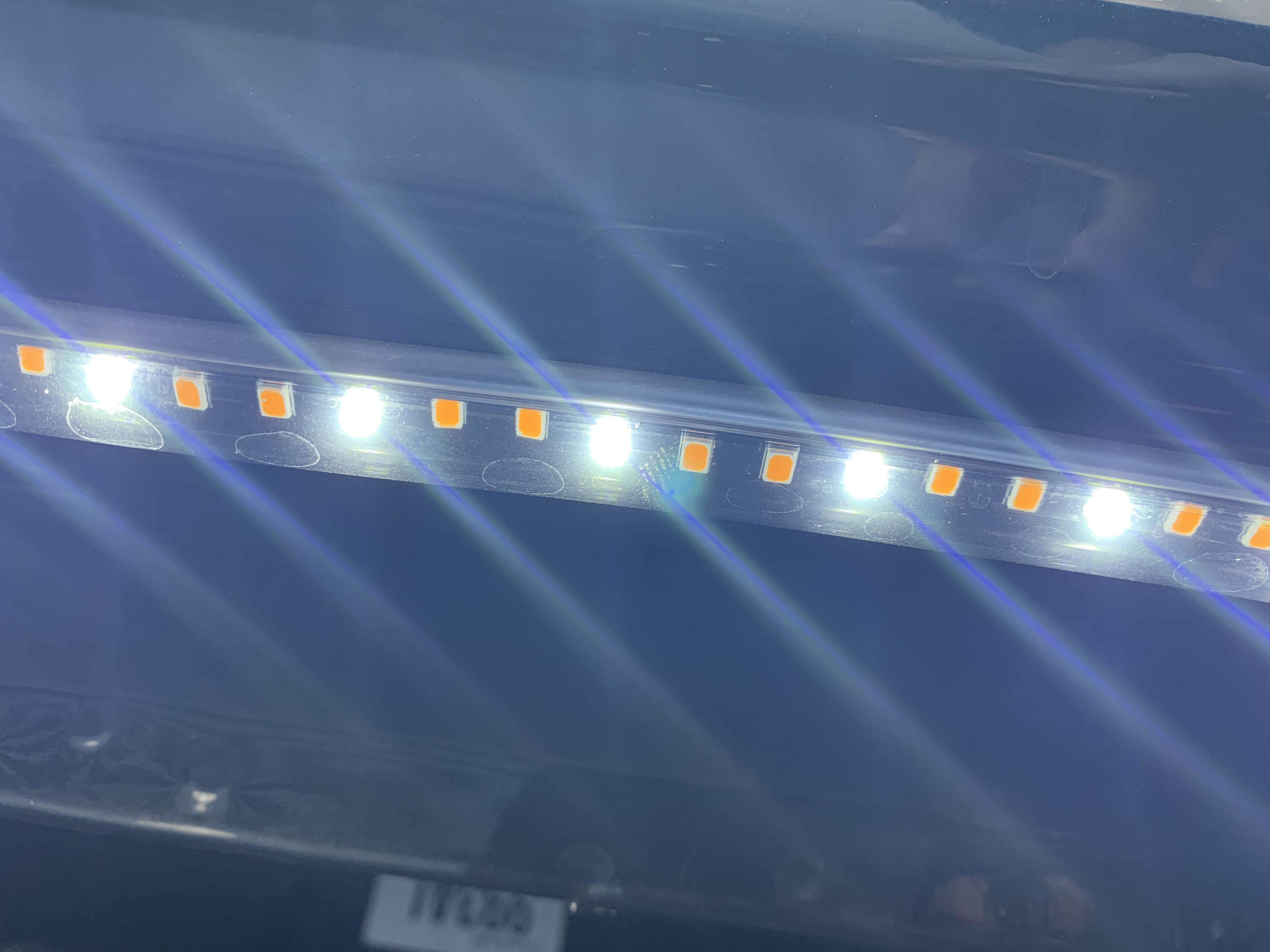

Thanks for the quick response. So, the "courtesy" lights are just the sequential lights when not being used as a turn signal? So, in order for the signal to function properly the courtesy lights have to be on the entire time the truck is on...day or night?
Sorry. I miss read your question. No. The LEDs are different. The strips have two sets of LEDs in them. There are white LEDs and there Amber in LEDS. The courtesy lights are the white LEDs and the turn signal and brake lights are the amber LEDS. If you look at your strip you will see the LEDs are different colors I believe there 2 Amber LEDs to every 1 white LED. I will attach a picture of the strip not lit up and lit up so you can see what I’m talking about
Yes that is correct. You will see by the two videos I posted. When the door is open and the white courtesy lights are turned on, the sequential turn signal operates smoothly. On the other video when the door is closed and the white lights are turned off the sequential turn signals do not operate properly. I tried different wiring configurations and the only other option I came up with is if you hook up the white wire to your running lights. The white lights will come on with your headlights and stay on and then the sequentials will operate properly. But I did not want to drive with my white Running board lights on. So I just live with the running sequential lights not operating properly. One more thing is the amber
Running board lights will come on when you apply the brakes
So, according to their site it should be a constant amber, with white lights at unlock and when door is open, then sequential when signal is used. Do you have yours wired to have the amber on all the time? I probably won't be installing mine for a little while since it's 100+ in Texas right now and that doesn't even sound like a fun project to tackle in the heat.
The sequential lights require the white wire which is the white courtesy lights to have power in order for the sequential function to operate smoothly. See video attached with the door open when the white courtesy lights ( white wire ) have power to them.
When the door is closed and there is no power to the courtesy lights ( white wire ) the sequential lights don’t function properly. See video attached
I don’t want to drive with my white courtesy lights on all the time so I just live with the sequential not working properly
You said you have the curt adapter for your rear lightbar. What if you spliced in the turn signal wire from the curt adapter along with the signal you are getting from the bed cargo light? The bed cargo light would control the open and close and then the turn signal from the curt adapter would control the sequential.
Great minds think a like. That’s the first thing I thought also. You would think that would make sense and work. I already tried it and it does not work. I tried all kinds of configurations testing all kinds of wires connected everywhere and I could not come up with any solution with this light bar.
I wired mine so only the white light turns on when door is open or key fob is pressed. Amber only lights up when turn signal and brake is applied.
From the light bar I wired the white wire to the bed light. The Black ground wire which has the fuse in it to the white ground wire of the Curtis adapter. The yellow wire to the yellow wire of the Curtis adapter for a left turn signal ( Driver side ). The yellow wire to the green wire of the Curtis adapter for the right turn signal ( passenger side ). I did not connect the red wire to anything.
Crap, I thought we had it. Seems like that would work.
