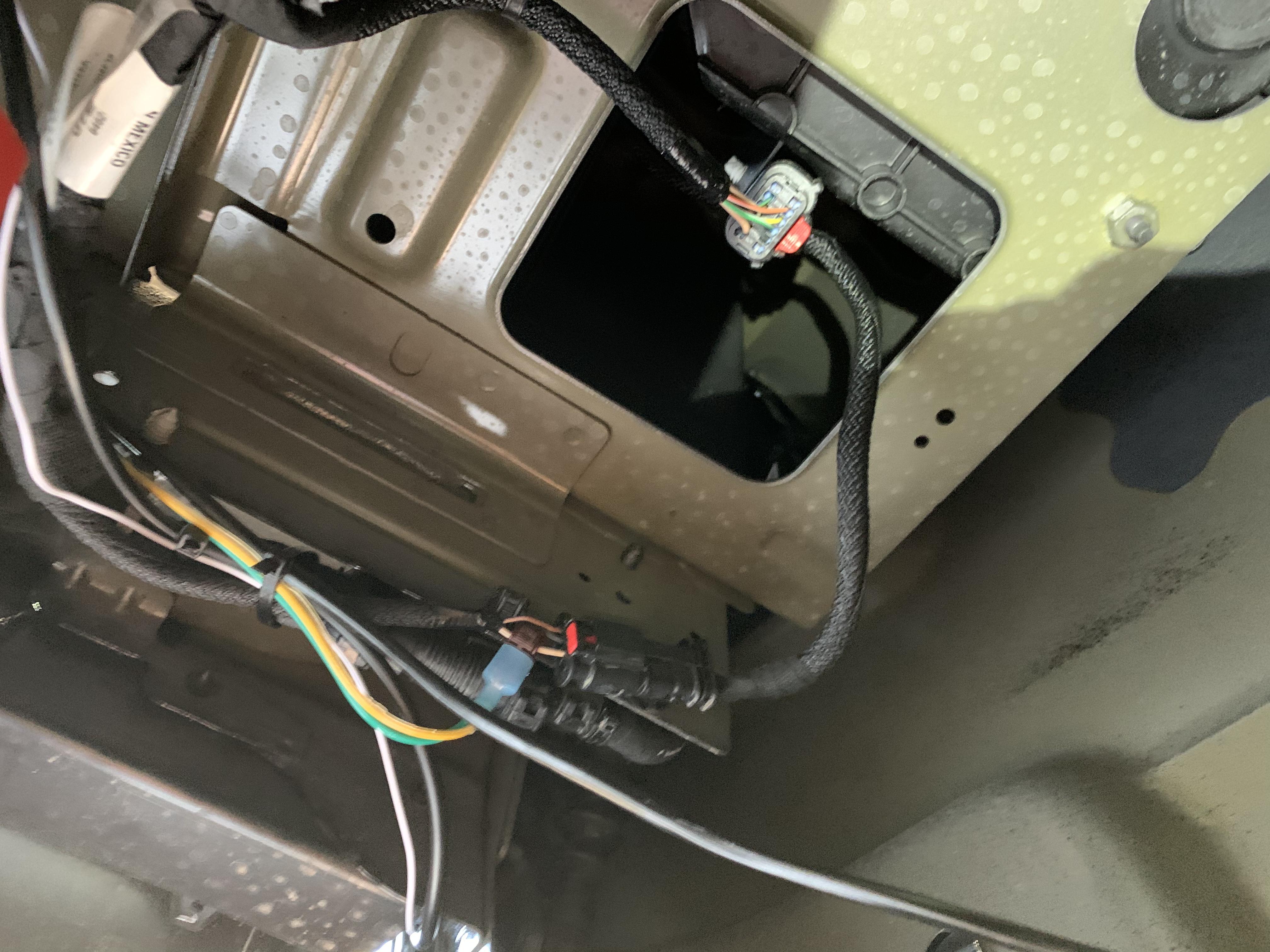

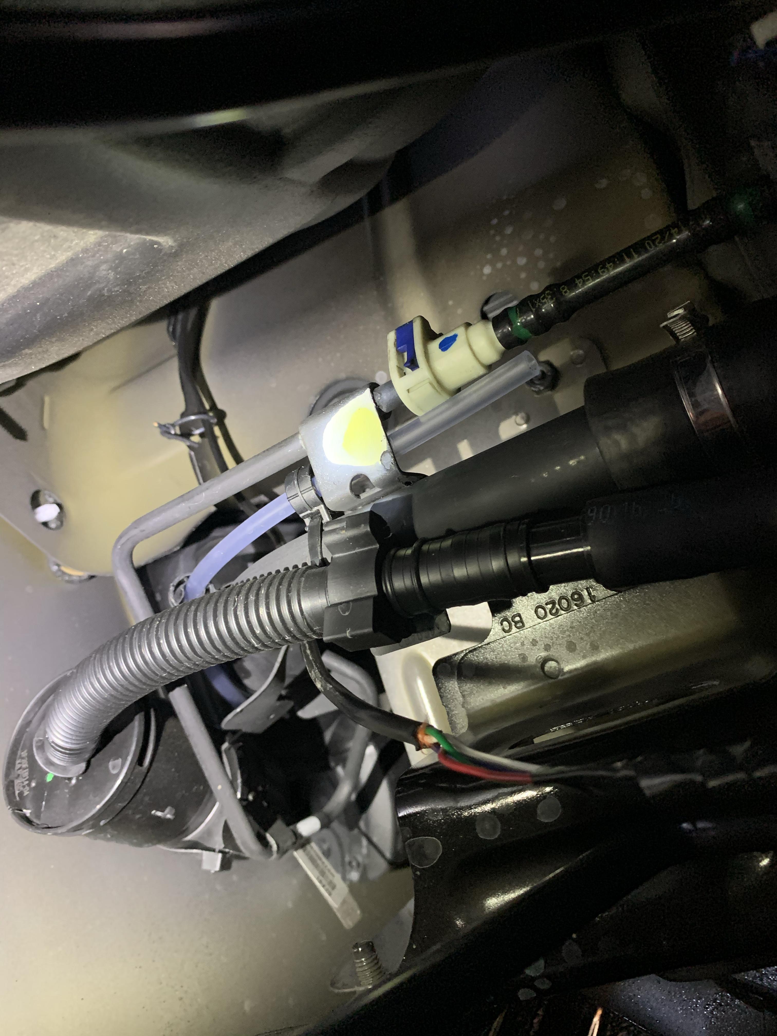

I used a 18 gauge 4 wire sprinkler cable to run the lights to the back. See photo attached
![a5e9accf72ff8fa64ff6512f60baea64.jpg](/community/proxy.php?image=https%3A%2F%2Fuploads.tapatalk-cdn.com%2F20200803%2Fa5e9accf72ff8fa64ff6512f60baea64.jpg&hash=b2f064186312f62503c022a8fe040603)

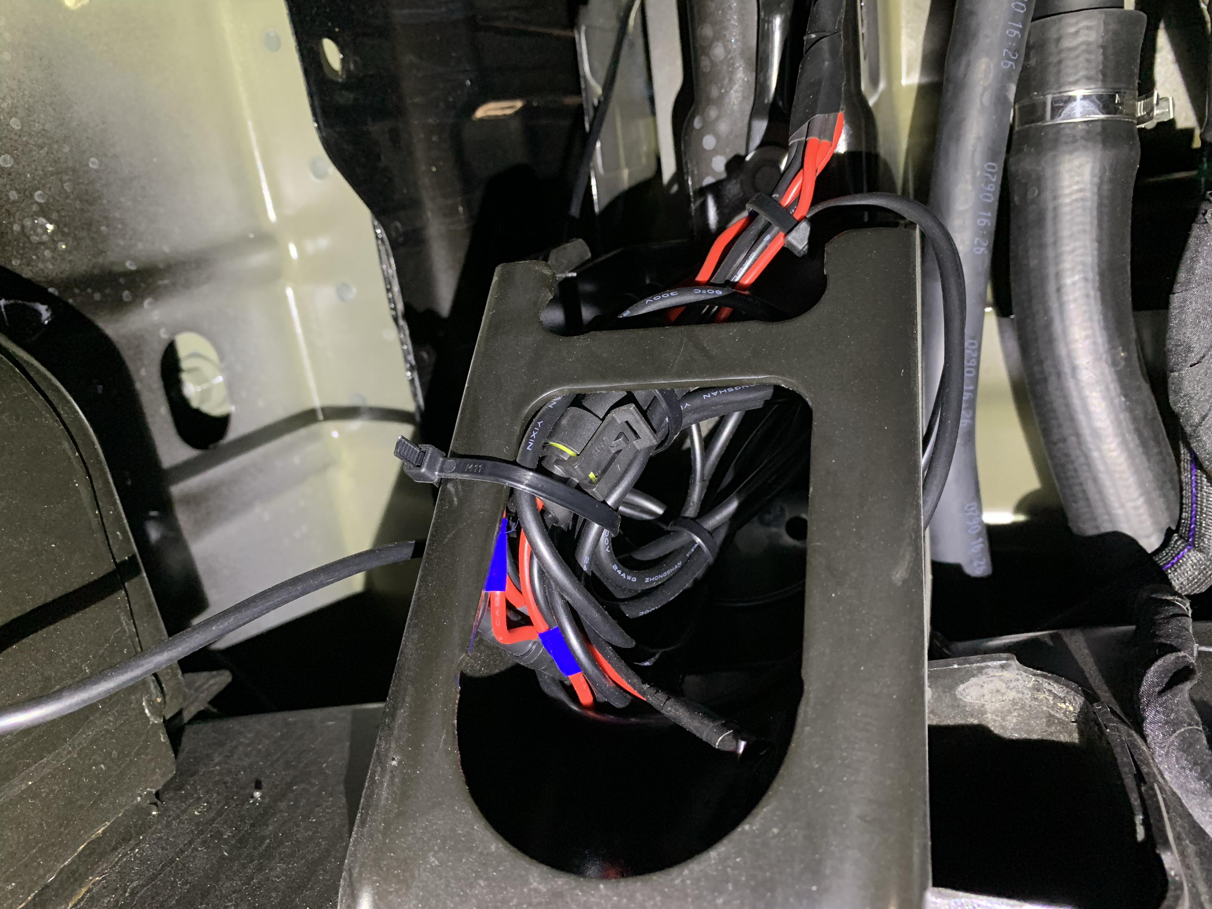

On the four 4 wire sprinkler cable. I used the white wire for ground, the blue wire for the white wire courtesy light from the running board, and the green wire for the sequential turn signal. I did not use the red wire. I left it there for any future running lights. I soldered and heat shrinked waterproof connectors on the ends of the four wire harness. I put the opposite side of the waterproof connectors on the running board wires. That way if the running board strip burned out it would be an easy switch. Just unplug the The connector and switch out the strip without having to re-run all the wire back to the rear of the truck. I connected everything where the bed and the cab meet.
![2b1ffe2b09f6f3ef083bebbd3e3e66f1.jpg](/community/proxy.php?image=https%3A%2F%2Fuploads.tapatalk-cdn.com%2F20200803%2F2b1ffe2b09f6f3ef083bebbd3e3e66f1.jpg&hash=0f6610cfeab8f5416b0509aec29e46c8)

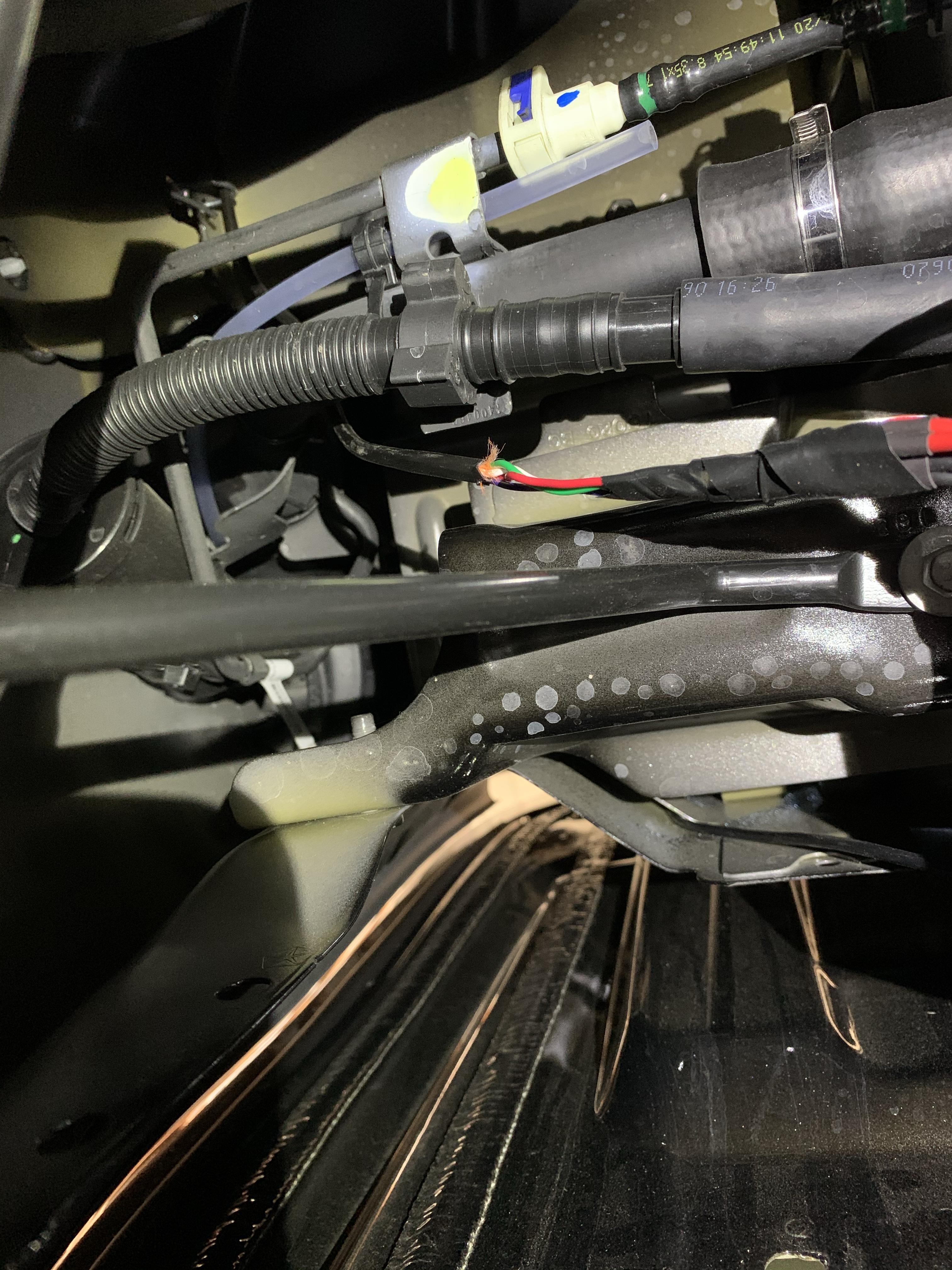

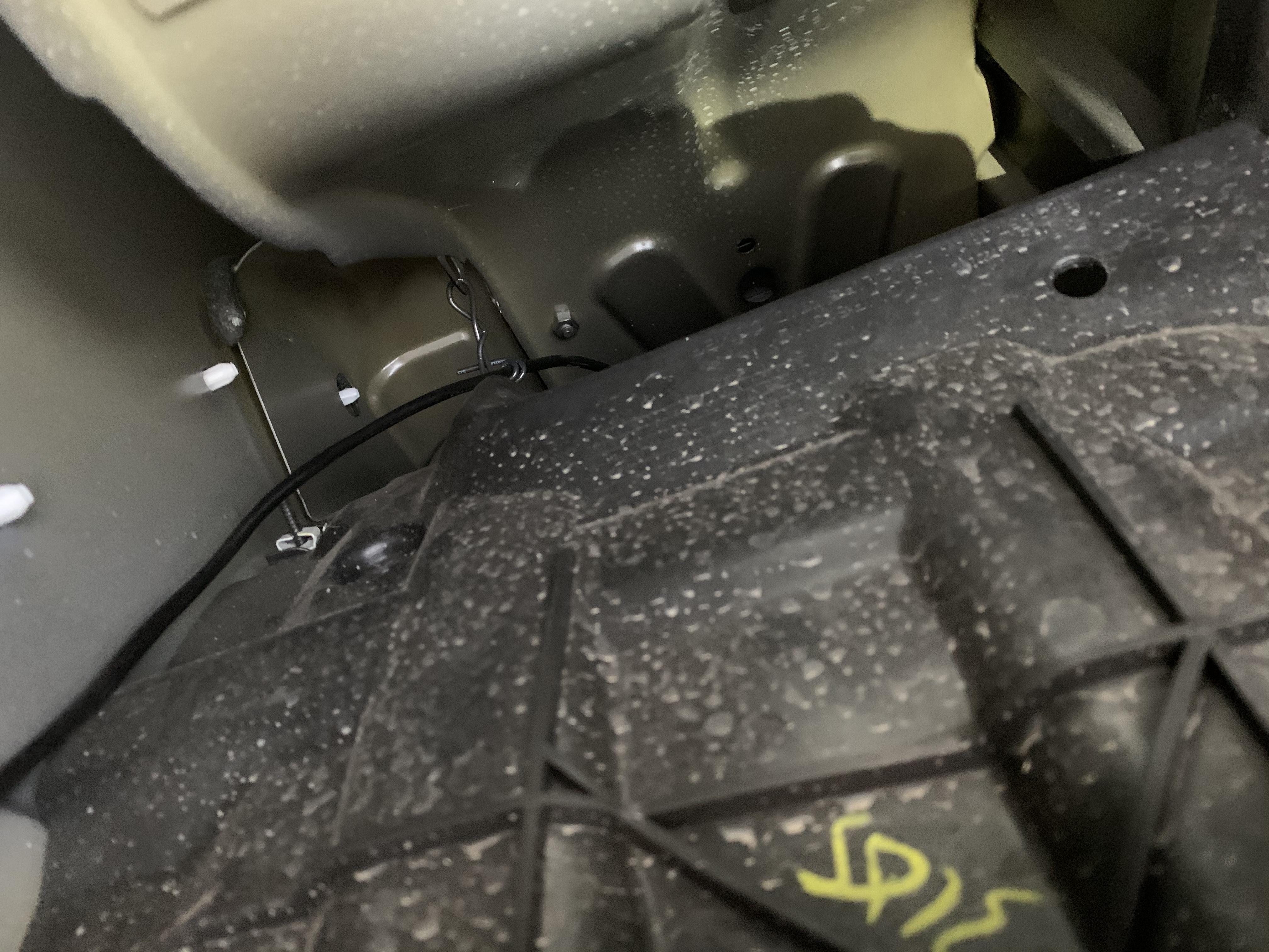

I ran the four wire sprinkler cable up and over the rear wheel Liners. There’s a small ring just before and after at the top of the wheel liners that I used to attach the wires to.
![6ed58f2f31f7de4d9d16de42f34ef819.jpg](/community/proxy.php?image=https%3A%2F%2Fuploads.tapatalk-cdn.com%2F20200803%2F6ed58f2f31f7de4d9d16de42f34ef819.jpg&hash=1b5ade8d42114eb63ca03224ed13b0aa)

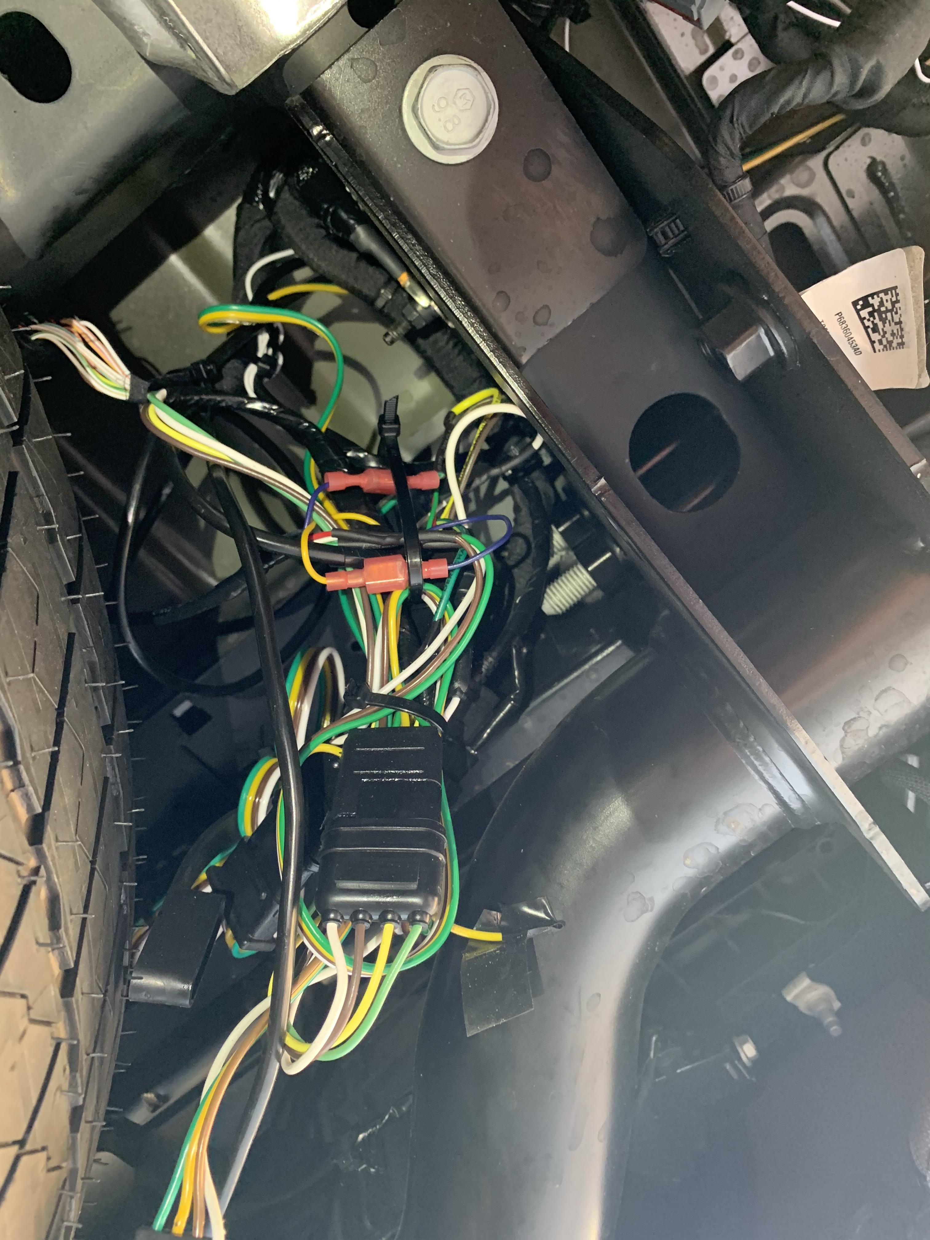

I attached a trailer plug on the other end of the four wire sprinkler cable ( I attached the green wire from the sprinkler cable to the yellow wire of the trailer plug which is the left turn signal and then attach the green wire from the sprinkler cable to the green wire of the trailer plug for the passenger side which is the right turn signal. I attached the white wire to the ground of the trailer plug. ) I then plugged it into the Curtis wiring harness at the back of the truck. I tapped the blue wire from the sprinkler wire into the bed light plug.
