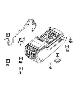

If port 3 behind the center console works for CarPlay but the 4 ports beneath the radio do not work for CarPlay, should I just be able to replace the media hub?
