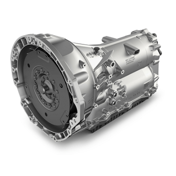

Their tune allows for full manual control of the transmission with the paddles or your regular +/- selectors. Same 8HP75 trans in both the diesel and hemi. Not sure how the mods feel about a direct link to a non-sponser so they may pull this down. I'm not sponsored, and bought everything with my own cash. Been running their stuff for a couple of years and they've been around for many more. I have to assume their flash/tool includes a modified firmware, as I've played around with some of it in hptuners and there are some variables I can't access. Meaning, that even when running a compare file I can't reproduce what they have on their tool without issues. They've created a very comprehensive and complete file that really does a great job of optimizing my setup.
I went up to their shop in Detroit for my engine and trans tune on their dyno, as have many others on the diesel side, and they are top-notch. They have done a ton of work for the big guys up there. If they gave that level of detailed work to the hemi, which given their reputation I would expect, then I'm sure it's the same.
Also, if you're considering it, reach out to them via email or phone. They will give you a full breakdown of the changes they make to the transmission. For example, on the diesel side, we get:
