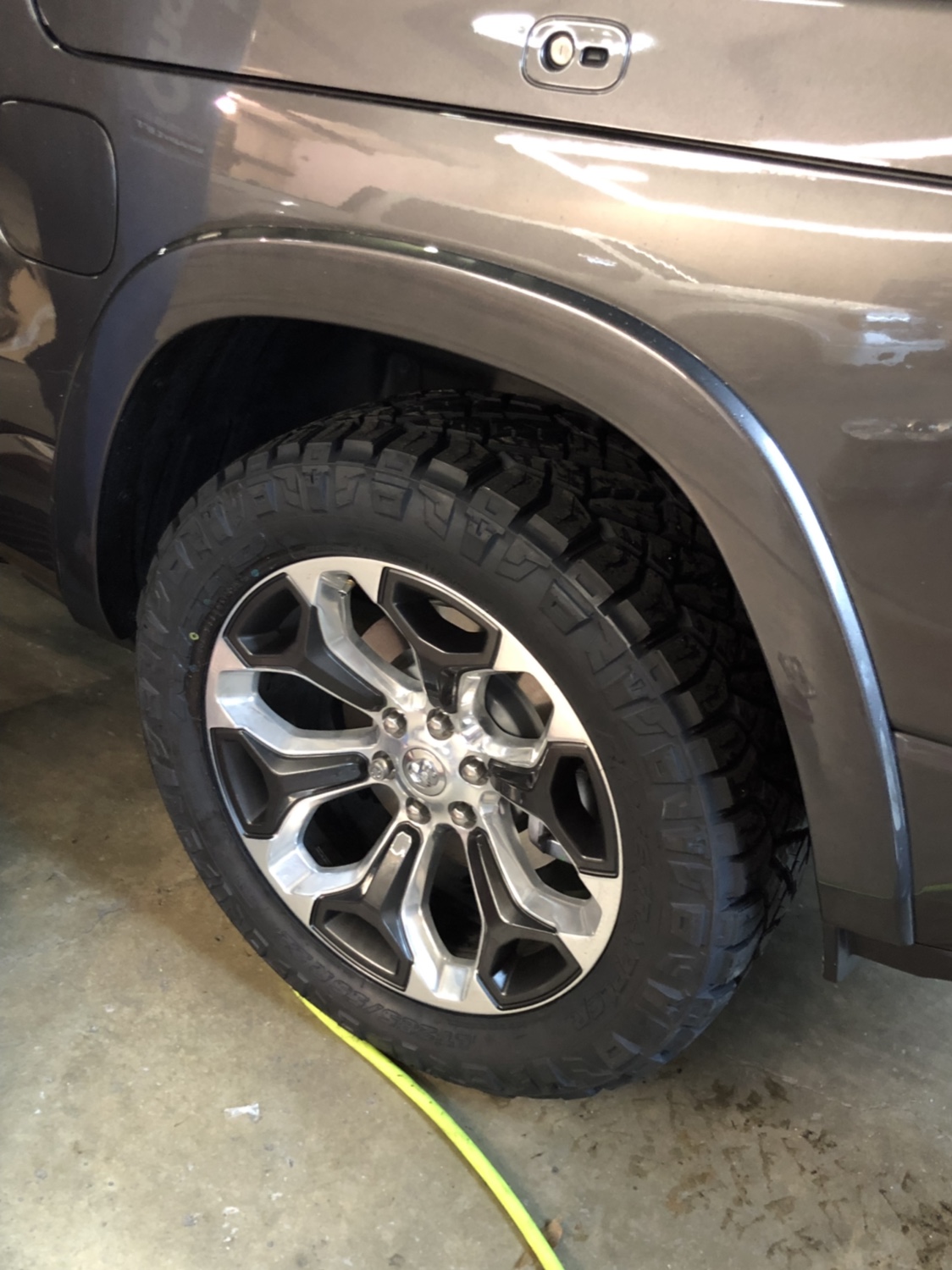

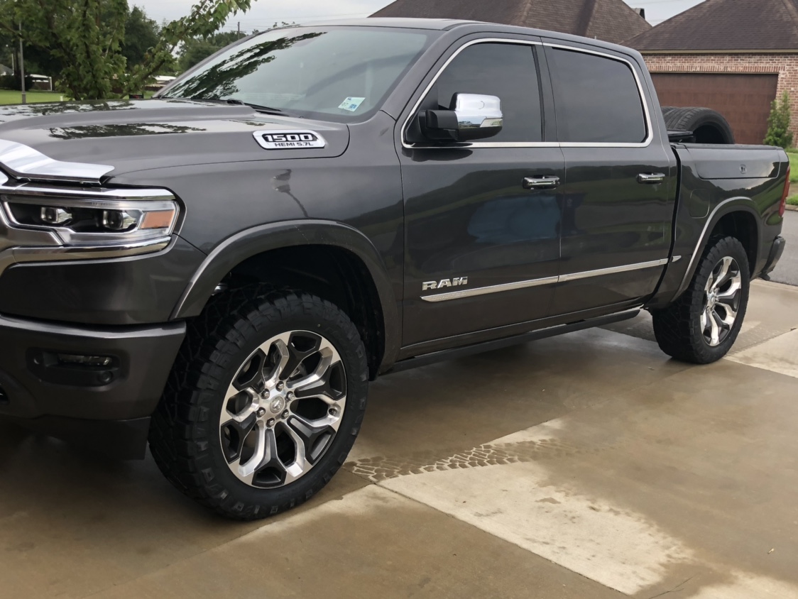

Had the nitro RG 285/55r22s put on today. Not the best lighting in some, but I'll get better pics tomorrow. Limited 4x4, no ORP, front lifted ~1.5in with Daystar spacers and revel links.
Ive drove on em about 10 miles at Normal height so far, haven't heard anything rub.
I was concerned about noise getting a 10ply hybrid, but these things are super quiet. Ride so far is different but great, feels planted, minimal additional little bumps.

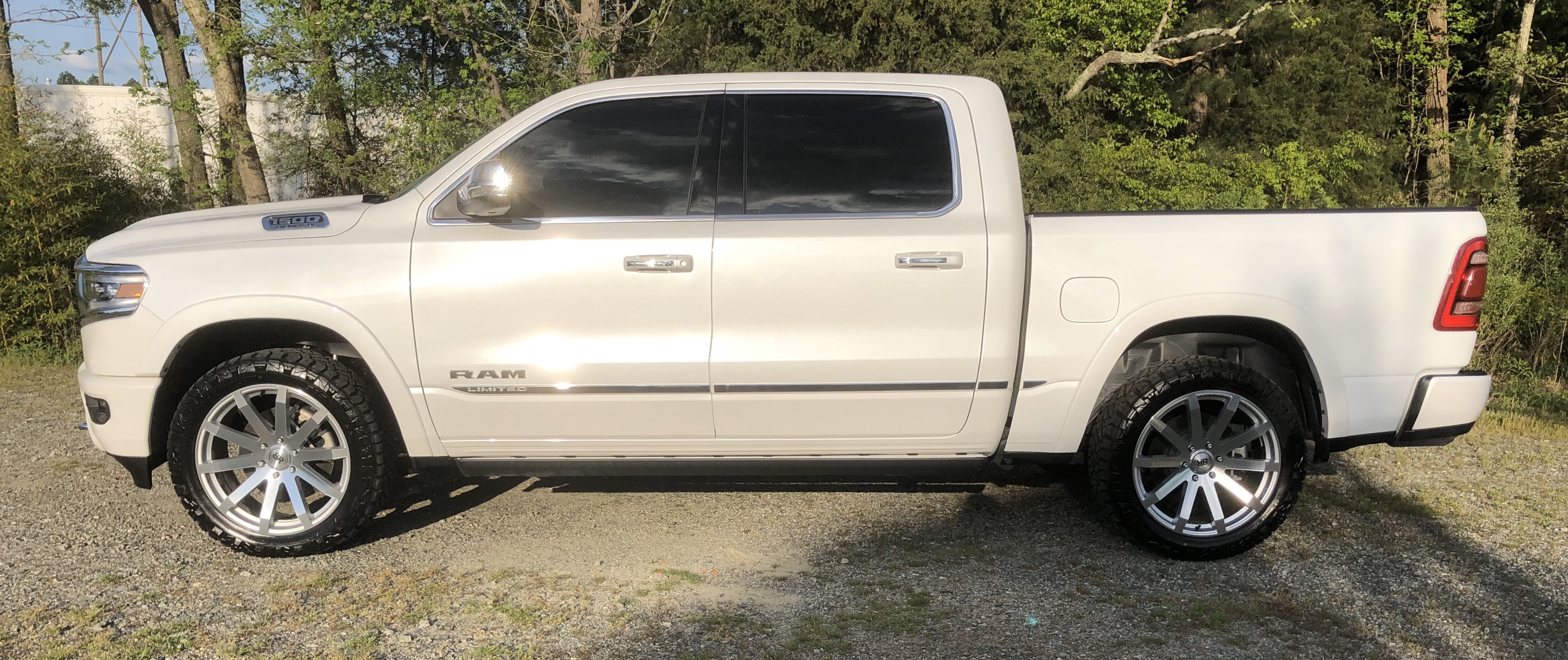

I struggled with 33" vs 35" tires for a while. In the end, the weight of a 2
2" LT tire the would kill bottom power even with 3:92, Borla S-Type, aFe Stage 2 Magnum and Pulsar and a harsh ride ride in such an amazing new Luxury truck(Limited with/air suspension) that rides better than any Luxury SUV and super quiet. It's simply wasn't worth the cons. I bought this truck to be amazingly comfortable, quiet and great ride. I went with 22X9.5 25 offset and Nitto Ridge Grapplers 305/45 22=33X12.5 and it ride better than stock 22's, looks amazing, handles amazing, no rubbing, lighter than stock so power is awesome and is City MPG. I am more than happy. The 33's on a good looking wheel look plenty big enough. For a lifted truck, yeah 35's or 37's but for stock suspension the 33's are ideal. I've said it before, I get more compliments on this truck then anything I've owned and people always mention the wheels and tires. I'll be staying with size wheel and tire combo for future trucks down the road unless the fender Wells grow to a size that require a larger tire with stock air suspension.

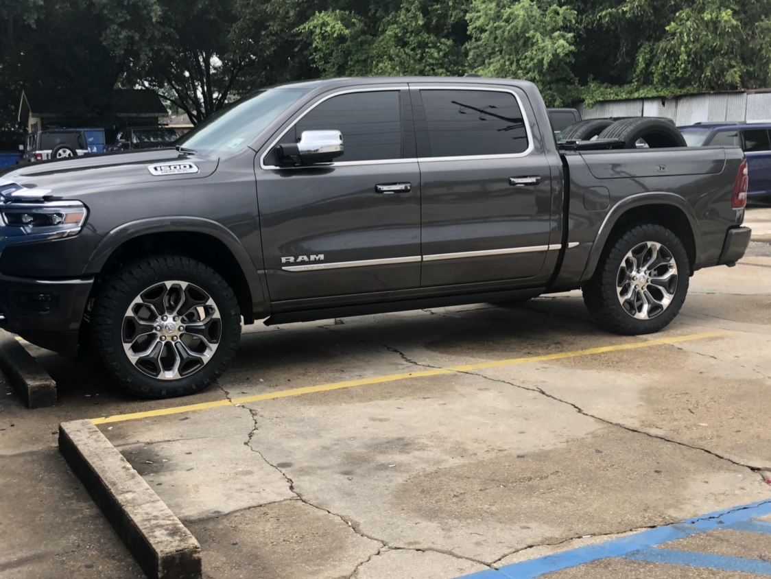

I was able to get some pics today after calibrating my speedometer with the Rough Country calibrator. This has been a process but thanks to all on the forum who have posted their trial and errors. Without this info sharing, I would still be sitting stock and thinking about a work around.
I started off by ordering the Revel Performance Leveling Links. After tweaking them, I was able to get a significant amount of front lift but immediately threw a Suspension error message. Dialed the links down a bit and got the error to go away.
Unfortunately this compromised the ride quality more than I was willing to accept. Decided to go ahead and get the new rubber anyhow and eventually decided on the Nitto Ridge Grapplers in 35x11.50x20. This alone added an immediate upgraded look to the truck and somewhat brought back the ride quality.
Yesteday, I finally had my local offroad shop install the Daystar polyurethane leveling kit that is suggested for a 2018 non air suspension Ram. This took quite a while since they had never ventured down this rabbit hole. Well, I'm here to say it was worth the wait. The ride quality is as soft as the day I took delivery. Here are the updated pics in all modes.
