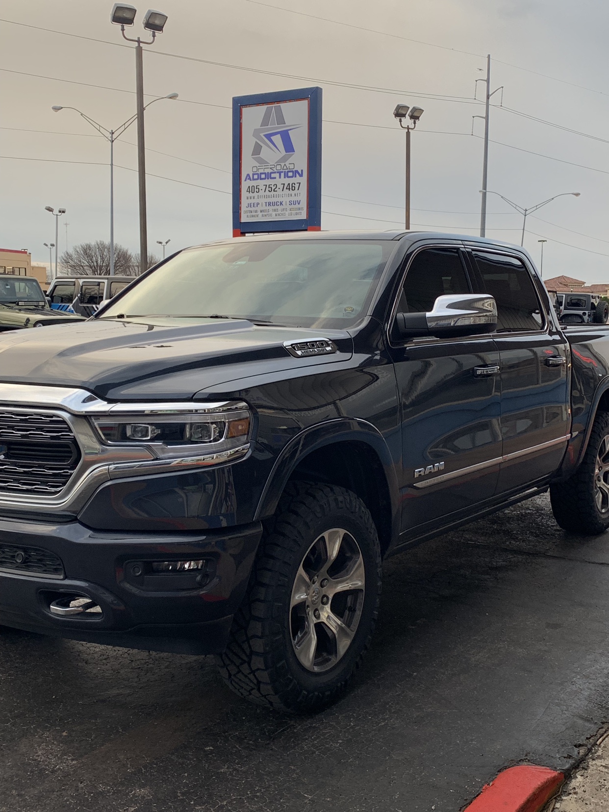

So what other level kit are you installing?
Do you have a Pic directly from the side?

Go figure! It’s pouring down rain and windy here. I was able to get a pic before the weather started though.
All 5 suspension settings are working properly and the ride is night and day better. Since this was the 1st go around with the local shop, it took them a little time to fine tweak the links for a level stance after installing the traditional leveling kit. The tech told me he finally went with 2 1/4” spacing on the Revel Performance links to bring the truck to level.

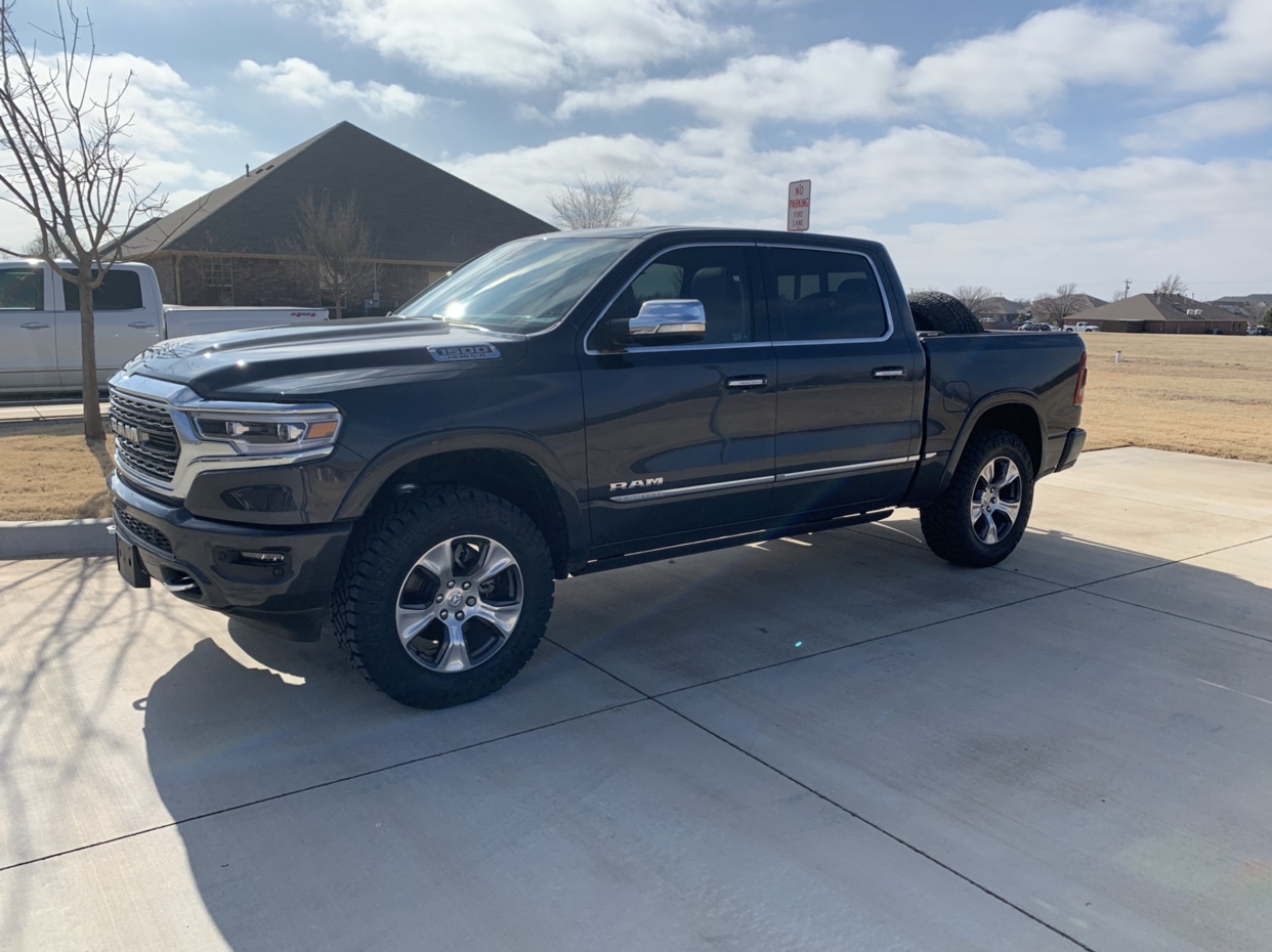

I was able to get some pics today after calibrating my speedometer with the Rough Country calibrator. This has been a process but thanks to all on the forum who have posted their trial and errors. Without this info sharing, I would still be sitting stock and thinking about a work around.
I started off by ordering the Revel Performance Leveling Links. After tweaking them, I was able to get a significant amount of front lift but immediately threw a Suspension error message. Dialed the links down a bit and got the error to go away.
Unfortunately this compromised the ride quality more than I was willing to accept. Decided to go ahead and get the new rubber anyhow and eventually decided on the Nitto Ridge Grapplers in 35x11.50x20. This alone added an immediate upgraded look to the truck and somewhat brought back the ride quality.

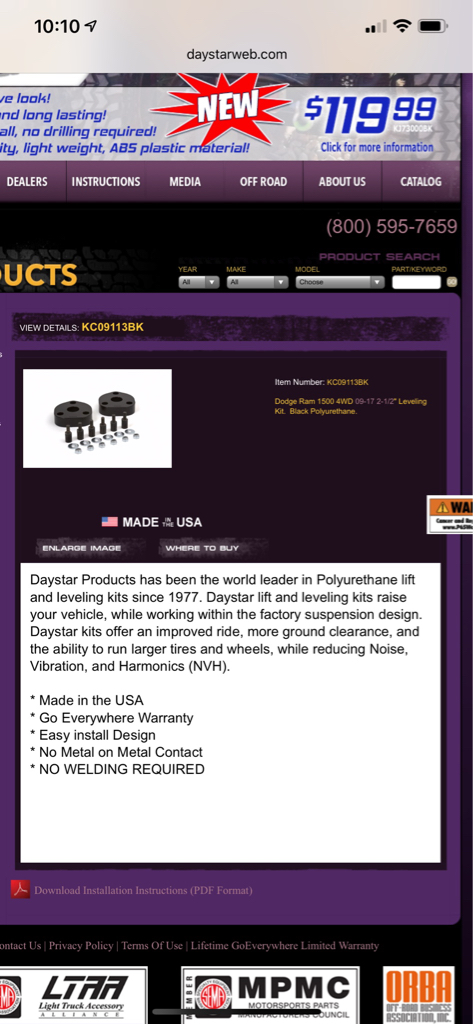

Yesteday, I finally had my local offroad shop install the Daystar polyurethane leveling kit that is suggested for a 2018 non air suspension Ram. This took quite a while since they had never ventured down this rabbit hole. Well, I'm here to say it was worth the wait. The ride quality is as soft as the day I took delivery. Here are the updated pics in all modes.
