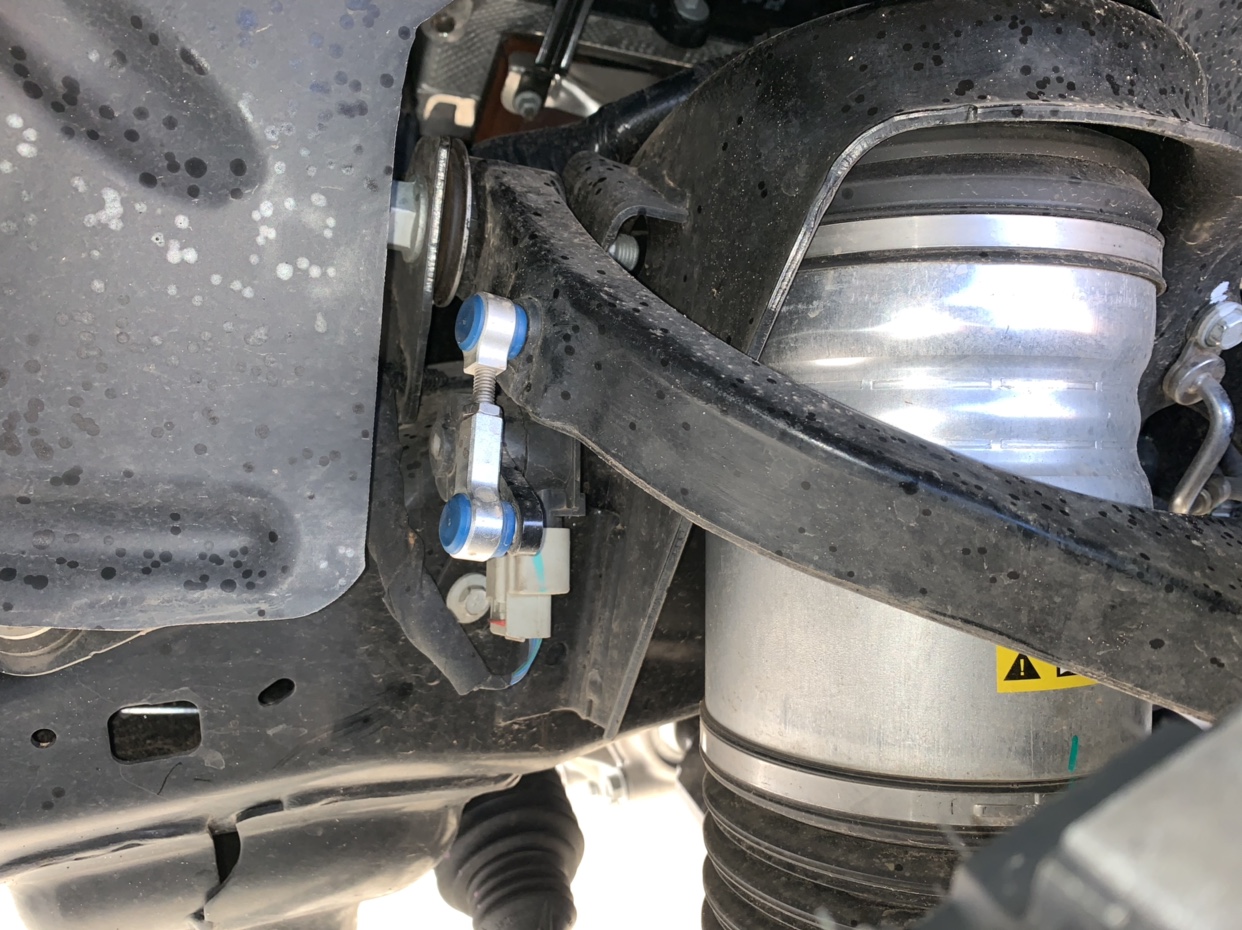

Thank you very much for taking time and share all your information - big help to lot of people out here!!!It’s really hard to see but they’re in there.
What took longer than expected was due to the minimal experience they’ve had with the air suspension as a whole. Also took time to guess and check the length of the links to get level. I was able to use the front links only and couldn’t use the back ones because they couldn’t adjust down to the size needed to get truck level.
If you decide to go down the same road:
1. My links are set at 2.25” center to center at the female openings
2. Put vehicle in “Jack Mode” then disconnect battery prior to disconnecting the air line on top of the suspension.
Other than those 2 items, everything else was fairly straight forward.
So far, I’ve noticed nothing other than the benefits. Not sure to what lengths the shop took to preserve the connection or loss of nitrogen but everything seems to going well. Still taking things easy though. Haven’t been off road.
