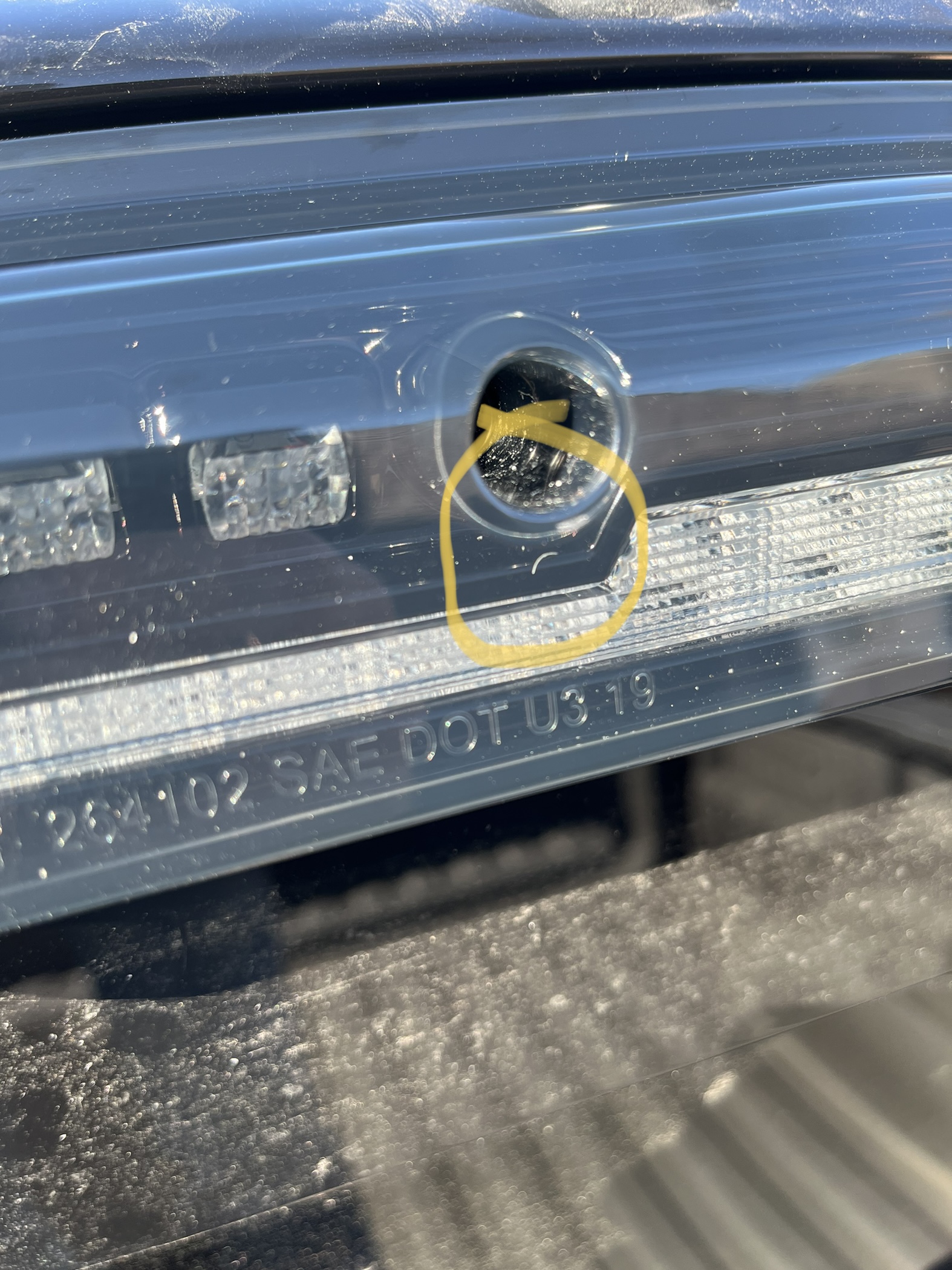

It’s the screw holes that are the problem. When you screw in the screws it makes little shavings as you go through the plastic. I went to blow them out and they blew right inside the light. In the pic, the little piece of plastic that I’ve circled is inside of the housing.
So is it marring the plastic the entire way as you drive down the screws? Or is it that some of us are potentially tightening the light down too tight to achieve the flush look and the head of the screw is digging into the plastic at the base of the screw hole? If over tightening is the cause, we definitely need torque specs from Recon so that we know when really tight becomes “too tight”

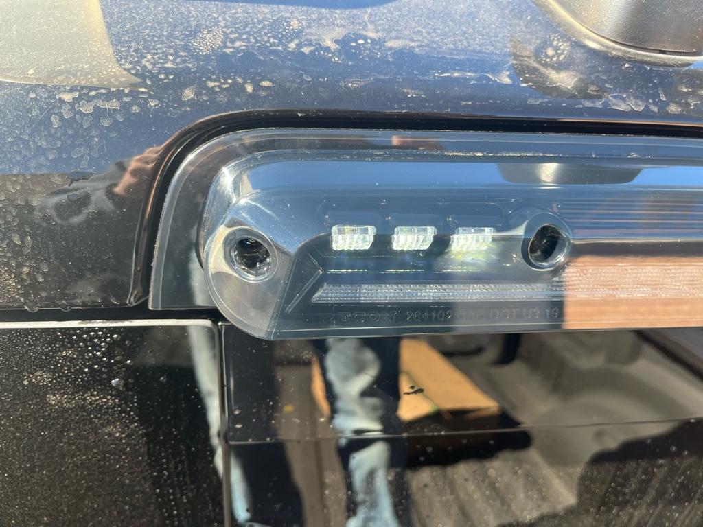

So the replacement light has the same issue. This time I sprayed water from a spray bottle into the screw holes. There’s actually standing water inside of the light now. Below the bed lights and above the brake light. I’m not sure if it’s the screws damaging the light or just faulty seals around the holes to begin with.
I think I’m just going to return both of them and spend the extra cash on OEM if it comes down a bit in price.
It may be I’m just damaging it trying to get it flush but I’m not interested in getting another one and replacing the gasket to try it out.

Alright, so I’m a cheapskate and couldn’t stomach the idea of an OEM $400 light. I decided to silicone the hell out of the screw holes. I hit it from both sides of the light. Front and back. I used a q-tip on the front to keep from getting any silicone on the front of anywhere visible in the screw hole. Pushed the screws through a bit, reset the silicone to make sure everything was covered. Then added some more to the back so when I torqued it down it would mash everywhere and hopefully fill in any gaps.
For those of you who have bought the light you’ll know why I’m talking about with the front and the back. Just really get it in good around the foam seal in between the front and back of the screw hole.
I let it sit for 24 hours and hit it with a spray bottle and an air compressor. No leaking and no moisture inside. I think that solves the problem. We’ll see. A huge pain but overall if this holds it’s worth not spending two hundred more on an OEM unit and not having to deal with FOB issues.
