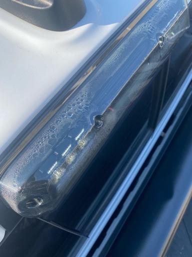

That is a lot of moisture! I kept my eye on my mine after installing it due to all of the posts about this. After a few days of rain and taking it to through a car wash I noticed no moisture or water in my unit. Still going to watch it however.
NOT HAPPY!!!
I am sending this back. I better get a refund, too.
I have no idea how long that condensation has been there, either. I just checked it today. I don’t remember the last time I really looked at it before this. Maybe 2-3 weeks ago. As far as I knew, it was bone dry. Apparently not.
I just put the stock OEM fixture back in.
I contacted Recon. I am waiting for a response. Personally, I think that this product is way too expensive to be failing like this. It has happened to way too many people on this forum. I metioned that to Recon in my email, too.
I don’t want another one, to be honest. I hope I get my money back.

Mine is also still holding up well, but I haven't let my guard down for a minute. Recon claims that the condensation issues are few and far between but just based on the sample group in this thread, I'd say nearly half of us have had trouble with moisture so far. I'm sure it is a bigger issue than what they're willing to admit.

I’ve had the same condensation issue on mine. Contacted Recon and they sent out a replacement. When I took the old unit off, I could actually see a hole on the medial aspect on the inside of the left outer screw hole. Inspected the new light and didn’t see said hole, so figured that was the culprit. Installed the new light and all was good. A week or two ago we had some bouts of rain and the new light fogged right up. I think it’s actually worse on the replacement compared to the first one. Not sure what I’m gonna do at this point, maybe just get an OEM. Pisses me off.

Mine has also not given me any key fob issues. I did have condensation on both units I bought. But since I siliconed the screw holes I haven’t had any problems. It’s a real pain but works now so I’ll just leave everything alone.
Can you elaborate on "siliconed the screw holes? Just fill the holes, then screw it in?
You bolt it on first, then fill the screw holes with silicone.
Exactly. I did put silicone on the back side of the holes. A pretty good amount before I placed the light on the frame. Screwed it in. Put more silicone in the holes. Called it a day.
I had good luck this whole time until coincidentally I was washing my truck before I saw this reply and I saw fog on the inside of the lens. I don’t know if it’s coming from somewhere else. Or my silicone came loose. Or if I just got lucky every other time I sprayed it.
I’m past any additional refund period. At this point I still really like the look of the light. I’ll just deal with it until it breaks or I decide to buy OEM.
