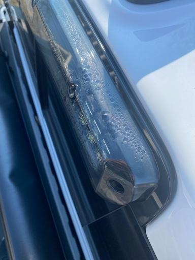

Is it confirmed that it’s coming from the screw holes??.. if so then caps would be a easy fix.

Going to installing my replacement today.. is there anything different I should try/do to avoid this moisture issue?
I siliconed the hell out of the screw holes. That did the trick.
Some pics of my old one..
It was holding a lot of water.. and it’s definitely from the screw holes. It all drained out from the 2 outer screw holes.
Installed the new one.. let’s see what happens.
