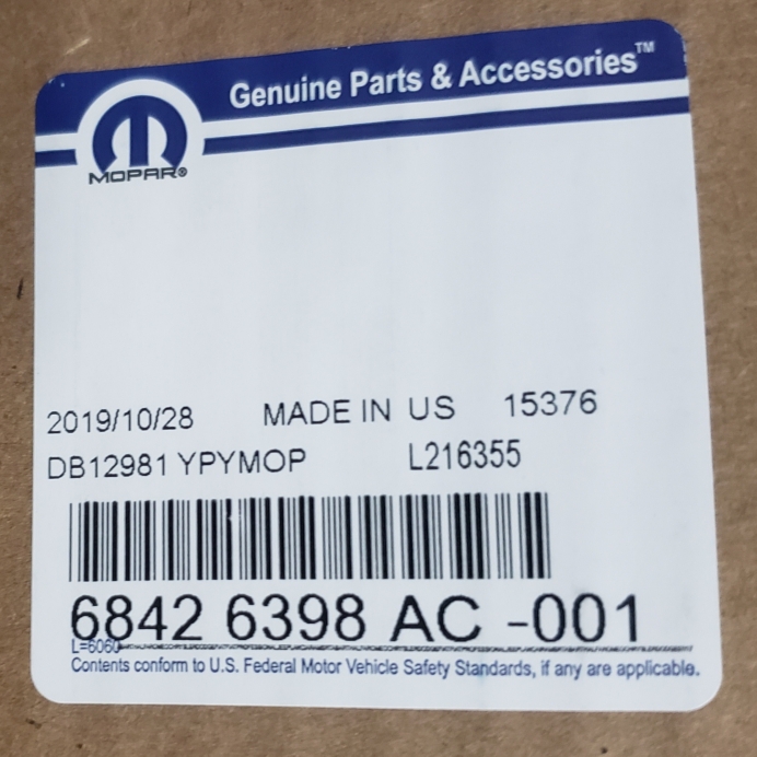

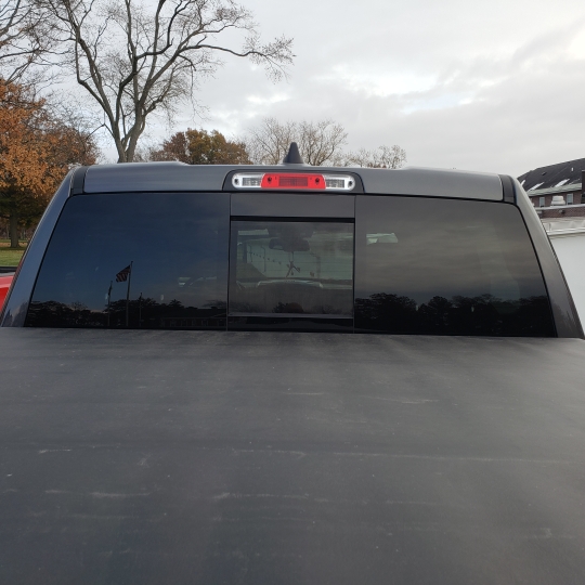

Got truck back from dealer tonight. Dropped off 8 Nov. Replaced entire rear window. Window shipped from vendor and received in less than 5 days. Local shop contracted by dealer did the install. You can faintly see the mold marks, even on new window. Snapped a pic of label from new window box and warranty repair order.
How is the Packing label on the Box later than the install Date??
Packing label says 10/28 no? Install was in November...
Your right,,,My Bad!
Not sure what I was Thinking.

Glanced at Mine a second ago....and It does look suspicious in that spot again, yet I do not see a Crack.
I will check it again when it is not so Cold outside.
