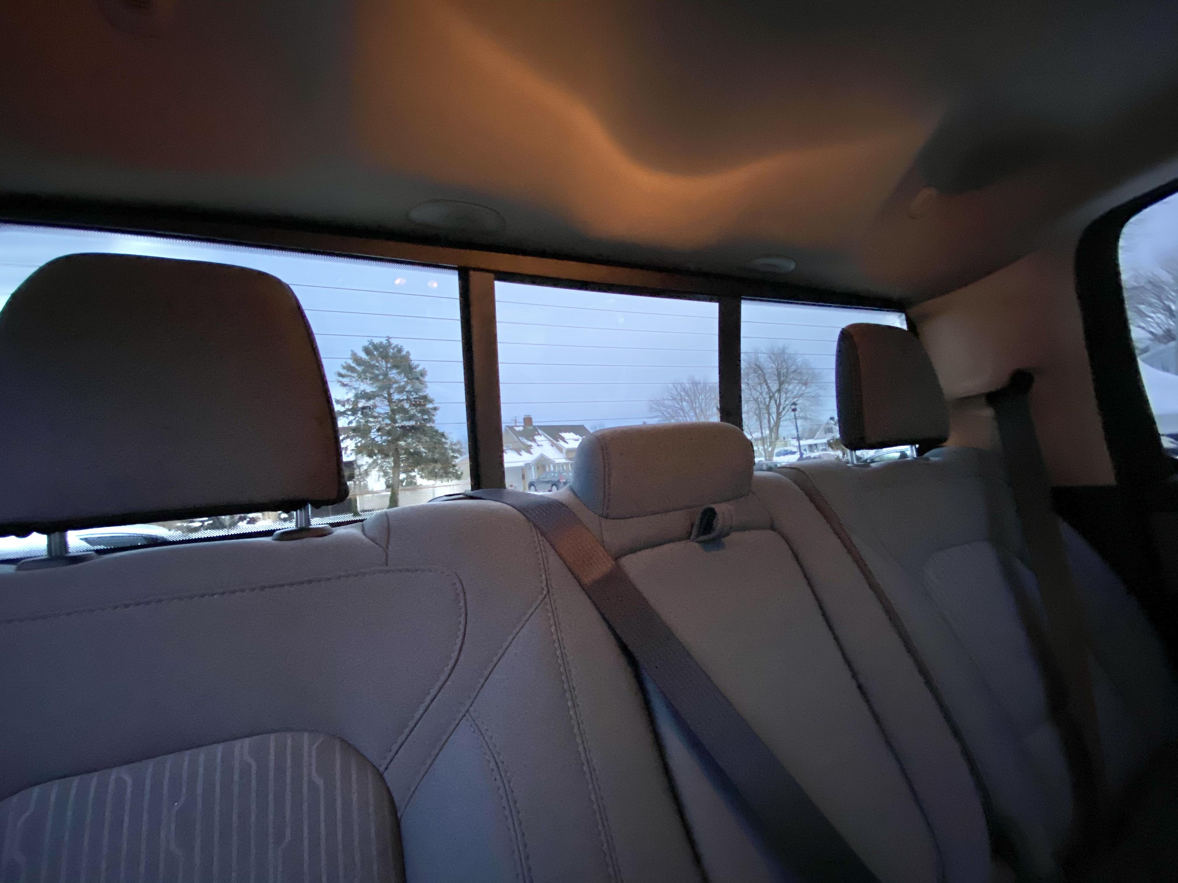

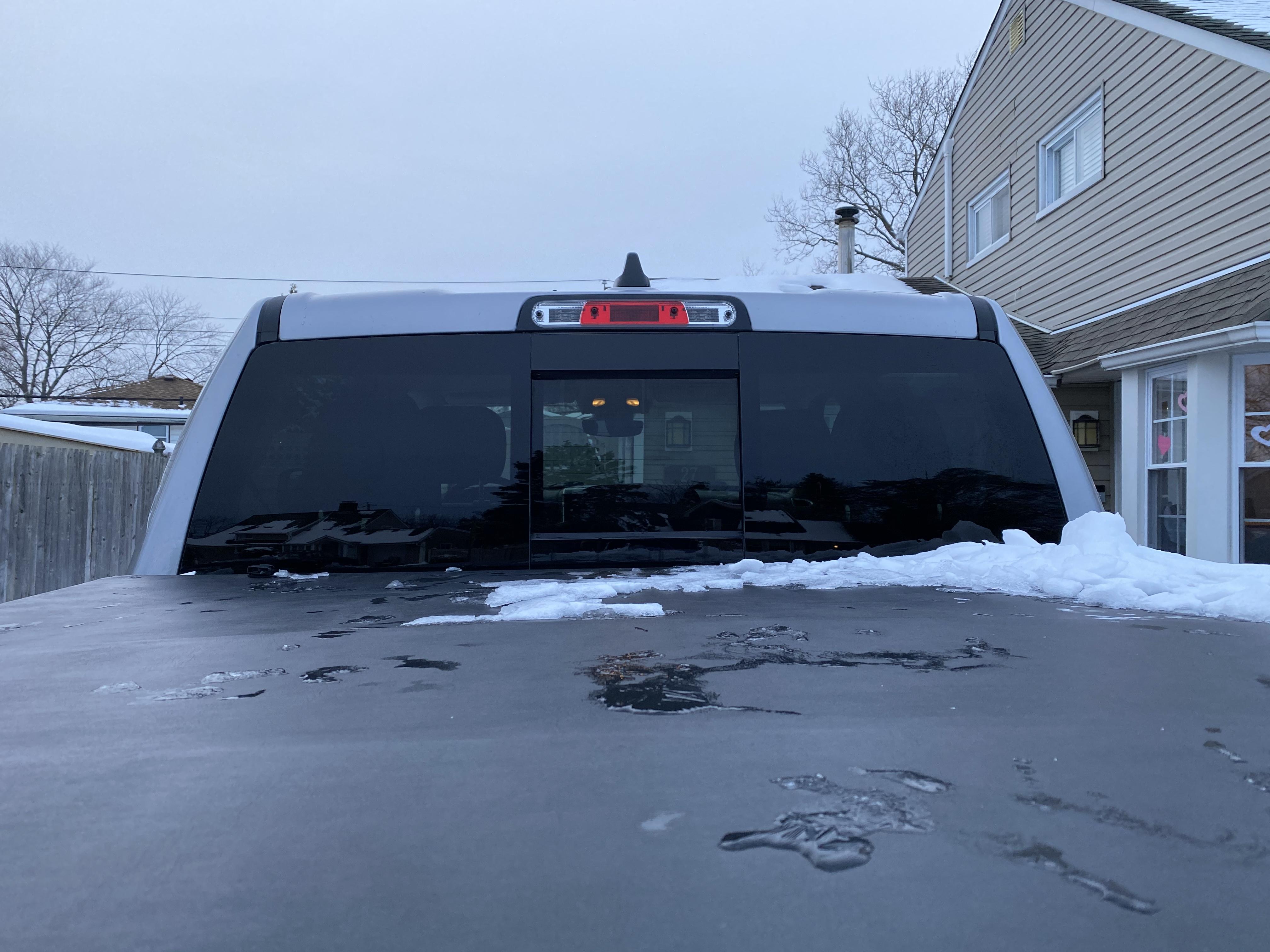

Just went out to look lol. I couldn’t notice any differences but here’s a couple shots, maybe someone can spot something. My guess would be any changes would be internal, it was the frame that was cracking right?
The top plastic reveal above the window as seen from the inside does not look as tall as the original,,,,that is also what I noticed on My Replacement.
