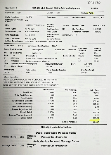

Rear window surround crack.

I've got an appointment on Monday. They said they need to verify it's covered under warranty and then to order the window/parts.

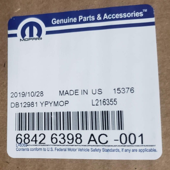

By the part number, I can assume that is the 5th update of this backglass... Part number ending by AE. AA was the first followed by AB and... B865A6A0-4697-4A59-A9C7-D6A1A75BE93A.png
By the part number, I can assume that is the 5th update of this backglass... Part number ending by AE. AA was the first followed by AB and... View attachment 45001
I had mine replaced with this part number in mid November 2019, no clue why the part numbers have changed altogether.
