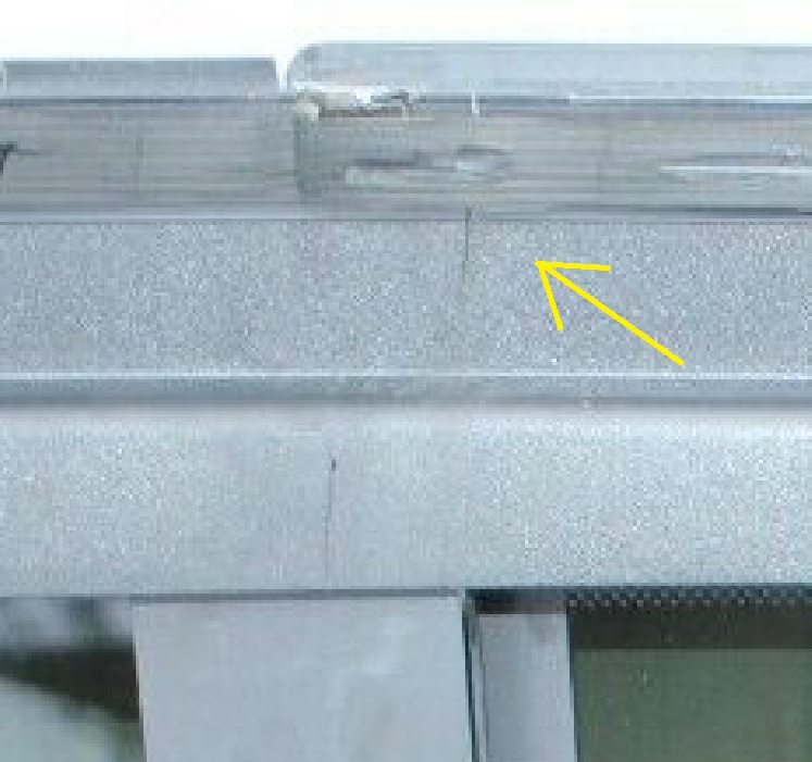

Out of curiosity, is there any visible evidence of cracks on the outside? Mine do not have the cracks yet but I’m curious if there is any way to see them start forming before the water starts coming in.
I did not have any evidence of the cracks on the outside. When I found the leak and crack inside I looked everywhere.
Thanks for posting that pic. My frame isn’t cracked but does have the faint look of it on the left side. But my window still leaks. I wonder how that bulletin would relate to my situation.
I also have the faint look of an issue on the left side ( looking at it from the inside)of the slider. Almost like a smoothed out area of the plastic. The right side has a cracked line that goes up into the headliner.

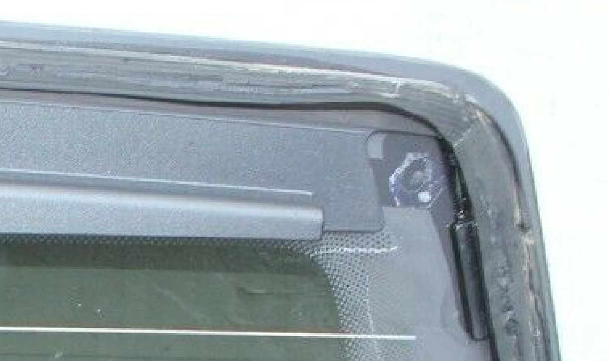

If your window leaks, then it needs to be replaced. The leaks have nothing to do with the cracks. Go to the dealer and have it replaced under warranty. It does not have to have cracks to leak. The cracks in the frame have nothing to do with the leaks. The leaks are either caused by faulty sealant applied to the window or faulty rear brake installation. As I have posted on this thread several times, the frame has nothing to do with the sealing properties of the window, the cracks are just a place where the water to run to and exit.
please stop. your spreading false information. zoom in on the attached picture. you can see the crack in the frame goes under the sealer and to the window channel. the water sits right in the outside channel when it rains and goes right down the crack into your car. it as simple as that.ramwindow.jpg
please stop. your spreading false information. zoom in on the attached picture. you can see the crack in the frame goes under the sealer and to the window channel. the water sits right in the outside channel when it rains and goes right down the crack into your car. it as simple as that.View attachment 45459
do you have a higher res or more zoomed in version of this pic? I'd like to see some more about this.
I'm not yet affected but I am concerned and will be applying a little insurance against this soon.
The frame does go under the black seal. In the second picture, you can actually see the crack, going under the black seal.
