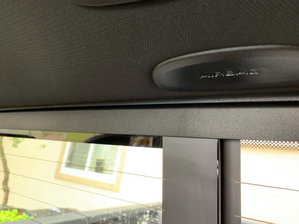

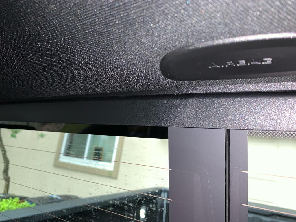

2020 Longhorn, no sunroof, build date 7/19, about 550 miles on the odometer.
I feel like I looked for this last week and didn't notice anything, but I can't be sure.
I don't know if it shows in these phone photos, but there does appear to be some discoloration or straining on the plastic there. I've got a black headliner, but I'll obviously have to keep an eye on this and prepare for what seems inevitable.
I'll see if I can track the progress over time to see if a crack develops slowly, or if it suddenly appears some day or what. Interesting situation for sure.

Seems like they've done nothing to improve the rear window assembly.
I ended up not going to my appointment today for this issue. I'm going to keep an eye on it and run it for another year hoping they improve the rear window assembly. If not, I'll trade mine in on a new Ford F250 which was my original plan before buying this Big Horn.
Mine has the same discoloration at the exact same spot on both sides of the slider. I’m watching it closely as well. I’m thinking it must be from the manufacturing process and these sections have somehow become brittle during manufacturing.

My new replacement window has the same lines, I’ve been keeping an eye on it.

Mine looks the same.
