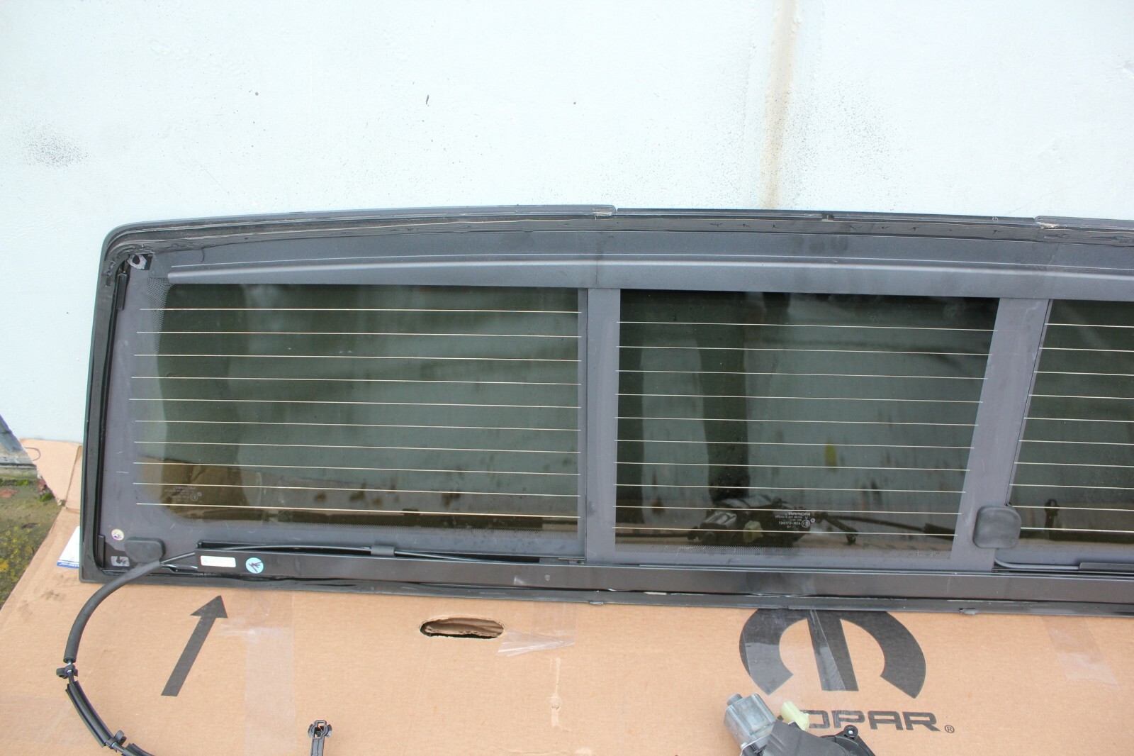

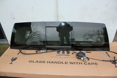

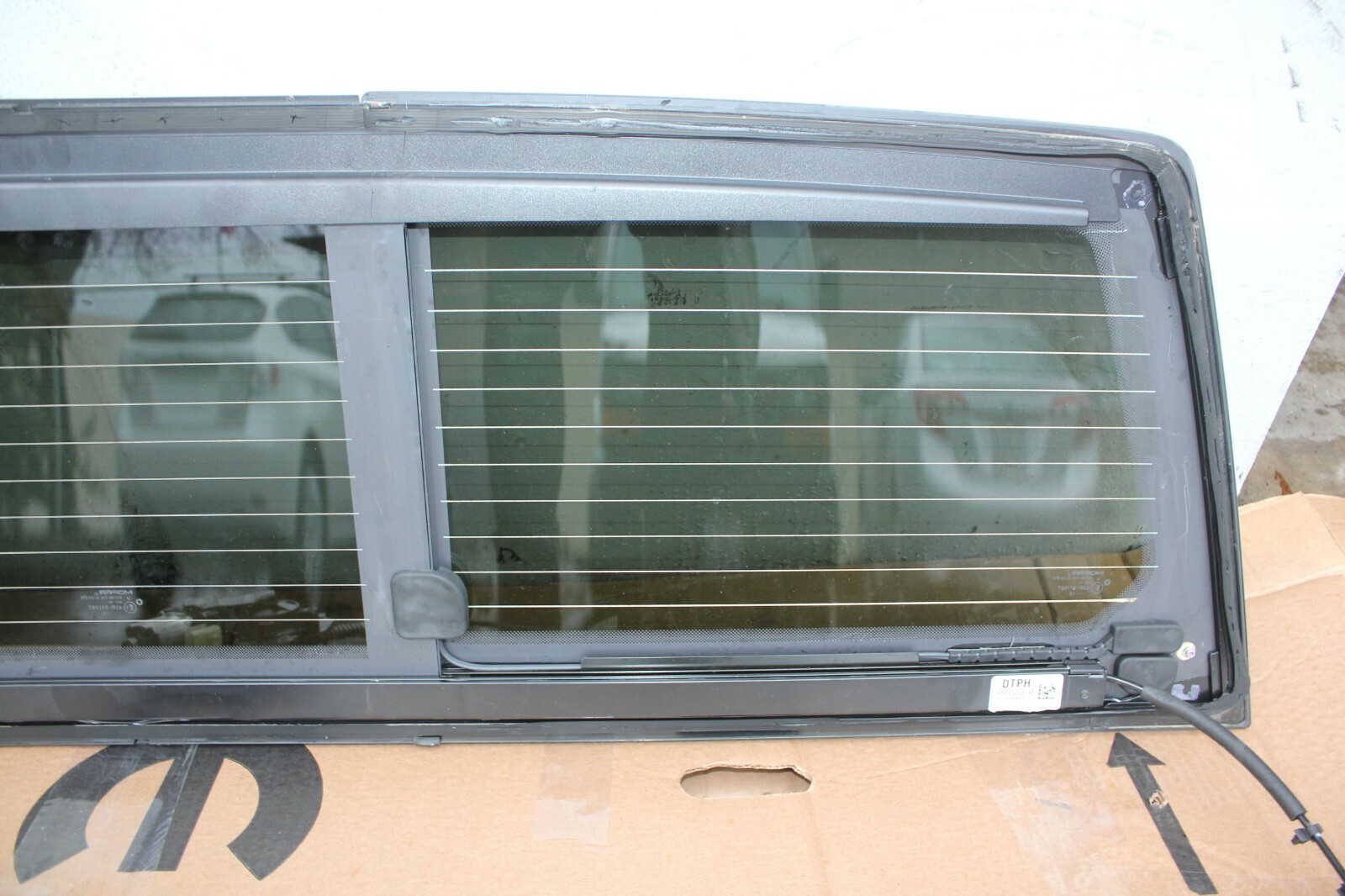

Here's an ebay listing for a used 2019 rear slider. You can clearly see 2 cracks, 1 on each side. Also, it appears the frame goes underneath the black seal/caulk. This would explain the leak associated with the crack. If the crack goes completely under the seal, that would indicate that the crack is exposed to the outside elements. Water could find the crack, follow it, and bypass the black seal.
