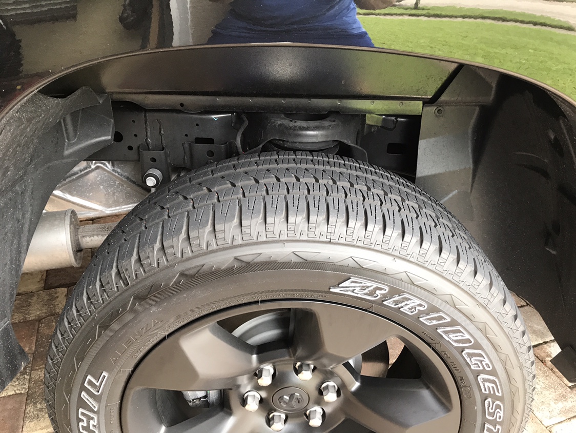

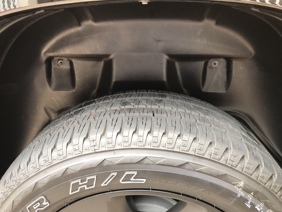

Great work. They look great.Liners came in today and installed it.
Pictures attached.

Thank you.Great work. They look great.

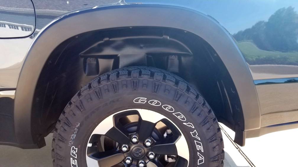

Thank you.Significant change... nicely done!!

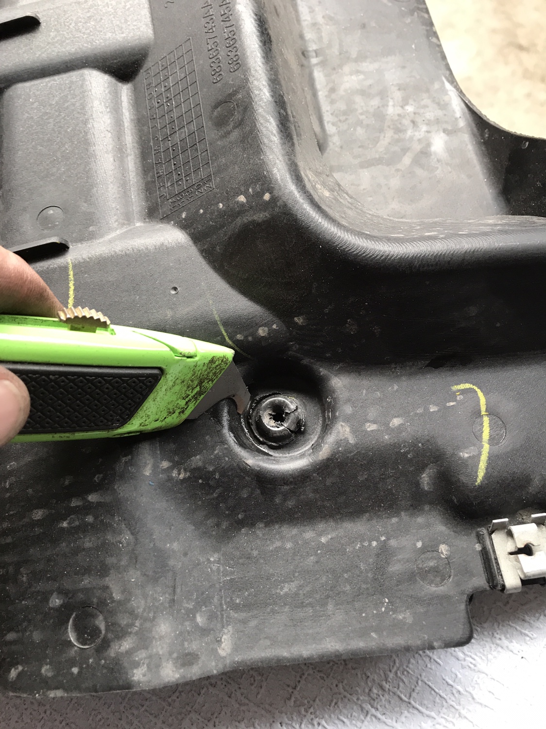

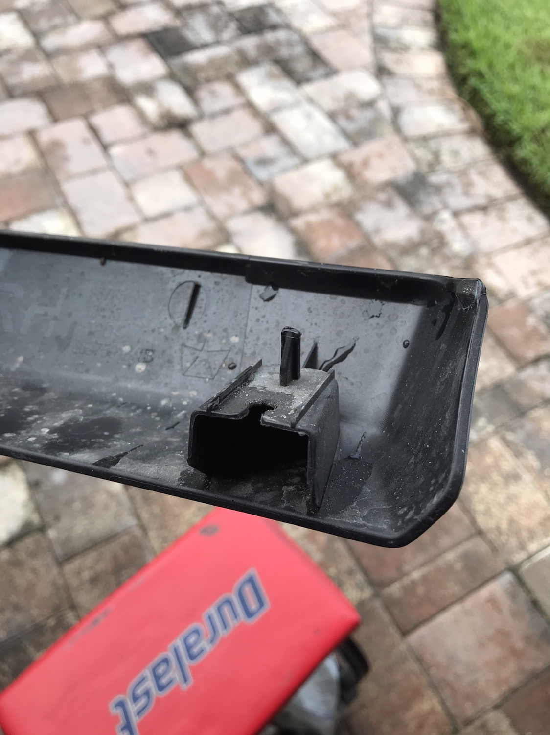

I installed the liners without separating the rear pieces.Ok did the install today really easy... I did separate the rear 2 pieces and used the back one found an easy way to get them apart. I used a hook razor knife blade and cut slits in the part that comes through those holes then squeezed the cuts together... then I just used a long screwdriver to pry pieces apart oh and that little tab that’s on the rear that u take off.. broke the first one didn’t break the other side till I went to put it in then it snapped.... ugh. ..![]()
