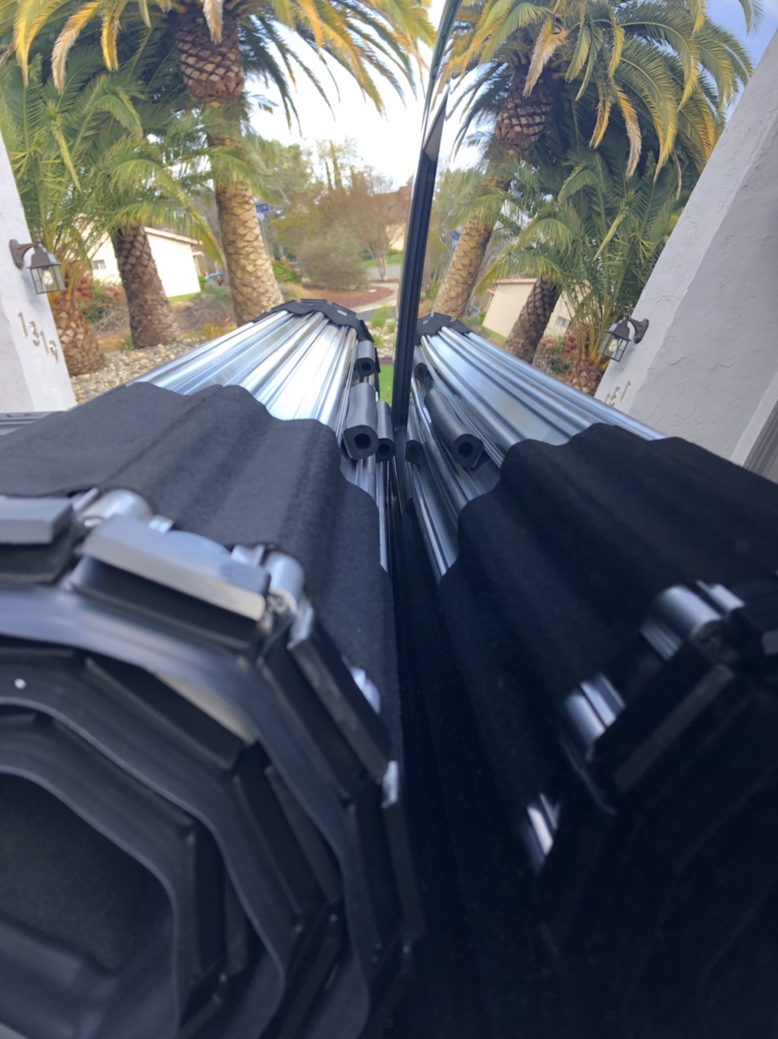

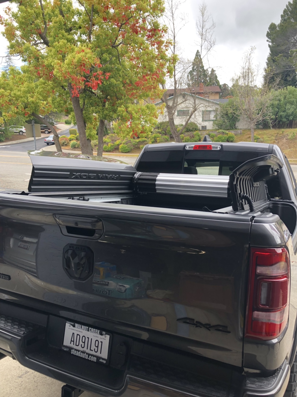

And one more pic:
The Revolver rolled open. It does take up 10-12”. For me that’s no issue and having the rear window only partially blocked is a benefit.

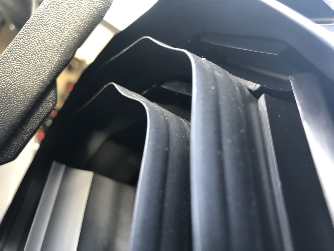

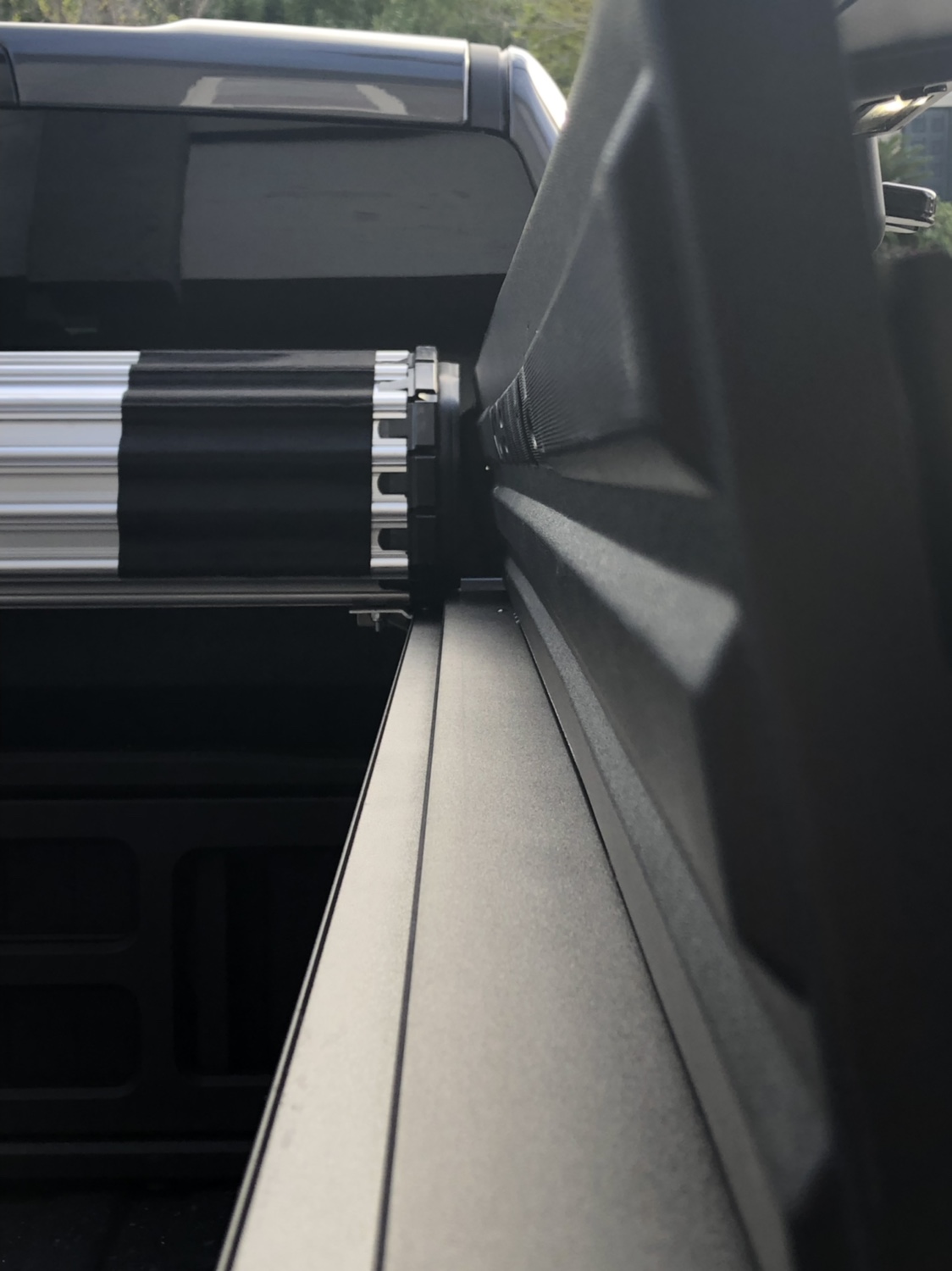

No issues at all with the RamBox doors. They open and close freely and stay open if left up.
The closure lever is smooth and has nicely rounded corners. Could you catch it and bend it? Probably. But, I think if you are aware it’s there you should be fine. In the second photo I circled the lever with the cover rolled back a bit.
