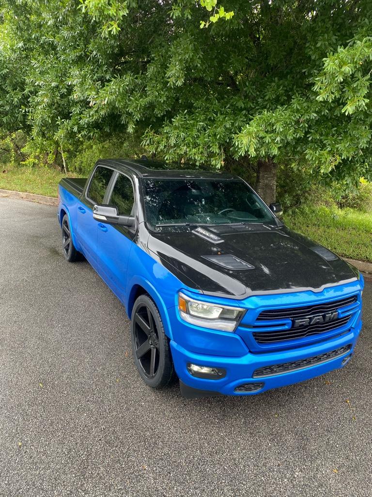

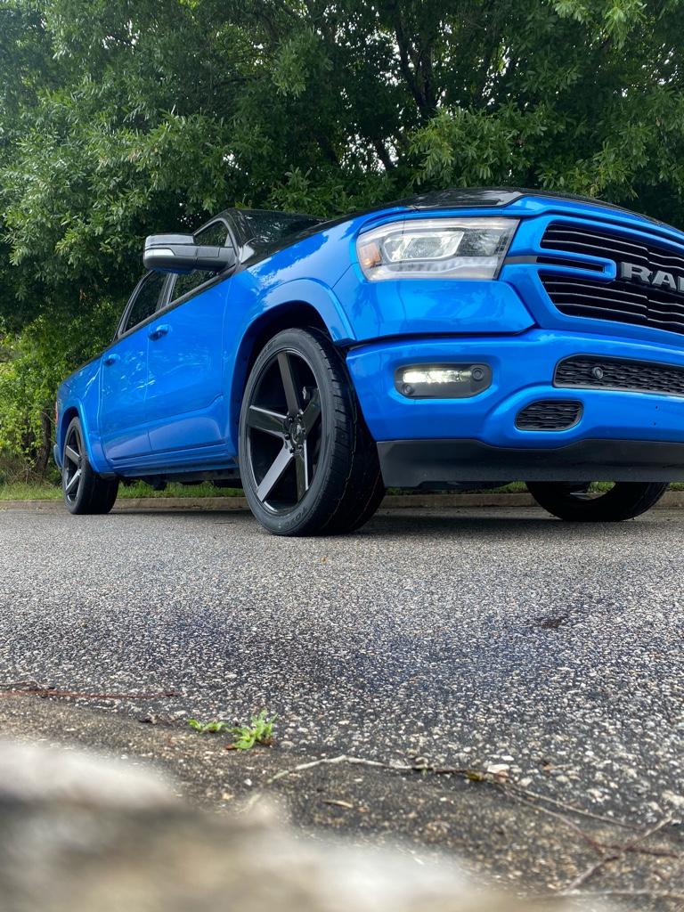

Heres mine with the rear springs.
I have not had any wobble issues. But I do need to correct the camber issue I guess I need a upper control arm I’m not real sure can anyone suggest anything
You mind sharing the wheel and tire specs you are running here? I know they are 24x10, but what wheel offset and tire size are you running? Looks great. Thank you in advance.
