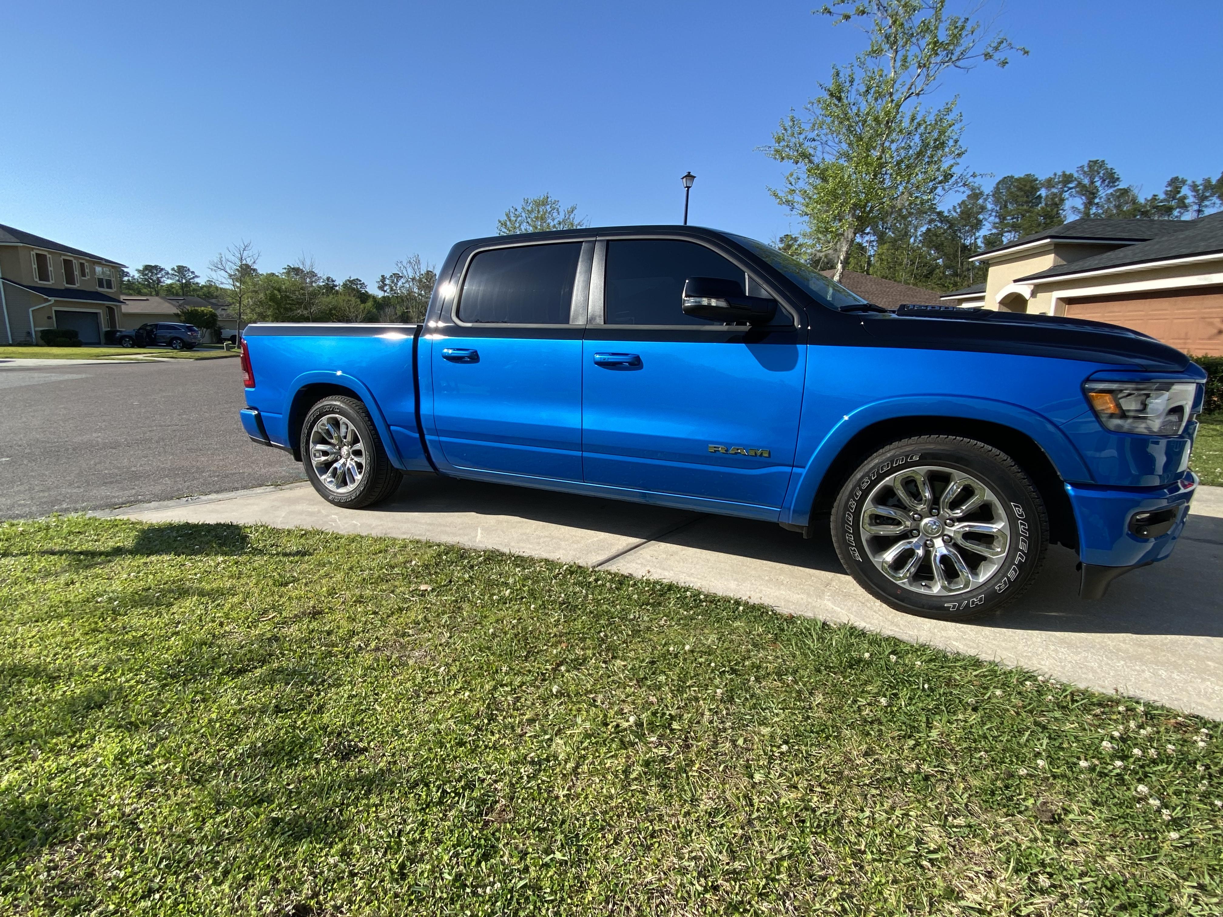

Pics of your lowered Ram

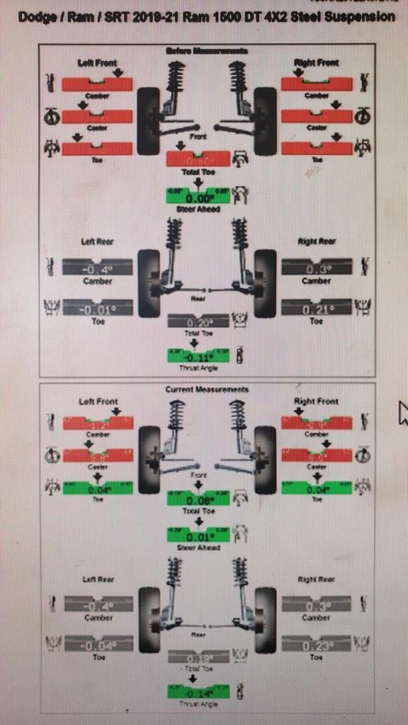

Apparently they got the wobble and the camber figured out. Just ordered it.

Sorry for the late delay! Here’s how it aligned. I feel like a moron too... figured out the shaking. Never bothered to check tire pressure from when the tires shop repaired the wheels and mounted the tires. Turns out, having the front tires at 60psi causes a shake 😂 bringing them down to 35 has completely changed the way the truck rides! Just need to figure out new shocks for the rear. The ones that came in this kit are junk!

Did an IHC Suspension 3/5 drop and it turned out great for me. Mine aligned just fine.
Did you lose any turn radius with the IHC kit? I just installed mine right now and i only get one full steering wheel turn. Maybe it'll correct after it's alignment tomorrow.

At this point I'm convinced firestone doesn't know what they're doing. Twice I've taken it and they can't get it right. Going to a local shop my installer recommended. He has experience with IHC kits in houston. Still horrible turning radius after alignment.

Yes it is. I'm going to a local alignment shop that i was recommended by IHC in houston on monday. They said they can get it right.
I have not had any wobble issues. But I do need to correct the camber issue I guess I need a upper control arm I’m not real sure can anyone suggest anything
I talked to maxtrac and IHC. The only way to correct it is to go up to 1 1/2 inch in the front strut or buy the IHC upper control arm. I just went ahead and bought an IHC kit. Got tired of dealing with maxtrac. 1200 for a kit kind of hurt but man the ride quality and no wobbles is so worth it.

I like those wheels as well man. It goes good with the two tone.
