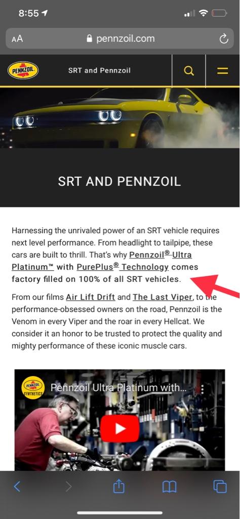

Haha. I don’t doubt it. I have 10 free oil changes. But unfortunately all the Ram dealers say they carry Pennzoil platinum and not Ultra platinum. I find it kind of strange since all SRT vehicles come filled with ultra platinum. Hmmm
Haha. I don’t doubt it. I have 10 free oil changes. But unfortunately all the Ram dealers say they carry Pennzoil platinum and not Ultra platinum. I find it kind of strange that all SRT vehicles come filled with ultra platinum. Hmmm
Aha! They admit it...it's all snake oil! "It's the venom in a Viper" hehe.
We were actually talking about that in another thread...the difference between the Platinum and Ultra Platinum really isn't much to warrant the price difference (per the chart on Pennzoils website). I think it stated the ultra was designed to handle extreme heat like when you have a turbo or supercharger. Hell...being in the Vegas heat maybe I should switch to it :ROFLMAO:
Honestly doesn't surprise me since Ram is the 5.7 and not the SRT. The Ultra Platinum is only a little better at protecting against high heat anyway....not even worth the extra cost for the RAM, probably not worth the extra cost at All.
So the truth is for 99.9% of Ram owners any oil that meets the OE requirements will do the job...whether synthetic blend or full synthetic as long as you change it at the intervals required.
