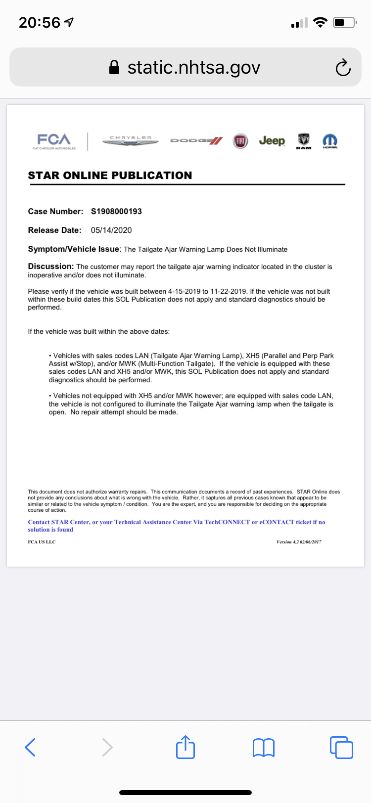

@Mustangmike66, @TX_Phil, @MarkRamCares & everyone else...
This came from my dealership when I went in to have this fixed and was told they would be in contact if/when engineering finds a fix.
Bull$hit, the "fix" is there, all they have to do is turn it ON, if AlphaObd can do it, Ram sure as hell can.

I contacted FCA about this and they said there is a tsb but my truck build date (02/20) falls after the tsb dates. Going to see the dealer this afternoon to see what they say.
I found the TSB Sascuatch referenced. It appears that you have to LAN, XH5 and or MWK to get the tailgate open indicator to work. I will be looking into the Alfa OBD to see if I can get it to work.
Change “CBC Config IO F pin 26 Connector F Pin 26: Trunk/Liftgate Ajar Signal Input Present” to YES and that will fix it. It will also make your bed lights come on when you open the tail gate (overhead lights)
