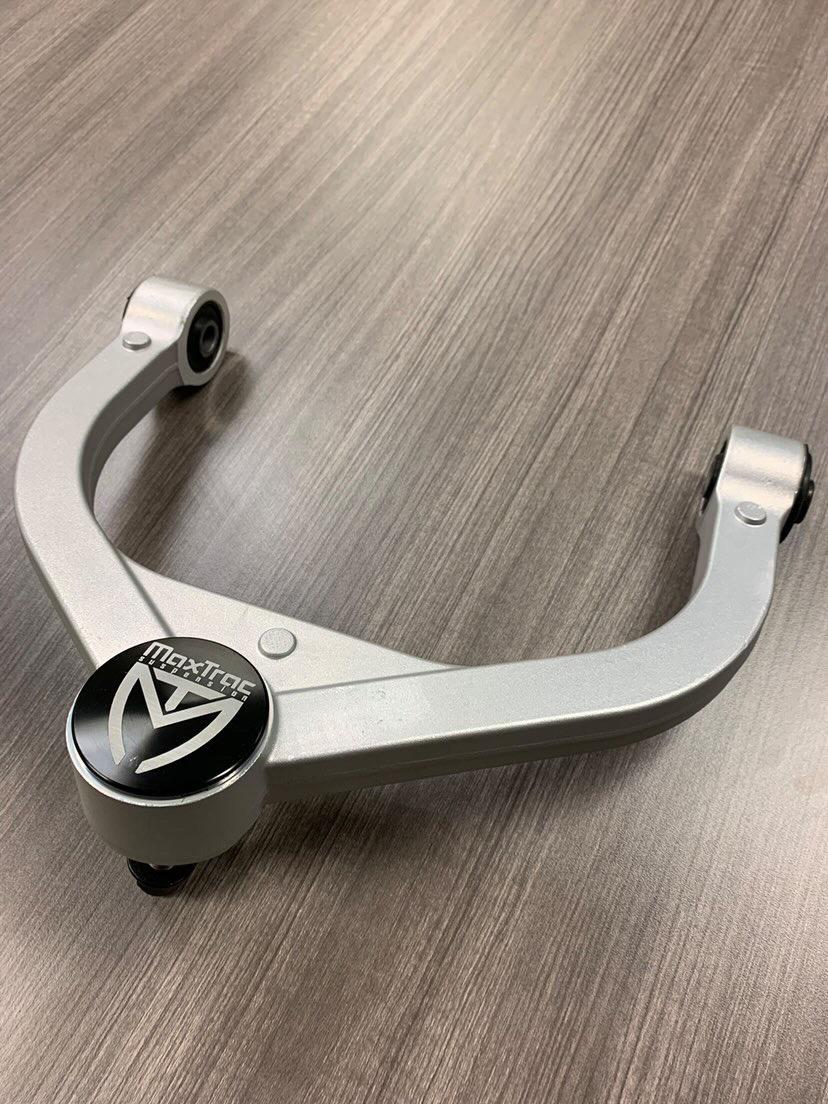

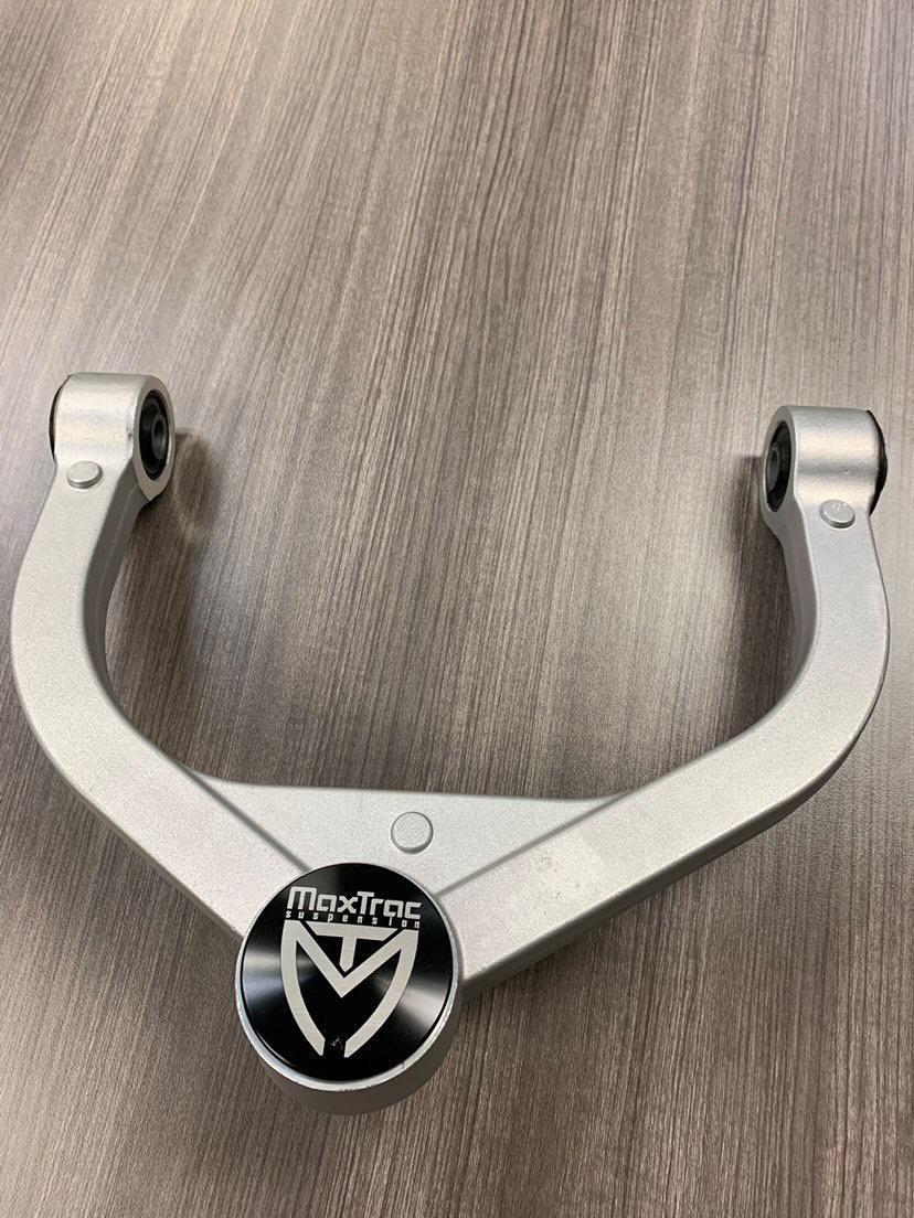

Maxtrac messaged me, they have a limited supply of UCAs for $415ish. They will Get more next month.
so we have to wait till next month is what your saying? im looking on the website not seeing any?
Are they longer or have an adjustable ball joint? Any details on them?
