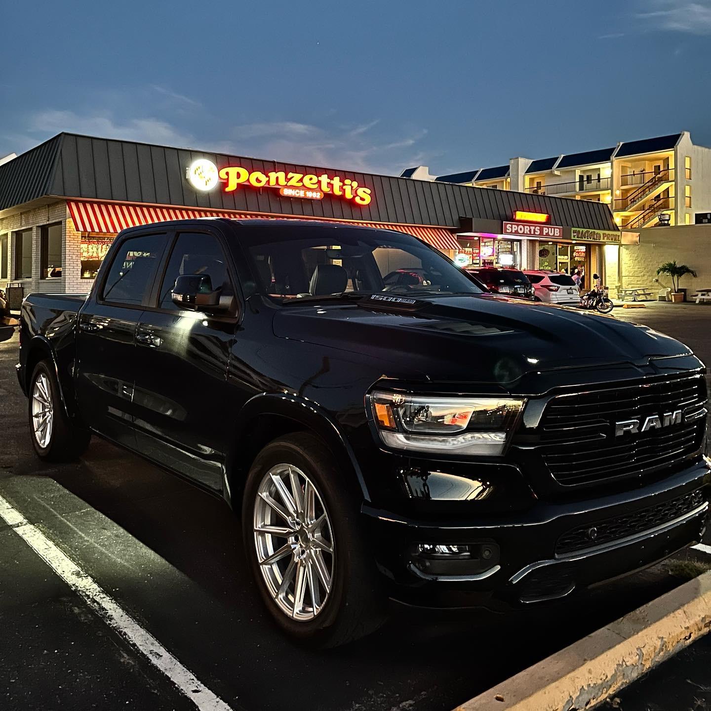

That Indian is beautiful.Got back from a 500 mile trip to the beach. Bike weighs around 500lbs. Me, wife, two hound dogs, coolers, riding gear, and luggage. Bags as 30psi. Did pretty well.![]()

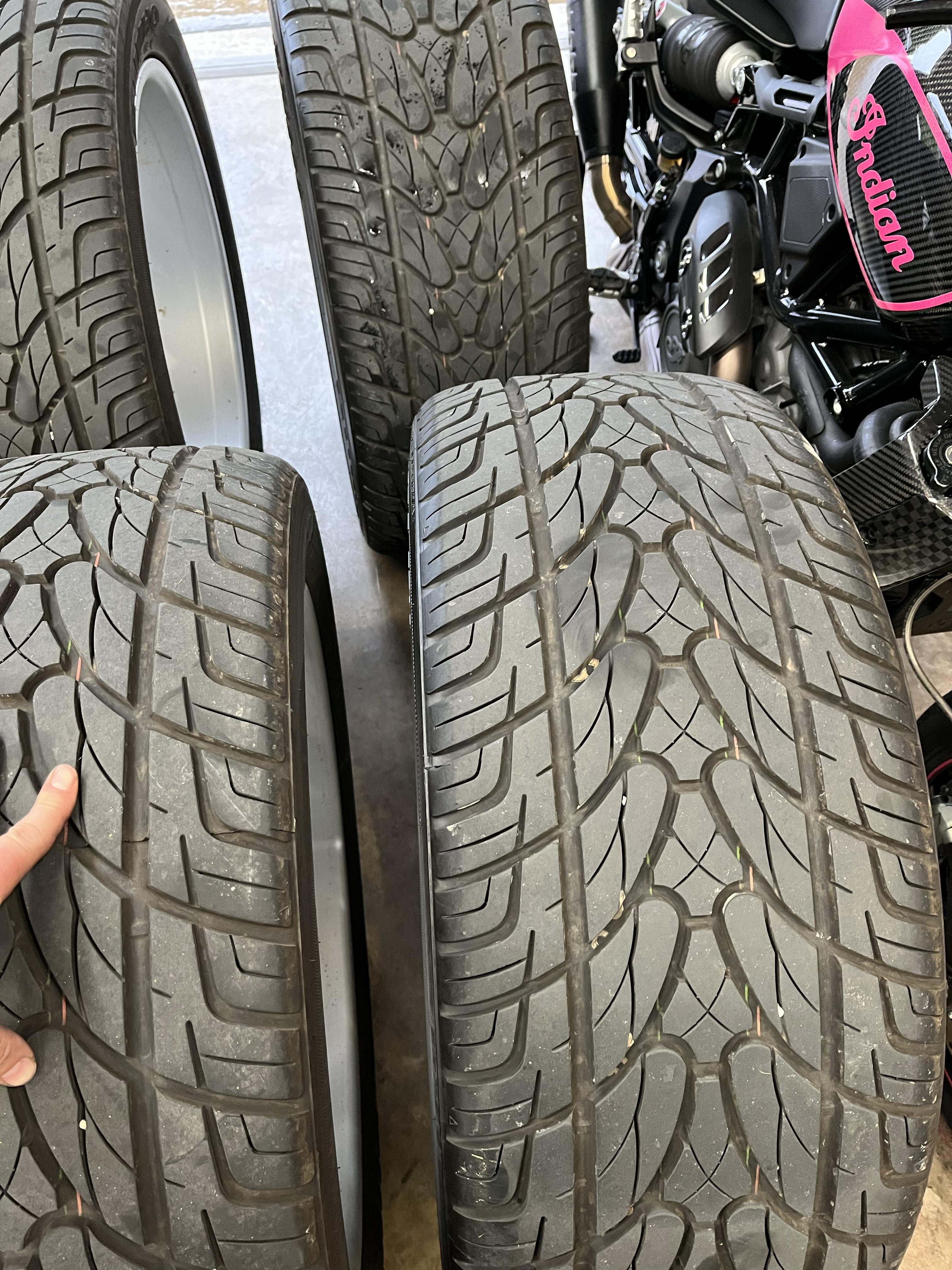

They cost a fortune and I want them so badly lolWith everyone doing black rims those rims of yours look real nice!

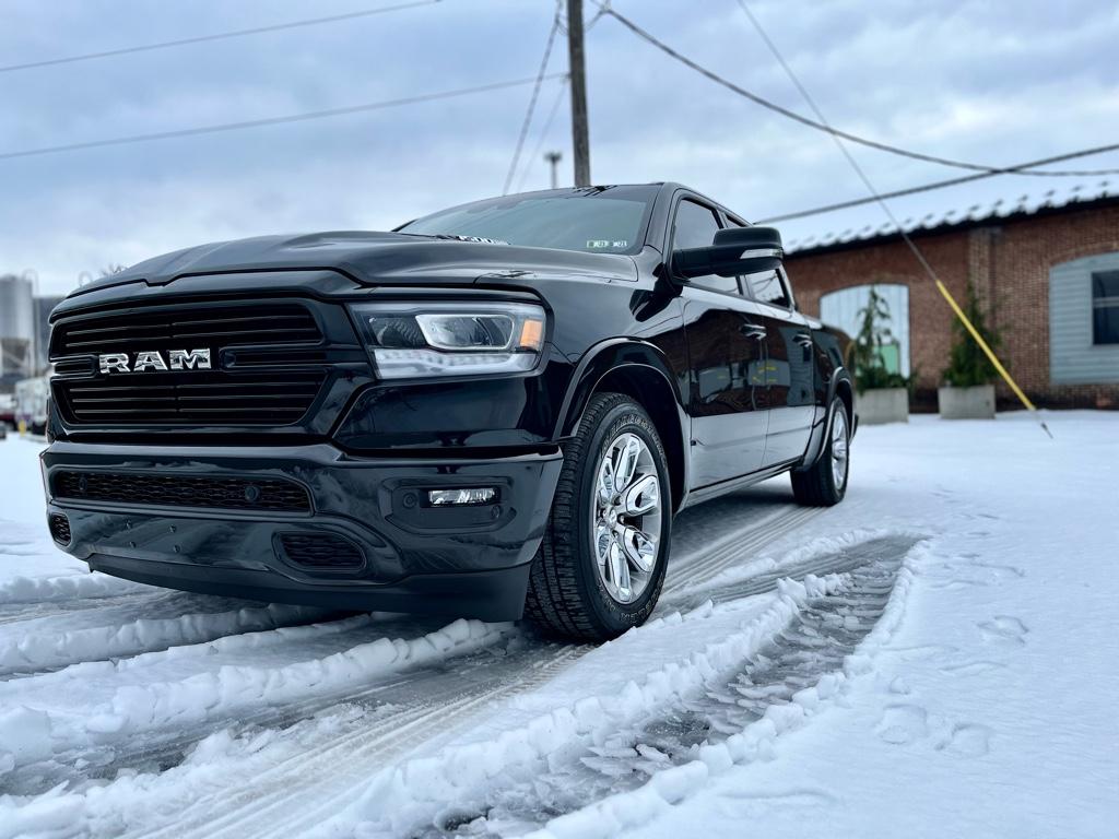

What size tire did you use?Adding a picture of my Hydro CC with 1.5/3 MaxTrac and 22” Hellcat Reps.

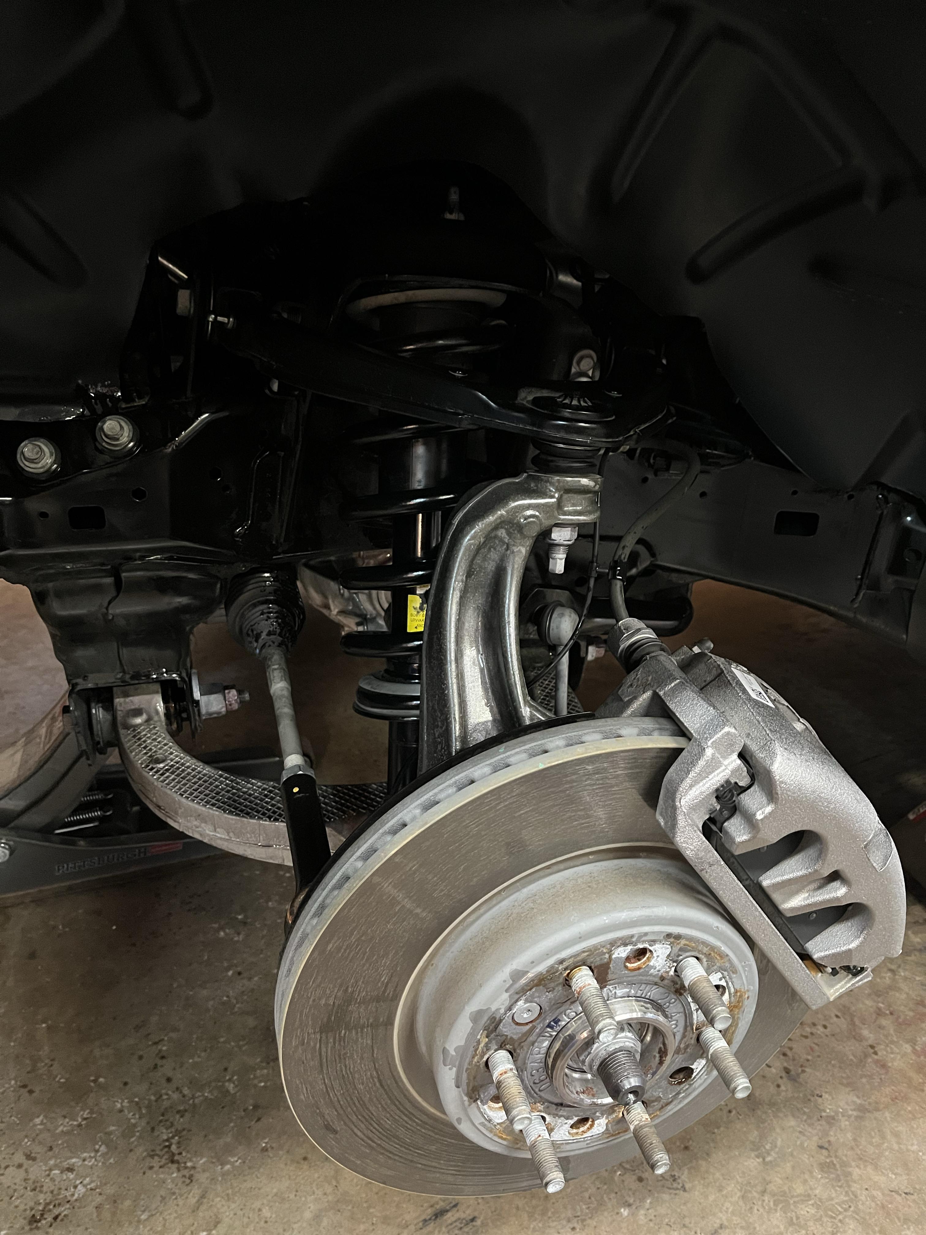

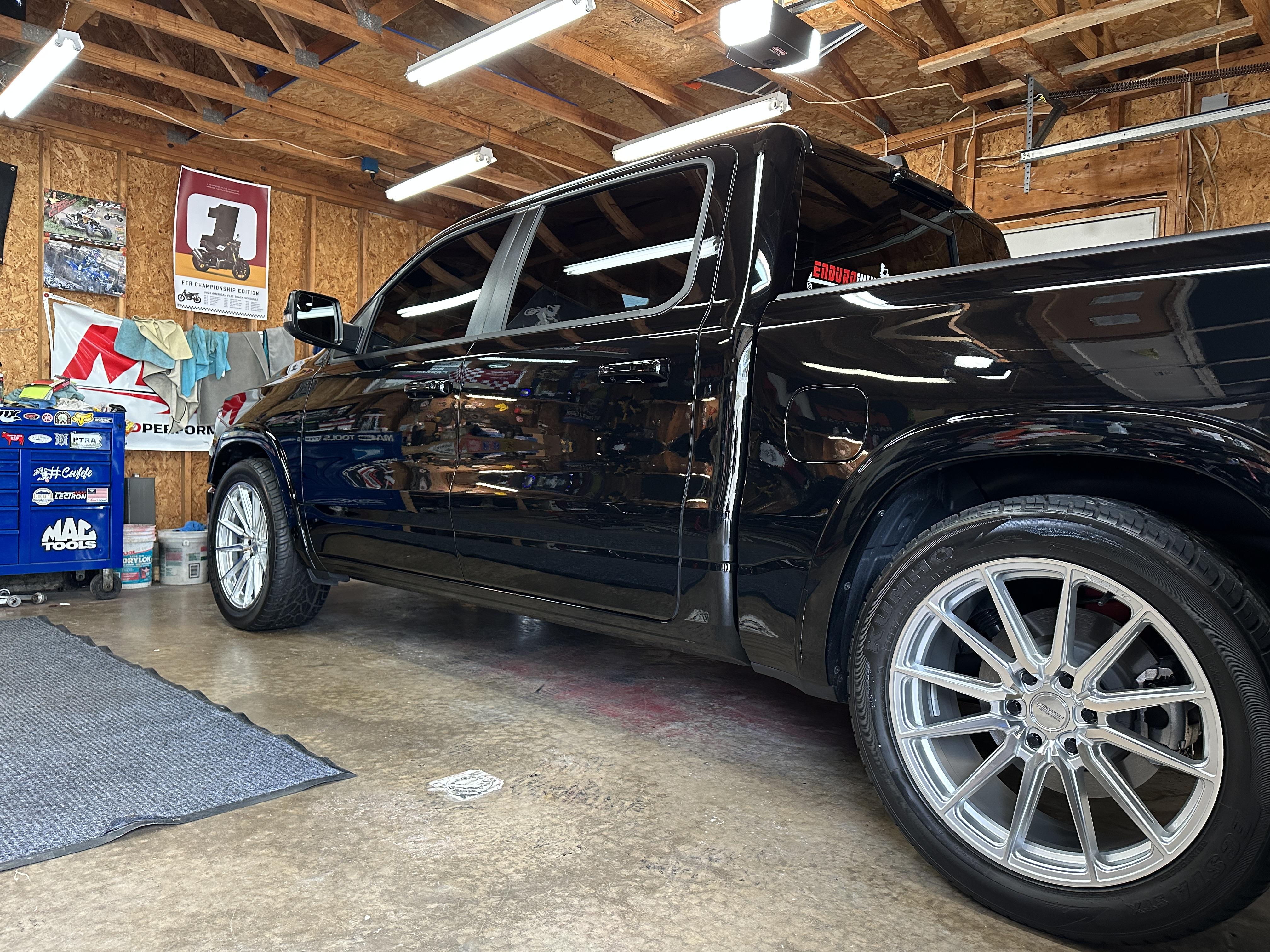

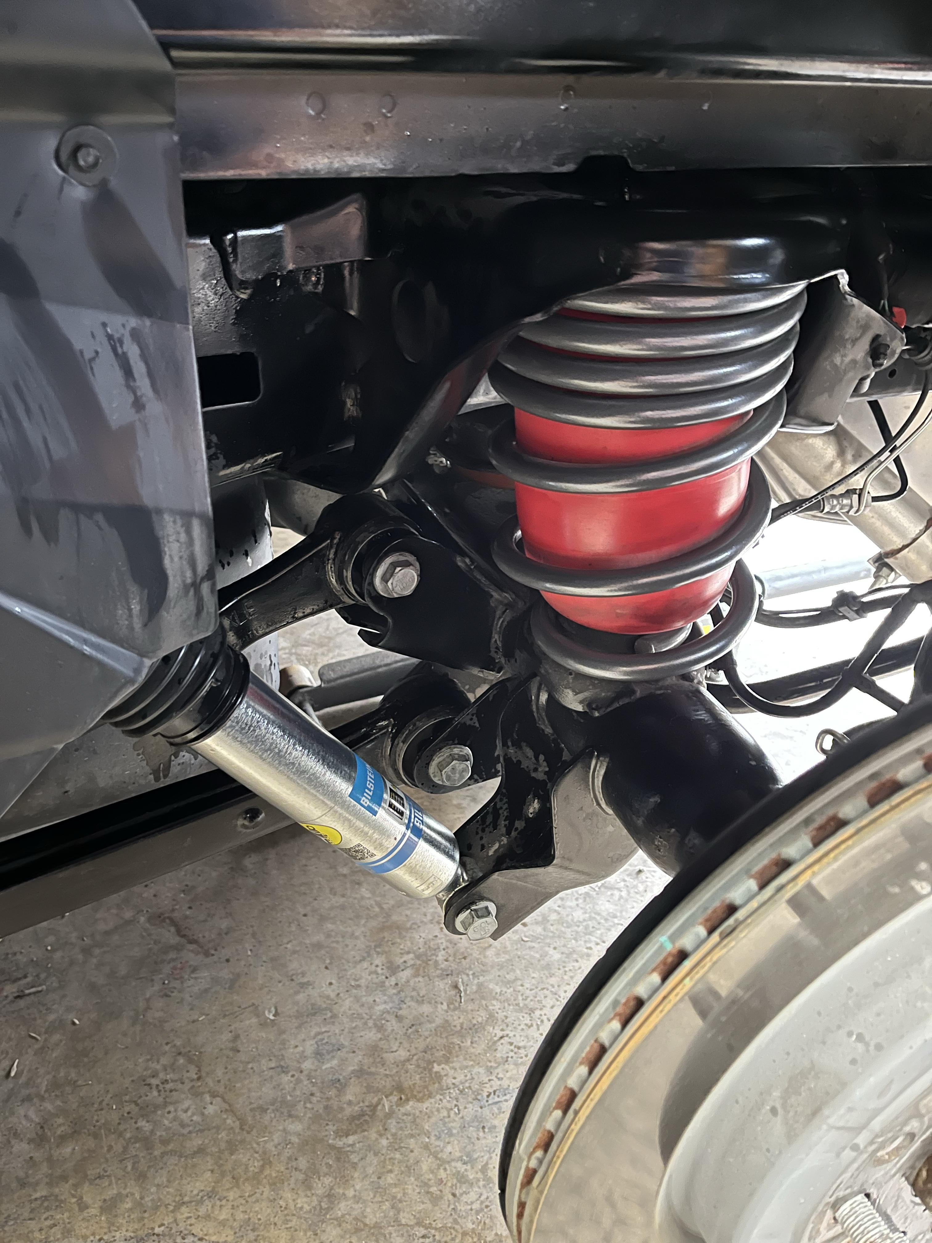

I haven't found a detailed thread with all the P/Ns and info in one easy to find post. Here ill post all the P/Ns, specs and links for the parts im installing. Most of this info is thanks to @Mopar_maxi
Truck is a 2021 Laramie Sport, CC, short bed, 4x4,non ORP, with etorque.
Suspension-
Mactrac 2/4 in lowering kit - P/N K332724
2019-2023 Dodge RAM 1500 2wd/4wd 2/4" Lowering Kit - MaxTrac K332724
MaxTrac Suspension Store Lowering Kits, Lift Kits & Leveling Kitsmaxtracstore.com
AIR LIFT 1000 Series Rear Airbags designed for a Durango- P/N 60824.
AIR LIFT 1000 Series Rear Airbags 2009-up Dodge Ram 1500 - Lowered Trucks
AIR LIFT 1000 Series Rear Airbags 2009-up Dodge Ram 1500 - Lowered Truckswww.moes-performance.com
Spohn Performance Adjustable Rear Panhard Bar- P/N D09-1500-104 (you can get red or black)
Spohn Performance Adjustable Rear Panhard Bar - 2009-Up Ram 1500 2WD/4WD
Spohn Performance Adjustable Rear Panhard Bar - 2009-Up Ram 1500 2WD/4WDwww.moes-performance.com

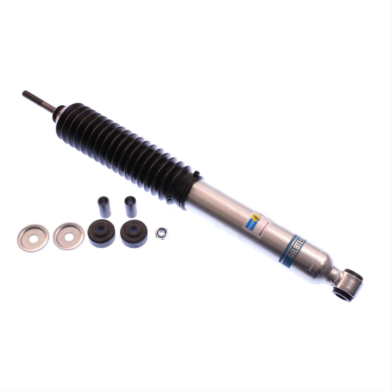

Rear Bilstein 5100 shocks from a early 90s ford ranger. P/N 24-185684, ASIN # B004WO9JK2
Bilstein 24-185684 Bilstein B8 5100 Series Shocks | Summit Racing
Free Shipping - Bilstein B8 5100 Series Shocks with qualifying orders of $109. Shop Shocks and Struts at Summit Racing.www.summitracing.com
With the spohn panhard you do not use the maxtrac relocation bracket, nor do you use the sway bar spacers in the kit. For the 5100 shocks you swap the maxtrac shock sleeves into them.

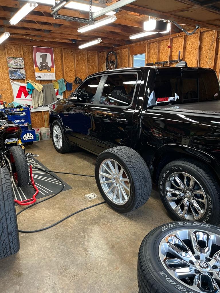

Wheels and tires-

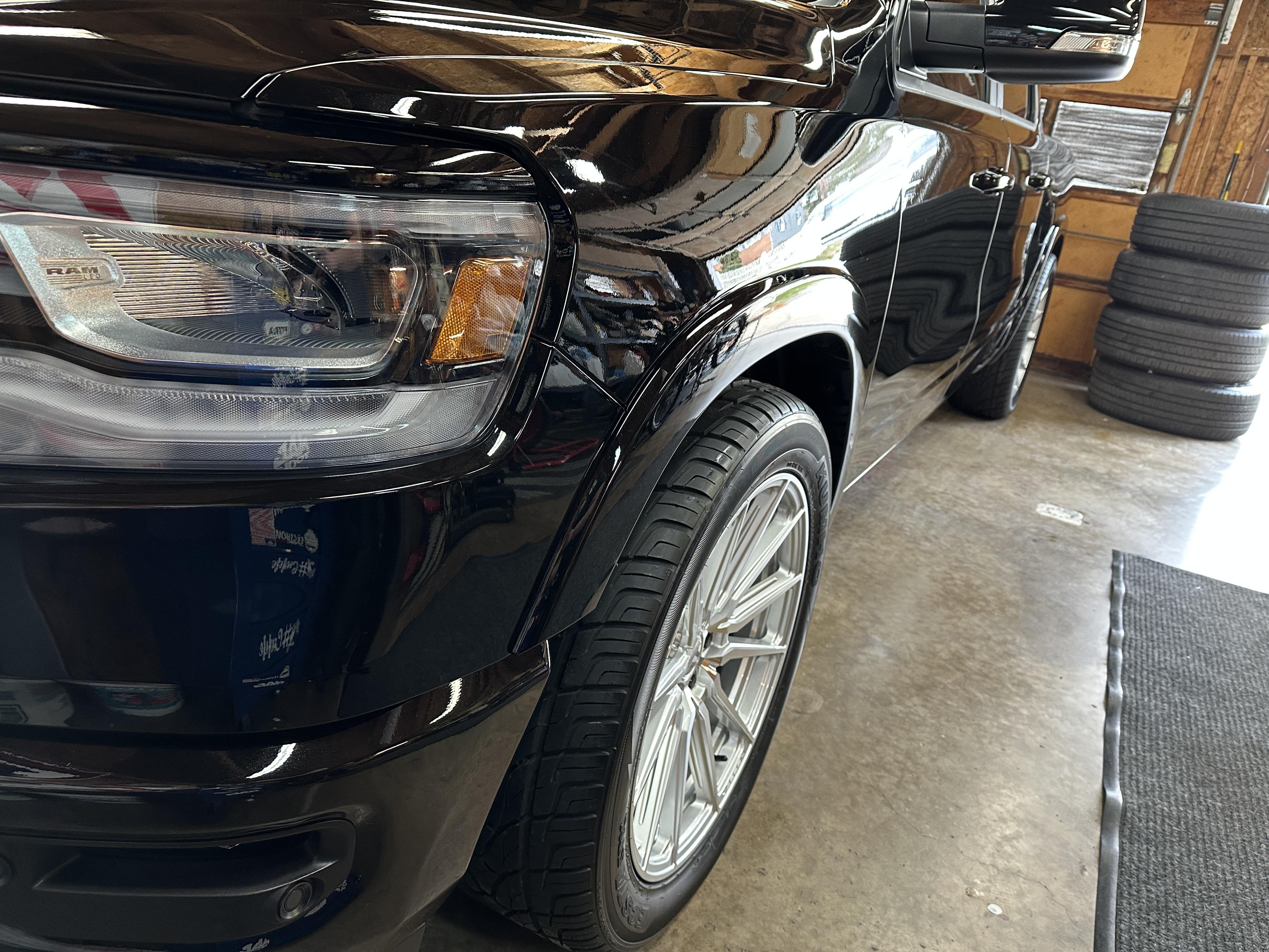

Vossen HF6-1 22x9.5 +20- P/N HF61-2G20 with their Vossen lugs in black
Vossen HF6-1 22x9.5 20 Silver | HF61-2G20 | Custom Offsets
These Vossen HF6-1 wheels feature a Silver finish and are sure to make your ride stand out! This particular wheel setup is in 22x9.5 with a 20 offset. The Vossen HF6-1 is a One Piece Alloy wheel that features exposed lugs. These beautiful 6 spoke wheels are available in a 6x5.5 configuration and...www.customwheeloffset.com

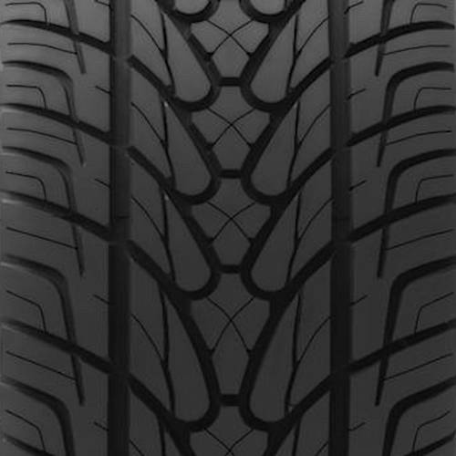

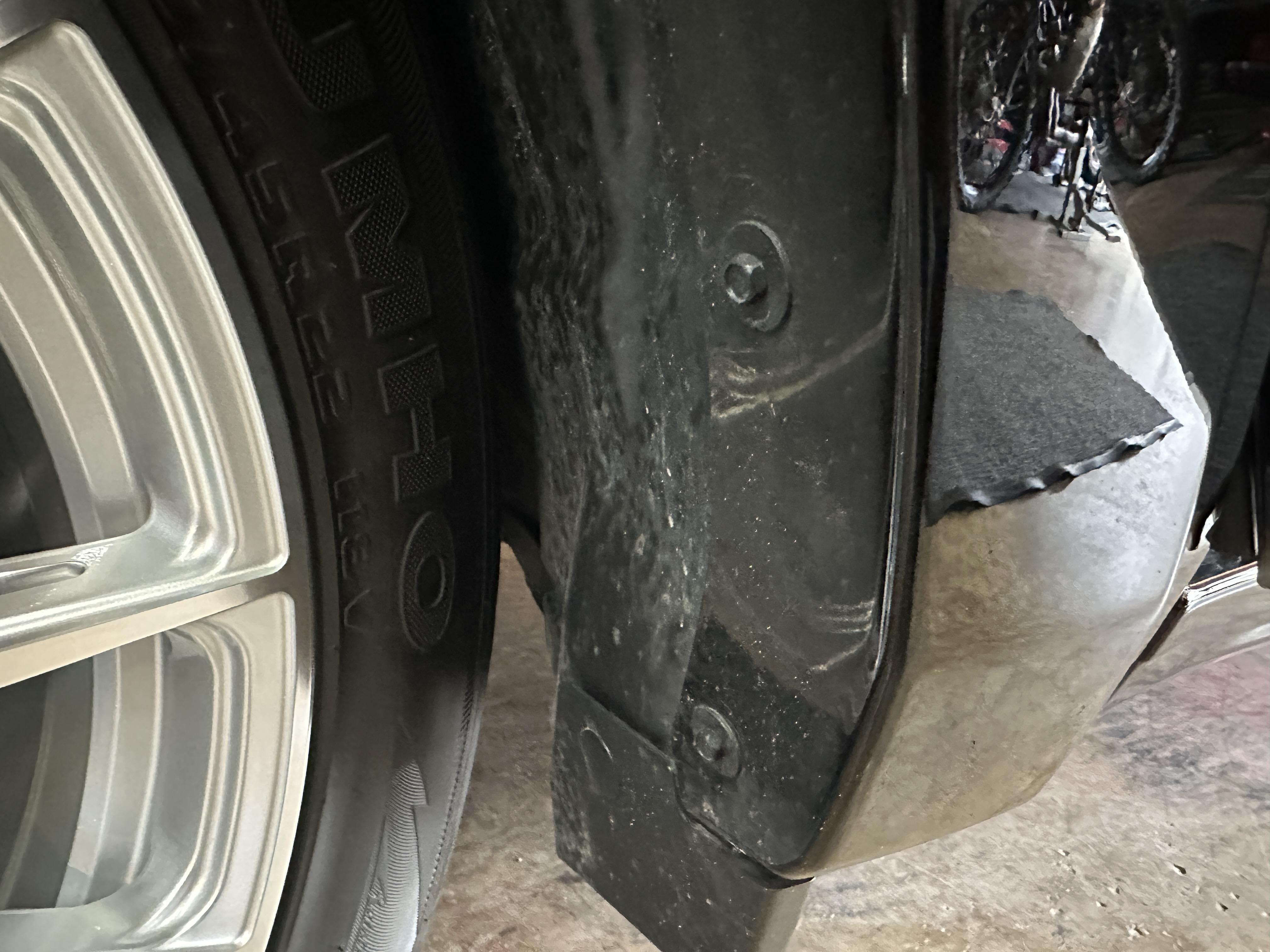

Kumho Ecsta STX KL12 305/45R22- P/N KUM-1649113
Kumho Ecsta STX KL12 305 45R22 (22.7x12R22) | KUM-1649113 | Custom Offsets
Drive with confidence with these Kumho Ecsta STX KL12 Performance tires. This specific set of tires comes in a 305/45R22 configuration with a V speed indexwww.customwheeloffset.com

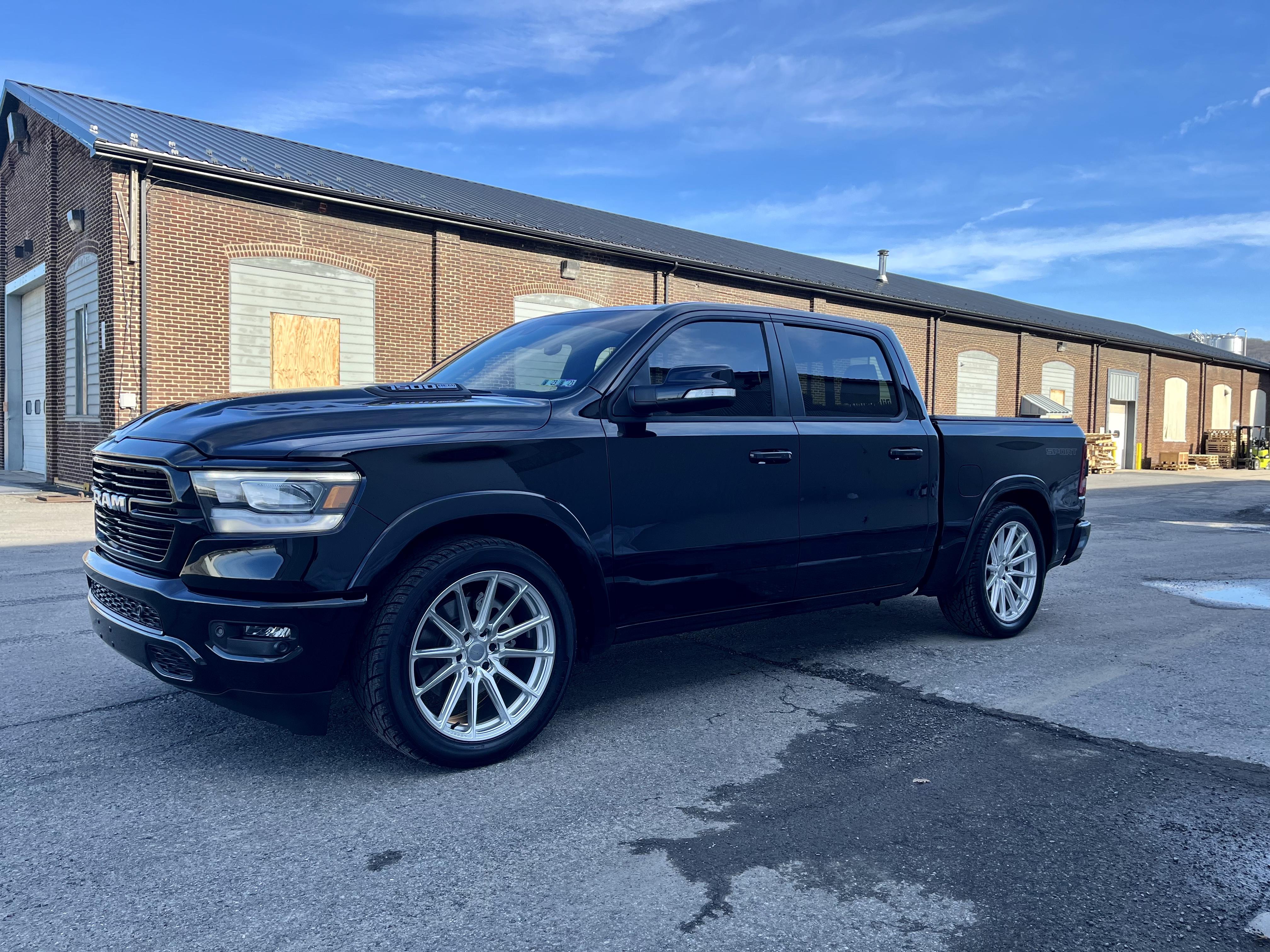

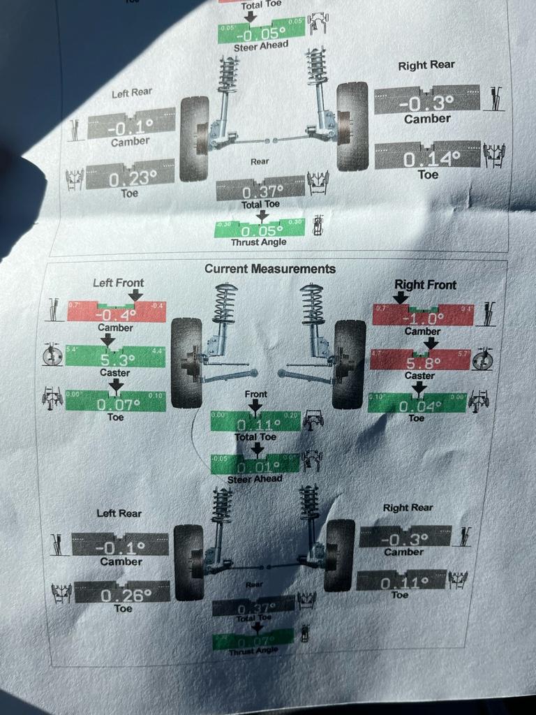

As my truck sits right now with the 2in drop springs in the rear, I'm at 36in F and 37in R. My plan is to set the front struts to 1.5in, which should give me close to to no rake, and help keep the front alignment in the green. And use the helper bags when I load the motorcycles in the bed. Since every 2/4in dropped truck ive seen still has rake.
So far im right around $5k for everything since I was able to find a few deals and discounts. Pictures and video to come as I start everything based on the weather and snow on the ground.
