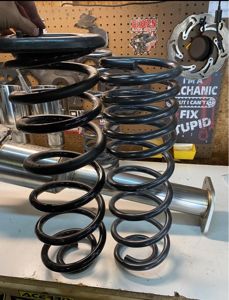

Thanks for posting such a clear picture. The coils do look completely different. That would worry me. Wire diameter is definitely different. Also, I can see the part number on the new coil. That is the part number for 2018 and older. I think the PN for the DT or 2019 and newer is a -19 (272920-19).
I don't think the oem coil can be modified. It has a tapered seat. It wouldn't sit right in the perch if I were to cut it. So that's out.

DOES anyone have a picture they can post of any OEM stock rear coil out of a 5th Gen 4WD Ram? I just want to see how it looks. Thanks!
I'll snap some pics of mine this weekend when I get them out. I'm going the IHC 3/5 kit for 4x4. I'll also snap pics of the rear drop/levelling springs my wife ordered for me that I chose not to install.

They are the same thing I already posted a pic of.
