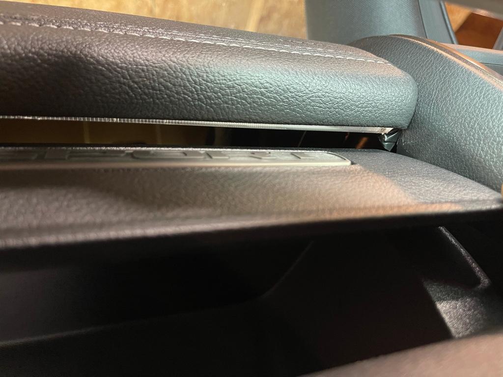

NIck, how do you install the glove box "tube" light? Do I need to remove the upper glove box? I read that it gets secured with a 5.5 MM screw, I don't see any screws in the vicinity of the mounting location.
You don't have to remove the glovebox. it will slide in. It is a PIA to get though. It will take a few times to get the angle just right so it won't pop out on you while you're putting it in. Once it's in it won't pop out on you though. :)

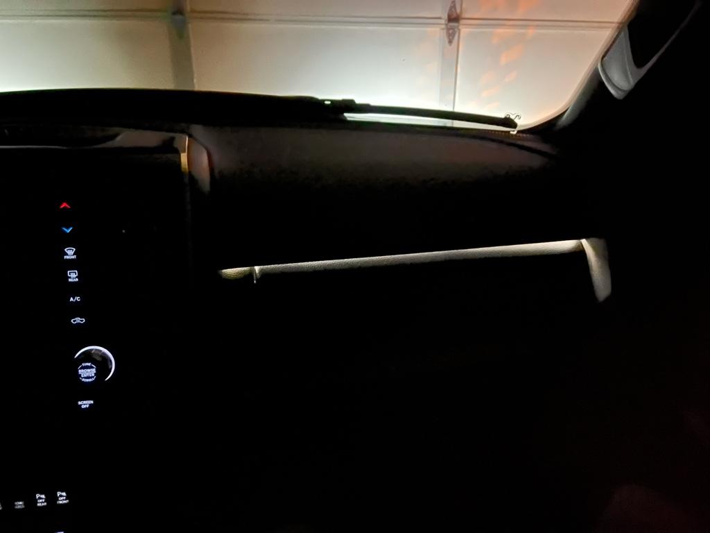

I added the ambient lighting to my truck and cannot get the glove box to light evenly. Tried rotating the tube and even covering the end of it. There’s a bright spot on the far right. Does anyone have a pic of a factory equipped one lit up?
I assume there is a channel it slides in? And the light gets bolted in? Or does in snap in?
I haven't done this mod, but it looks like the light isn't fully seated towards the end causing more light to show. Does it just pop in place?
It is seated into the clips/channel. It’s almost like the dash isn’t straight and has a slight curve.
I posted some before and after pictures earlier in the thread. This is seated correctly. :)
