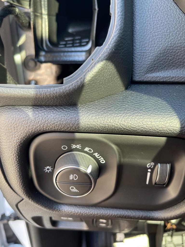

If I don’t have the second dial, is this the switch I need?
68156061AD
Anyone know if a truck that doesn’t have the second rotary switch even has the plugs? I looked this morning and don’t see them anywhere.
Doesnt look like you do. You can add the switch with the two rollers and the lights like I did. I programmed mine with alphaobd..

I used this harness 68340400AD clipped the connector thats different and hard wired it to the led light under the dash above the foot pedals. The harness has four connectors three of them are the same those three are for the lights they are plug and play the fourth one will have to be cut and spliced its just two wires.. The harness will fit perfectly it locates all the lights were they should go.. I did add the second wheel headlight switch and programmed it with alphaobd as well..

Ok you may need to find another connection my truck is a Lonestar level 2 so it had the ambient lights under the dash that stay on at night. I tied into them after I figured out I could change to the 2 wheel headlight switch pretty easily. I think it was 2 changes in alpha. I just searched ambient lights in alpha under the body controller and it popped up.

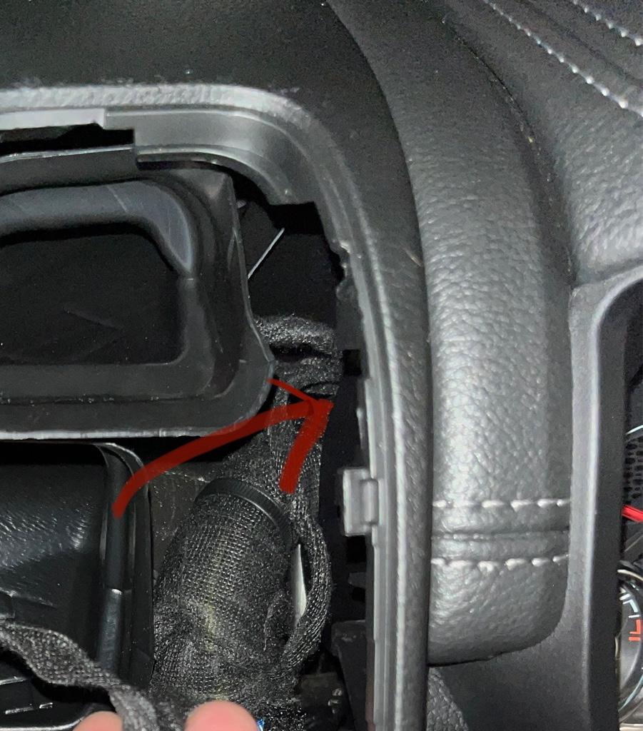

My harness ends were taped up in the main like the one you have pictured here. feel around inside the tape. It might actually be there. It was taped up on it tight. It didn't look like it was in there. Had to cut the tape back to get it out. (like a mummy) Not 100% sure yours will have them since your truck didn't come with the ambient lighting package. But it's worth another look. :)

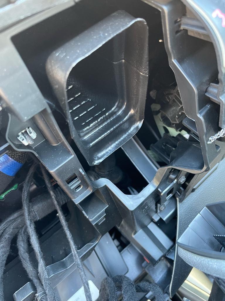

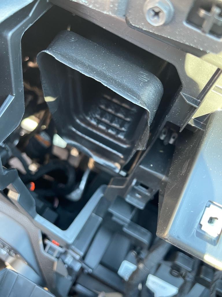

So I installed the missing ambient lights in the dash yesterday and wish I wouldn't have wasted my time. All the plugs were there but they were VERY well hidden. The left side one was a PIA to find. On mine it was taped to the main harness and completely wrapped up but it was in the part of the harness that is behind the instrument cluster and the wire was sandwiched between the dash and a brace. I had to remove the instrument cluster and a couple of screws behind the cluster in order to pull out the dash enough to free the wire after getting it cut out of where it was taped inside of the harness. The harness for the light above the glove box was actually taped inside of the main harness but down towards the floor. Unplugging the 8.4 was a pain because the antennae leads were not long enough to pull the unit out far enough to actually see behind it. You had to work blind to unplug them but once they were unplugged you could pull the unit out far enough to work comfortably on the rest of the connectors. The lighting itself is underwhelming.

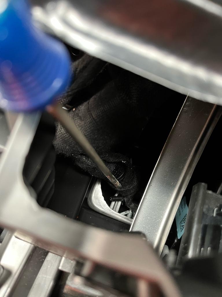

For others wanting to do this. Ram really hid the plugs on my 21
The left hand plug was located and taped behind the gauge cluster
The right hand plug was tapped to the main harness below the glovebox
The center one was oddly easy, and tapped to the start switch harness
