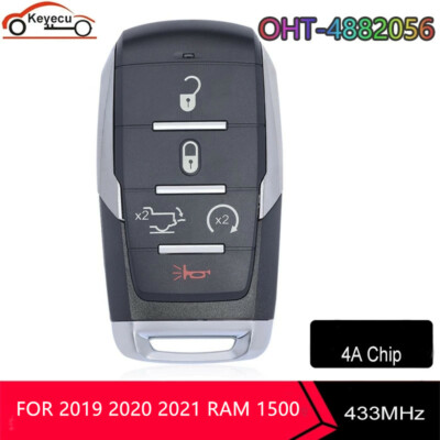

These are the fobs I use:
WHERE CAN I GET THE 6 BUTTON FOBIK?
