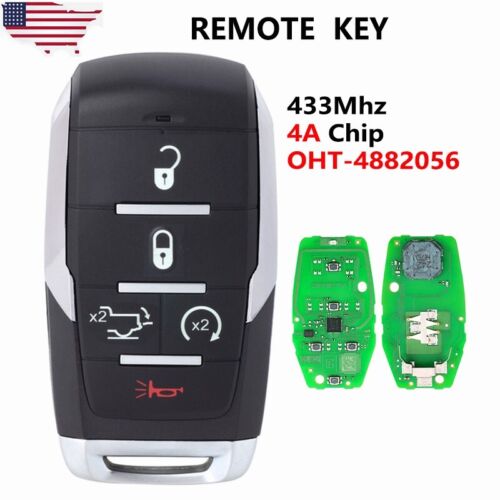

Verify the key that you were sent was for a 1500 and not a 2500. I had the same issue using an Autel KM100 key programmer. Turned out amazon had sent me keys for a 2500 which are different.
Went to ebay and bought 2 new 4 button fobs that listed the actual chip specs that matched my factory key and those programmed with out a single issue.

This should be the equivalent key for 1500 for the same seller I used for my 2500. Stop buying random Amazon crap. These are half the price anyway.
