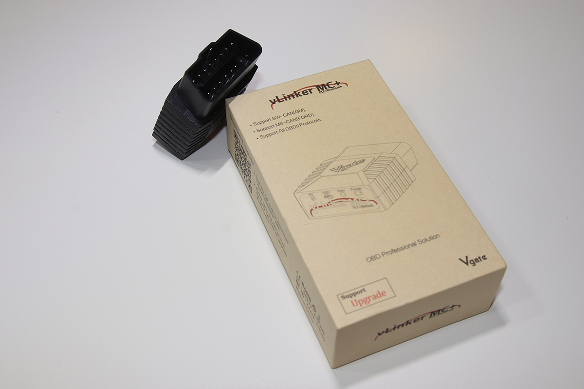

Well done, but you could have saved $100 by getting the vGate vLinker MC+ we've all been recommending for like over a year or so now.
Thanks, ordered June 10th, 2024 via Amazon. Lot of info on the topic over the years. The 3 sons absorb those costs in their inheritance. I'm sure other members will pick up on the info and appreciate the savings.

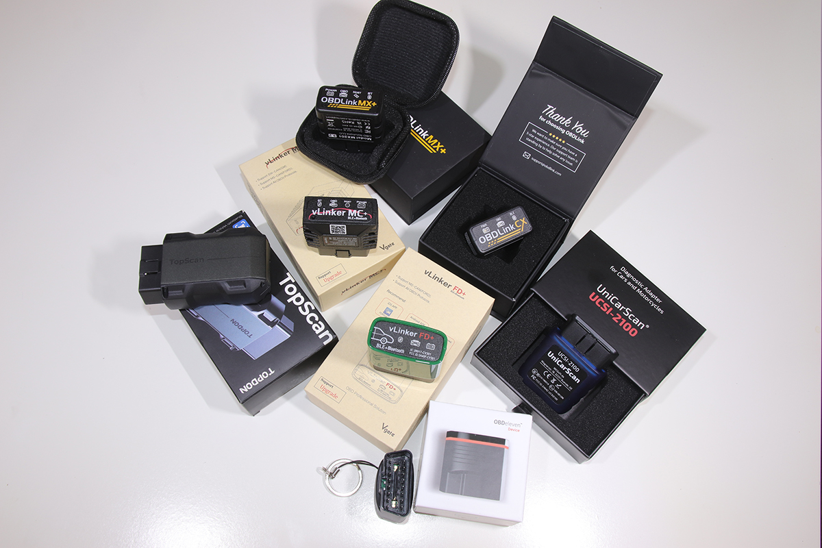

For those considering a purchase, some links and info.
