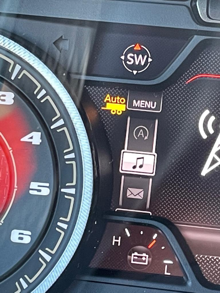

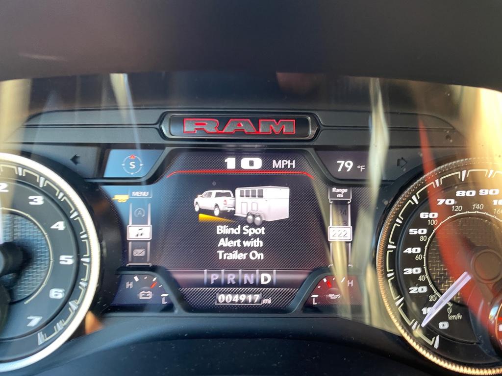

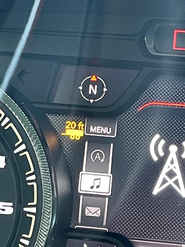

Ok so this was very cool to see happen. I’ve read stuff here about this but never looked into it cuz I don’t tow all that much anymore and just have a little 5x8 Utility trailer.
But the blind spot with trailer kicked on today and the within 2 turns had the right size for my trailer. Unexpected and super cool.

You have to be in tow mode for that to happen?
Do you have to have a trailer hooked up to see the setting in Uconnect? I don't have the trailer auto/max length option under my Blind Spot setting.
So that I actually don’t know. I don’t have a setting for that either. My blind spot setting just shows off, on lights and sound, on sound.
And I didn’t stop and look for settings when I had the trailer on. I’ll try to do that next time I hook it up. I’m curious too now.
