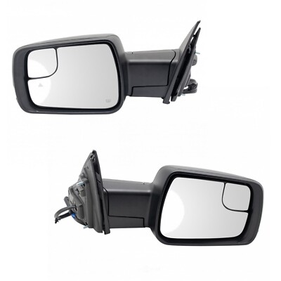

ok Gents... and particularly Jimmy07... finally bought my mirror glass. Funny thing tho, my truck came with mirrors that are heated and only the driver's side (and inside rearview) dims. so i needed to find the same set but with the little LED in the glass for the BSM. Instead of buying them separately i found a pair of brand new OEM ones (shockingly a tiny bit cheaper than separate ones) but in this set, the passenger mirror also dims... my original passenger mirror was only heated. I'm now trying to suss out the connectors and which is which for the features. This is what i think they are below... seem correct? (Edit: i had the heat and glass dime connectors backwards... this pic shows what they are)
And following up on this. Any of the guys who added these instead of going with the LED in the sail panel, did you just cut these connectors off and splice the wires to the mirror? or did you make it an unpluggable connection? or better yet, did anyone find these connectors anywheres?

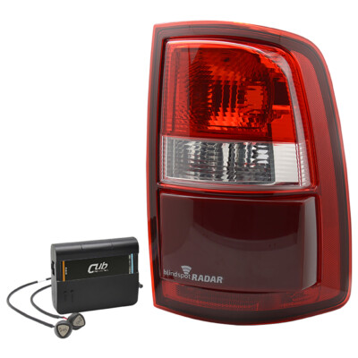

For anyone interested in knock-off mirrors, check out the TRQ mirrors. Part number is MRA09883. They go for $320 on eBay and are of similar/near identical quality to OEM. The puddle lights and turn signals are brighter than OEM and blindspot functions as it should. They are power-fold and have heated glass. I don’t think they have the auto-dim feature, though. Easy plug and play.

Wow, between these and the aftermarket tails if you don’t care about things saying “Ram” on them or the auto dim, you could get this whole mod done in a day with Jimmy07’s harness and the right sensors/heat sinks. And for just above the actual cost of the option. 😨
