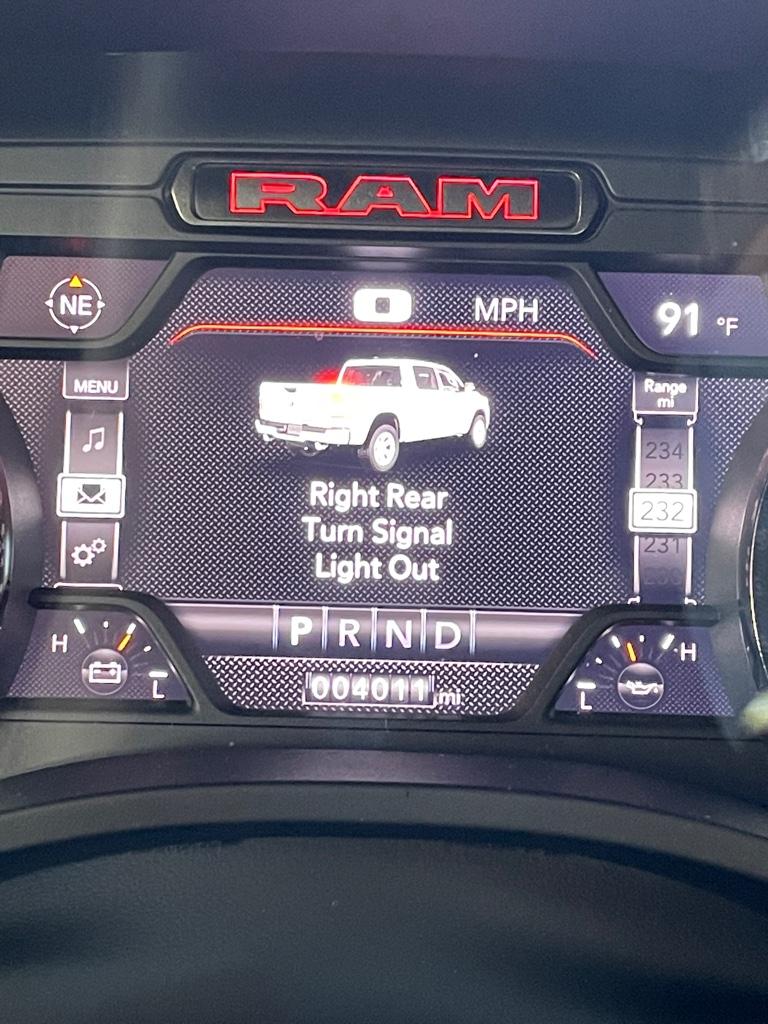

Check your wiring and also check that you didn’t cut one of the circuit boards in the tailight.Started it up and now i got this on the dash.
I haven’t tried yet, but am curious. I’ll let you know in 5 minutes thoughI guess now that I think about it, this light is junk anyway so I should actually try to fully open it and see if I can figure out what’s going on, anyone have any tips of separating the plastics on these??
I think the tail light might have some kind of adhesive on it in addition to the screws- if the screws are even to assist in holding the cover on. (Which I’m unsure of)
