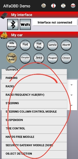

Which one of these do I go into for the ACC items.

I don't have all those options on my menu
I spent alot of time going through the whole list looking especially for:
ACC Adaptive Cruise Control: Not enabled
ACC/DASM Adaptive Cruise Control/Driver Assistance Module: Enabled
I think its under Veh Config 7 and then down in P/T Chassis Net
Did you upload your log to Google Drive? It's much easier to search in there...
I just use the search function in AlfaODB. I just typed in ACC and you get all the configs that have that in the name.
