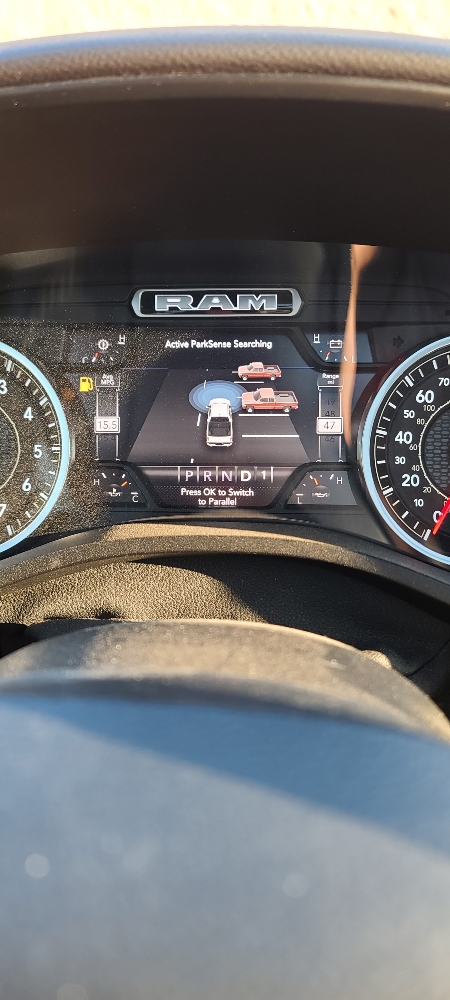

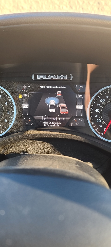

Installed the two new sensors for the rear and replaced the two in front. When I push the active park button, it just sits there saying sensing. Doesn't matter if it is in parallel mode or perpendicular mode. And yes, I was next to cars using it.
2020 Bighorn Night Edition, 5.7 Hemi w/eTorque
For reference

Changing the park assist tuning disables the sensors. The only settings that work are the two Base options. I tried both with no change. I also set the other to semi-auto.
It was the semi-auto park. I set it before, but it wasn't set, must have went back. But I tested both parallel and perpendicular and it works!
Great news--- glad all is well--- now onto the next mod ;)
