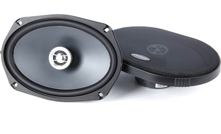

Anyone tried 2 ohm speakers in the doors? There are may out there but I found these. Not sure how much of an upgrade they would be over stock.
No distortion that I can hear. Brought the overall rich sound back to system. Thanks to the 8 ohm of the FaitalPro speakers
Thank you I’m ordering them for mine now. I’m sold lol. When I play songs from Apple CarPlay they distort bad. With the factory speakers
If you are worried about distortion make sure you get bass blockers. Some speakers come with them but the faital PROs do not.
