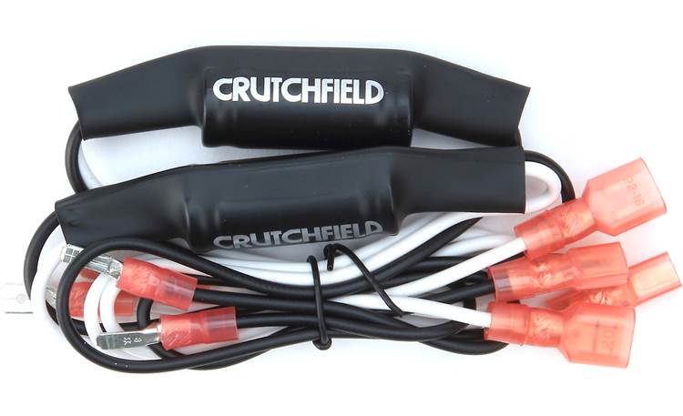

I am thinking of doing the same. Not familiar with bass blockers, I know their purpose but how are they installed? Harness, or splicing and I don't even know where or what I am looking for. Any help would be appreciated.
They go on the (+) lead between the connector and the speaker. Crutchfield sends you both wires already with connectors crimped on each end. Others just send the bass blocker and you have to splice it into the (+) wire.
A quick note - the Metra 72-7902 connectors are only for the dash speakers. The door speakers are Metra 72-6515.
Here are the Crutchfield ones I have (600Hz @ 4 ohm, 300Hz @ 8 ohm):

The Crutchfield ones are ready to go compared to the PAC ones which saves some splicing and possible sound quality issues (however slight).

I used the Crutchfield ones shown above (300 Hz @ 8 ohm). They simply plug in between the Metra adapter and the speaker with corresponding spade clips. One of mine had a bad solder and the wire fell off but I was able to repair it easy enough with a butt connector. I'm confident Crutchfield would have taken care of me no questions asked.
