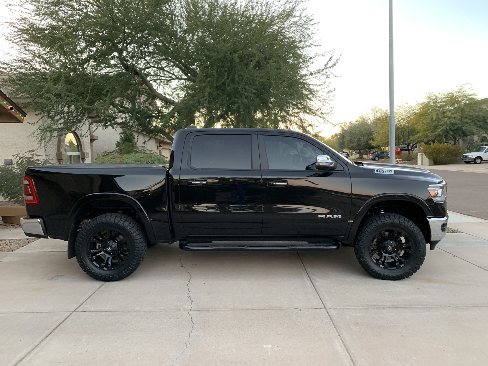

Finally I got the 2” Mopar Lift
Looks great! glad you got it all sorted out and you're happy with it!
Thank you for your help and everyone else who helped me with the info. The best help came from the service guy at a competing dealership. He gave me the spacer for free and told me to bring it back when it was done so he could check everything out. All for free just said he wanted to help me have the truck the way I wanted it. I now know where I'll be getting any Ram or Jeeps in the future.
It’s finally done. It looks great they put the mopar 2” lift on and then added an extra spacer up front. They did try to screw me again. They switched out my 295/65 and put on 295/60 but I’m not messed up about that. I’m just glad I got the lift done.View attachment 5465View attachment 5466
Which “ spacer “ did they use if you don’t mind me asking ?
For me my ride actually improved slightly. It’s more planted but again I did add a HellWig rear sway bar to the equation though.
So you put the spacer on with the Mopar lift to take out the rake that the Mopar lift still had right?
Yes that is what the service guy at another dealer said they have do on all their Mopar lifts.
Glad this worked out, and you found a dealer you like in the process. The truck looks great.
It rides the best too. The RC lift was noticeably stiffer.

i called another dealership which i should have gone to in the first place. Their guy said it rubs a little but what they do is put an extra 3/4 spacer in the front and it doesn't rub at all.

I ended up doing the Ready Lift 3.5 ( 3.5 up front and 2 in the back).
The front looks high, like something is messed up.
