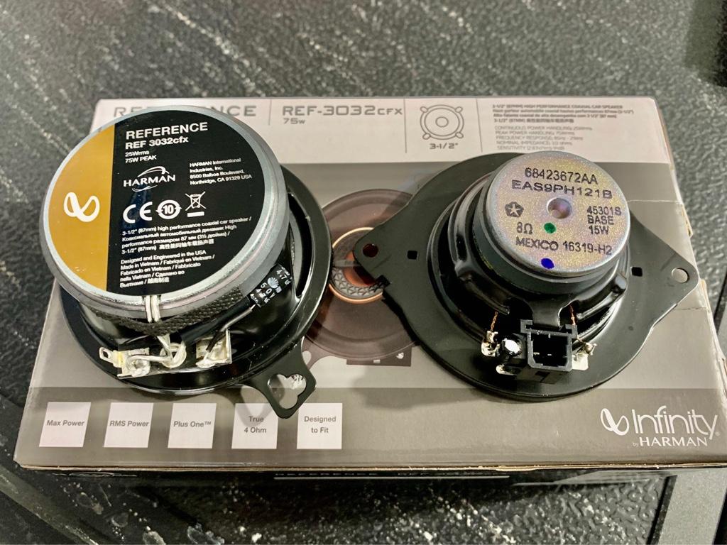

I've read that others have stated that the polarity of one or more speakers may be intentionally out of phase for the ANC (Active Noise Cancellation) system to work properly. I haven't done much research on this yet, but I was just trying to make sure I matched the polarity of the factory setup. As stated, my left and right dash speakers needed to have the polarity on the Metra adapter switched to make the Polarity Checker app pick up and match correctly. I thought for sure the center channel would need the same, but for some reason, it didn't.
