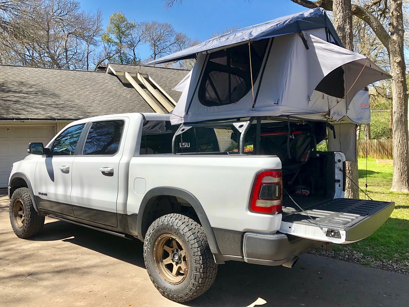

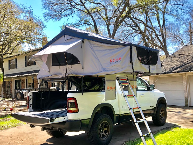

I've been working on the truck lately. 2.5" Motofab spacers with ReadyLift uppers, 18x9 wheels, 295/70 tires, Air Lift 5000 remote control air bag setup for the rear, some AMP Research steps, and since I'm heading to Big Bend State Park (West Texas) I've been focusing on getting the "overland" portion of the rig up to the task. First, here's a pic of the rig with the tent deployed:

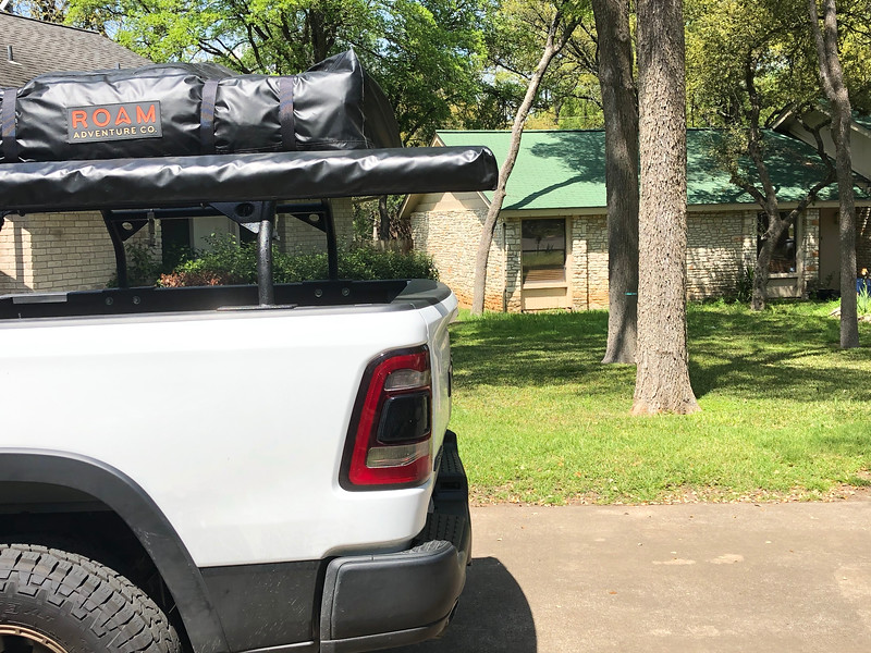

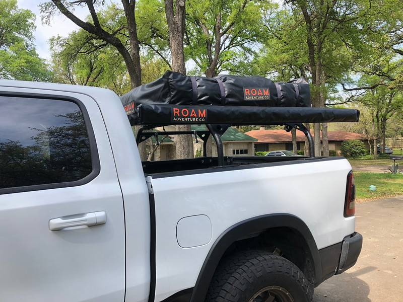

Then I came up with a way to easily mount my 6.5' awning. It's a bit too long as I originally bought it for my diesel (quad cab/short bed), but it doesn't stick out too far off the back and the extra shade will be appreciated by my pale skin!

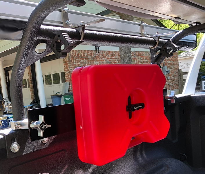

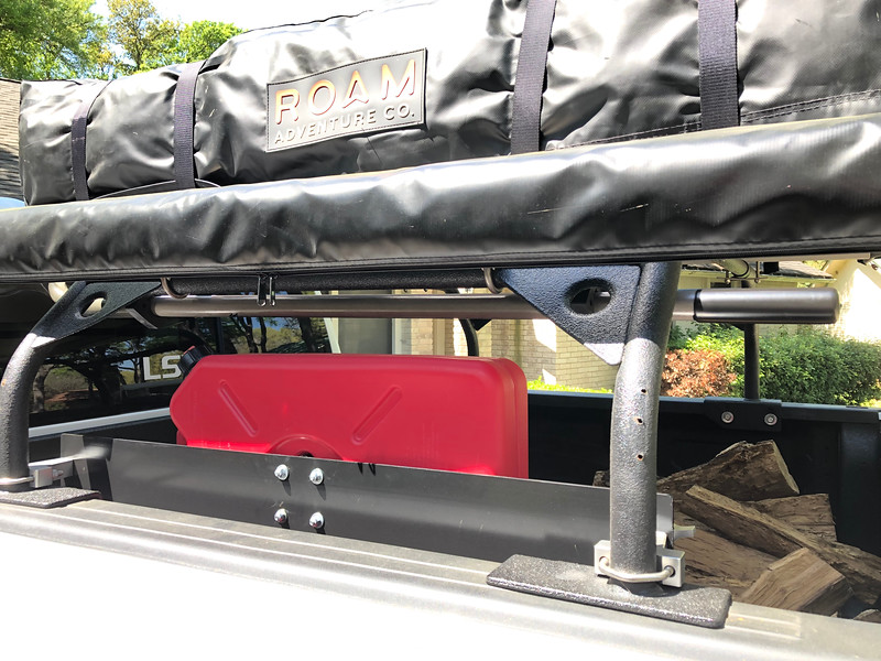

And because my truck gets absolutely atrocious fuel economy (thanks, Ram!) and because we'll be very remote and using a lot of 4-low, I decided I'd better pack a little extra fuel. I got a Rotopax "Fuel Pax" 3.5 gallon unit to try. Made a super simple bracket repurposing my Hi-Lift mounts and some 3/16" thick flat steel plate. This also shows how I used some muffler clamps to mount the awning to the rack. I've got some different Hi-Lift mounts coming on Friday and will install it before we head out.
Here's a view from the outside. I bought my rack used and it came with some rubber tool mounts so I figured, what the heck! I got a cheap shovel to toss in there.....just in case. :) I've got a jerry can and a shovel......am I overlanding correctly now?? LOL

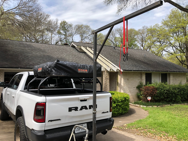

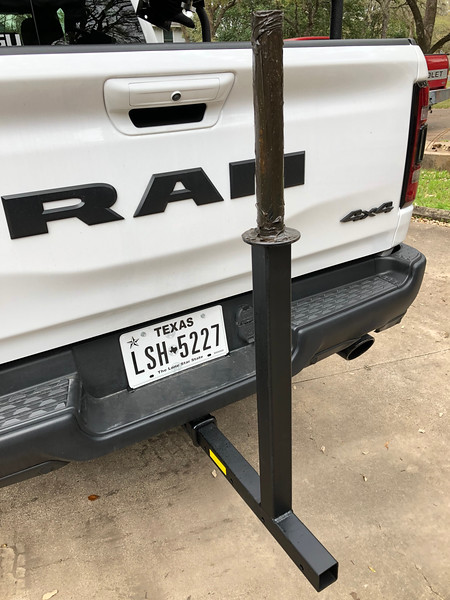

And now for something different.... I don't care to drive around with my tent/awning/etc. on my truck 24/7. I have several reasons for this, but removing it is not an easy task. The rack weighs about 50 lbs, I'm guessing. The tent is over 150 lbs. The awning is probably abother 30 lbs. So it's a lot for one person to manage. I also want a system to remove it relatively quickly. My goal is to remove it entirely and store it in my backyard within a 30 minute window. I wrestled with a ton of different ideas and finally starting coming up with something. The end goal is a hitch-mounted crane on a swivel and a winch. The crane will be multiple pieces for easy(ish) assembly and storage. Here's the base, some 2" square tube (1/8" wall). It's sleeved with some 1-1/4" sch 40 pipe (if I recall). I welded a large washer to it and slathered grease on it.
Then I drop these boom onto the round tubing. It also has a flat washer welded to the base to help everything rotate more smoothly.

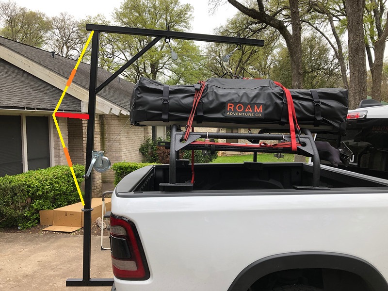

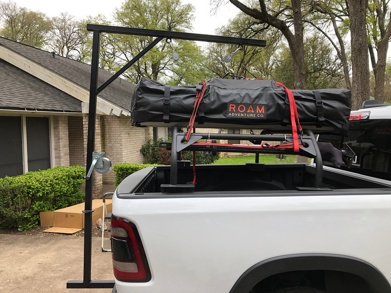

I added a winch, some pullies, and with some tie-downs wrapped around the assembly I tried lifting it. Unfortunately, there was too much flex in the assembly as you can see. However! It did start to lift the tent assembly so at a minimum I have proof of concept here.
Now I'm in the process of addressing some of the weak links in the design. I could go with heavier wall material, add a bunch of gussets, etc......but then this thing would be too heavy and it's already pretty tall and rather challenging! I'm in the process of experimenting with tension cables/straps and we'll see where this leads me. Below is the first phase of the next step, but it's on hold until I get back from my camping trip this weekend. :)
