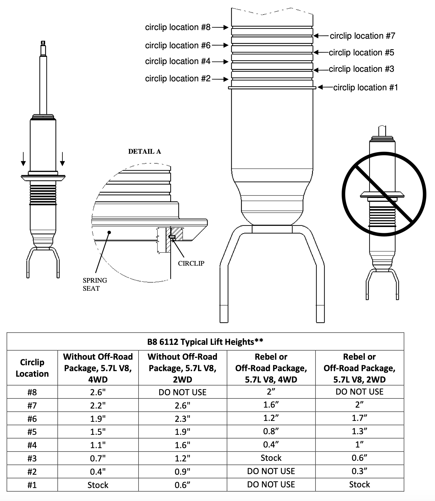

I’ve got a set of the RC UCA 3”-3.5” on the way to pair with my 6112’s @ clip #8. Anyone have a solid answer on what the 6112’s on clip #8 will actually lift the truck by?
ORP says 2” on clip #8 and STOCK @ clip #3 so if I’m correct clip #8 would be 2” of lift over stock making it a total of 3” of lift?
I’ve been staring at this all day, posted some questions. Didn’t really get any definitive answers. Another thread I was just looking at say guys have measured their ORP trucks and they gained 2” from factory ORP height which would be 3” taller then a non ORP truck which would mean the 3”-3.5” RC arms will work with the set up.
Yeah so the chart is confusing for us ORP guys. Basically since you are removing the ORP which is how the 1inch factory lift is achieved you are losing that 1inch.
if you put the 6112 maxed out on a non ORP truck you would gain somewhere between 2.75 and 3 inches of lift, If you have an ORP truck however you are only going to net a 2inch lift over what you are currently at stock because of using bilstein spring. but just so ORP owners don’t expect and additional 3 inches of lift, bilstein provides a chart.
so to summarize, lol. A non ORP will be raised roughly 3 inches from current stock height and an ORP truck will be raised roughly 2 inches over current stock height
those ucas will work for you.
