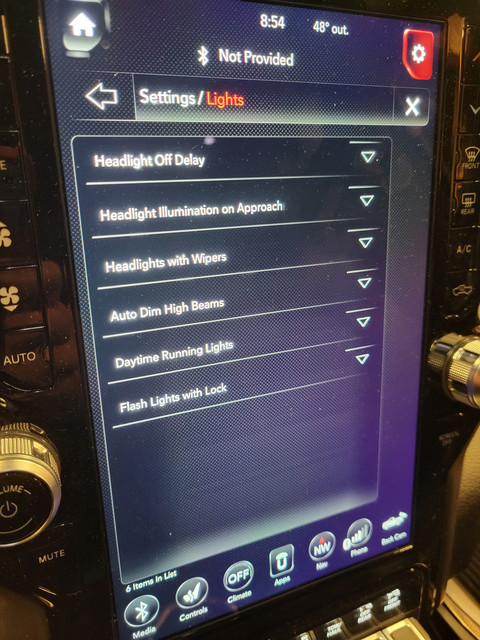

Well Ram Guru, Looking for some guidance. 2020 Ram Rebel tow mirror swap including door modules with all the bells and whistles other than camera. All works fine i.e. fold, memory, turn, heat, BSD. But for the life of me, I can't get Running lights or trailer spot lights to function. Using AlfaOBD and made the settings indicated in your post. any suggestions?
Do you have a menu item in the radio settings under lights (I think) to toggle on the rear guidance lights?
No menu item under lights. Confirmed it was enabled CustSetMenu 3: Rear Cargo Guidance Lights Enable/Disable CSM Present- YES.

Can you guys connect to the radio module (2017 radio navigator in the list) and perform reset ECU three times, waiting for the radio to reboot each time. Then see if you have the toggle for rear guidance in the radio settings. That green connector on the driver side mirror had 4 wires, correct?
Have two sets(color matching one), here's the harness. Four wires. I can also verify 4 wires on the signal marker if needed since I had mine off to swap to switchbacks. Attempted a total of 4 resets without luck. Strange that I don't have at least running lights. Thought those were a given on these dt trucks with tow mirrors once flipped on in settings?
yes 4 wire. connected to the Radio Module and performed the eco reset 3 times. still no joy.
It shows up under lights for others who have enabled it-
