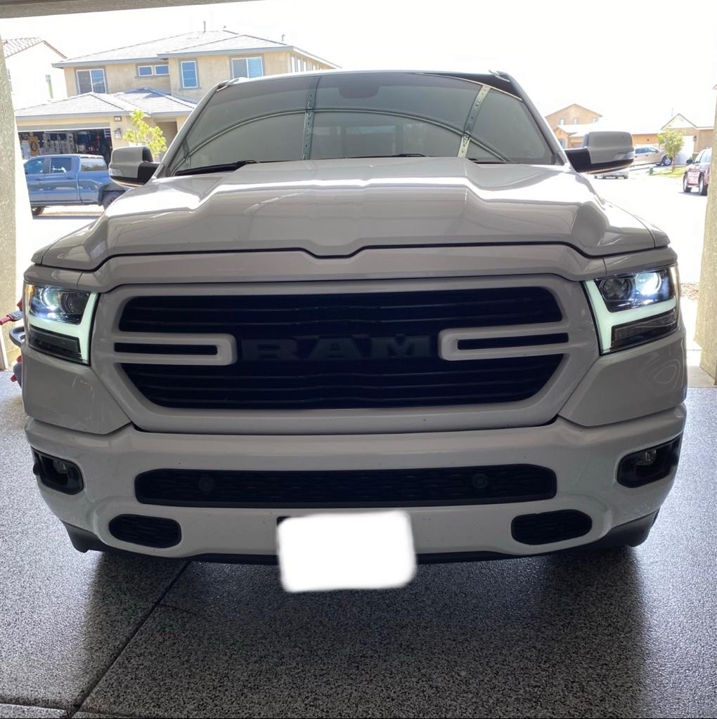

Not as bad as anticipated but the first time pulling that fascia is nerve wracking. Broke one of the clips the first time but the second piece coming off was much easier. Total time with a 1 year old and trying to figure out why the highs/lows wouldn’t work was a little over 2 hours. Definitely would be much less the next time. MoriMoto fogs will be here Monday as will my RC grille lights but now debating the grille lights
Looking great. By the way, do you need to get a converter with the led Morimoto Fogs?
Thanks, as far as I know, there isn’t a converter needed. They should be arriving today if UPS doesn’t lag so I will let you know. I went with Mori opposed to OEM because OEM would need to be programmed. Also Headlight Revolution has a video online of the fog install and they don’t mention a converter

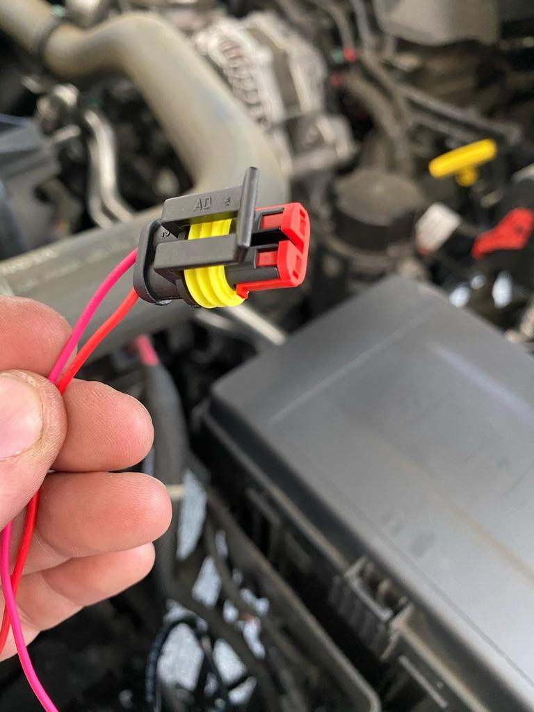

When I ordered the AlphaRex PRO-Series Headlights, I noticed that they did not have any installation instructions posted on there website. So I contacted the Tech Support at AlphaRex. They told me to use the F66 fuse. Which is valid for the 4thGenRams but not the 5thGenRams. After he told me that he did not know which fuse to tap, he said that I could wire it to any 10 Amp - 20 Amp fuse that would come on with the starter.
When I saw that the fuse that was on the pigtail for the DRL's was a 15 AMP fuse I went with a 15-20 Amp fuse. I tested the fuse box with my Multi-Meter to figure out which one I could use that would only turn on when the truck was running. Most of the fuses had power all of the time. The only one that I could find was a F60 Fuse : ECM / PCM / ACT Short Running Valve.
Since this is a critical fuse I decided to use a fuse tap so that the tap was clean.
Our trucks use the Micro 2 Fuse

F66 is a valid fuse, it’s under the steering wheel but it’s not a fuse to a major component like how F60 is. F66 is for “Accessories” like the DRLs.
When I ran my fuse tap to F60 my truck would start and shut right off twice. I moved it from F60 and truck ran fine. I made sure in UConnect settings to enable DLR. I believe I ran my fuse tap to F38 since that’s what everyone said in the thread but haven’t seen my lights to ensure the DRL works
I did not want to go through the firewall for this installation ,wanted to keep all of the wires in the engine bay.
I agree that the F60 is critical and believe me was the only used as a last resort. That is why I used the fuse tap so that the install was clean.
(Also wanted to match the amperage, you can step the amps down but not up.)

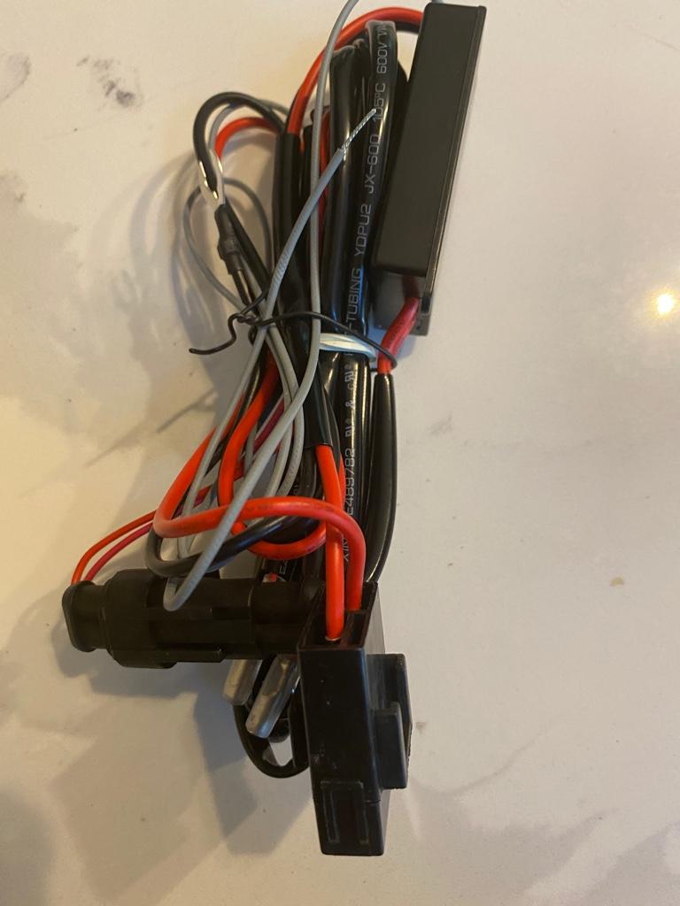

Mine just got in. Let you know how it goes hopefully install them Sunday I didn’t get any instructions on the wiring though.
No instructions for the wiring with mine either. Once you stretch it out, it's pretty easy. One lead to the lower white wire on each light, the red and black to battery and the grey to your fuse tap. As a note, if you plan to go with LED's, I suggest you do that before installing the lights. Much easier and if you drop the LED inside the housing, most likely you will have to remove the light again to fish it out, ask me how I know that. LOL
