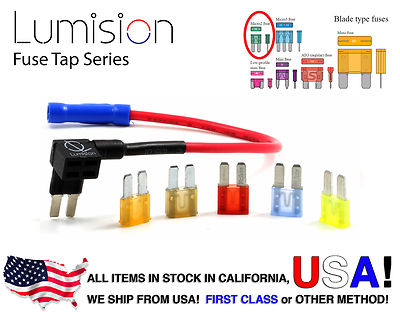

Where are you all finding the micro2? No one has it local all I have now is online
